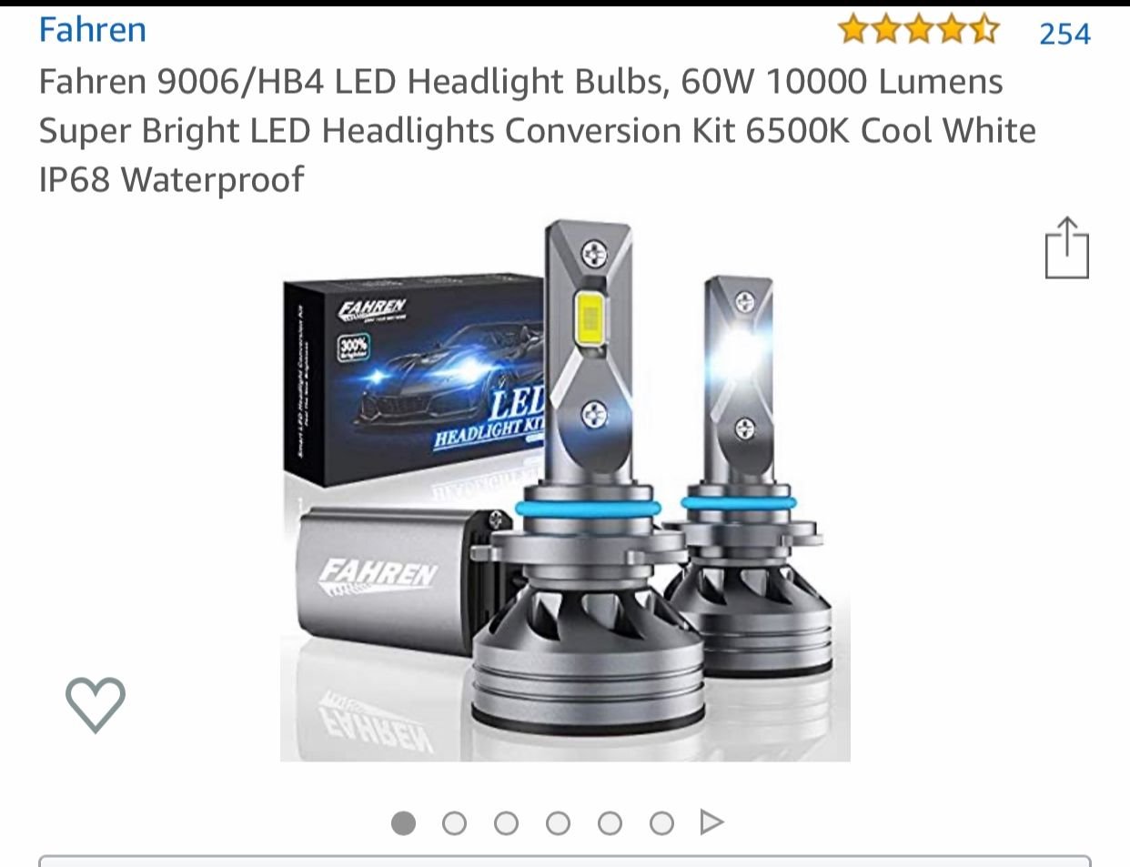

Speedy007, what is the brand name of the light replacement with this issue.

Had both 9005 & 9006 as you can see they come with a ballast and advertise all in 1 ! They also say if there’s a issue you could contact them direct for different error cancellations if you had a issue ! I chose to send them back as I was saying above the lights worked but would not open nor close without cinci’s fix or check out my thread there’s others ways to make it work ! Lights were ace in quality just that one issue ! Good luck I would guess most led these days are similar quality !
