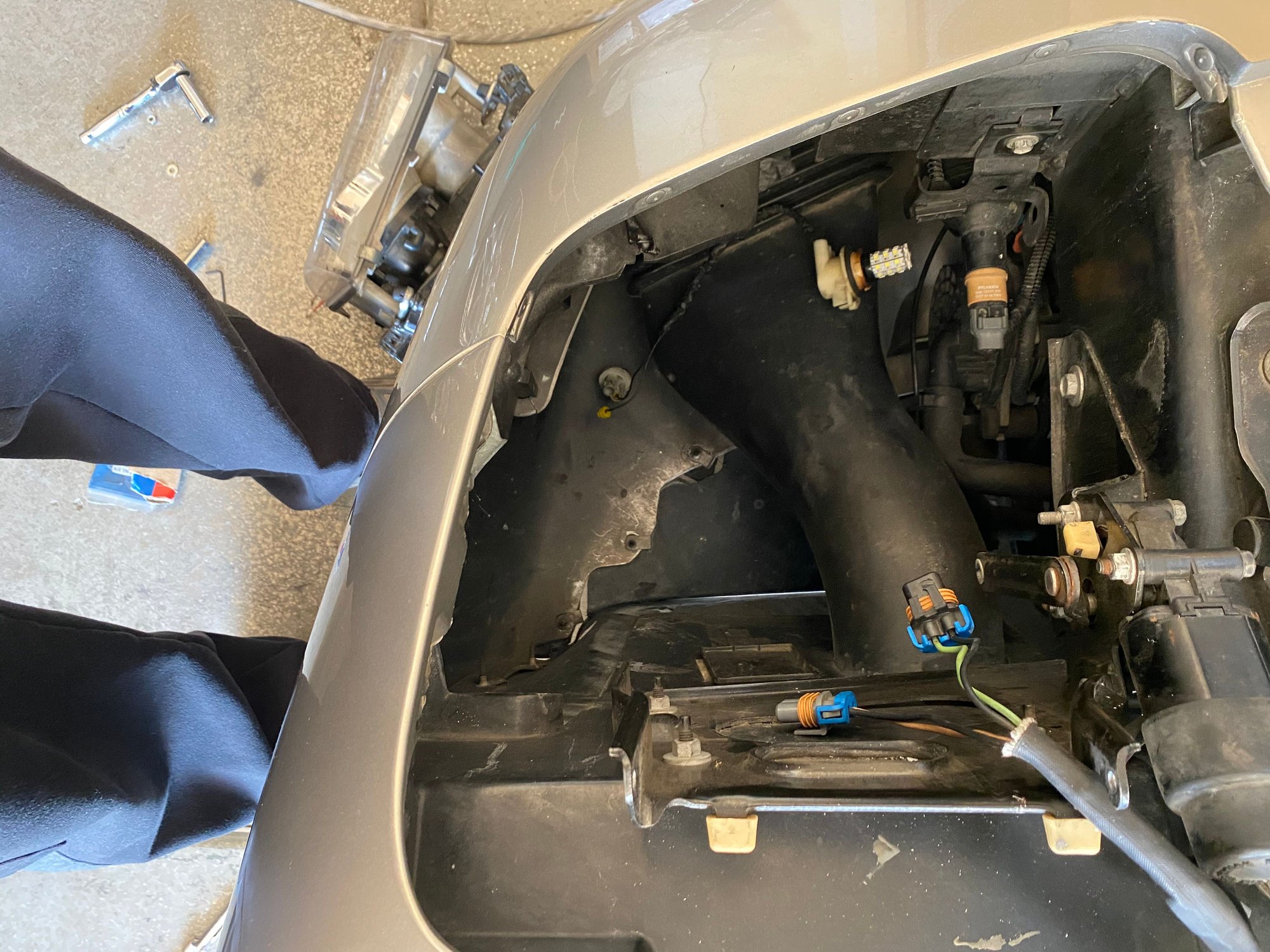

Some tips:
1) Remove the panel pointed to by the orange arrow. Makes things alot easier when you have to reach from the bottom.
2) The driver side has a plastic push pin with a hole, on a mirror image of where the green circle is. Because the driver side has the hole here and passenger doesn't, that's the only hole you're supposed to drill. I didn't drill a hole, I fastened my lights with 3 out of 4 brackets that come with it, and it is sturdy enough for me. No permanent mods to the car.
3) The red circles denote all the bolts you'll take out with the factory heavy L bracket. 3 of 6 bolts will be used by the brackets in the kit. Plug the unused holes with the factory bolts so water doesn't get in.
4) Remove the whole lighting module on the driver side. It's not needed and it caused my LED's to act strange when I was mocking things up. It's recommended anyways because its easy, and isn't needed anymore. I put grease in the harness connectors left over and liberally wrapped them with my favorite 3M Super 33+ electrical tape to keep water out, and put them aside. Looks factory.
5) They will NOT fit perfect. You'll probably have to ream out the holes on the metal brackets included with the headlights, to get enough motion to center them correctly. A step drill works perfectly for this.
I bought the Depo brand, they are very high quality, unlike other brands, and actually come with a DOT-compliance credit card looking card, with a unique serial number stamped onto it.
If you have any questions, PM me and I can maybe assist you over-the-phone.

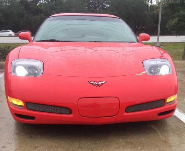

And I'll just get this out of the way:
1) They are lighter than the factory headlights
2) They focus light with the projectors and have a beautiful cut-off, rather than scattering them with reflector housings.
3) They are more aerodynamic at night and were used by the C5R team at Lemans and many other races
Any visual opinions are subjective but I think they look great

I have removed all components for the old lights and set aside my 13mm and 10’s ! Waiting on parts for now!
Lights internals are cannon style euro spec halogen projectors !

My Depos came with halogen H7s. I went through a couple brands of LEDs to find out which heat sinks were small enough to fit behind the rubber dust caps without actually touching them. I ended up with Sylvania "Fog" Light LEDs but they are still way brighter than stock.
