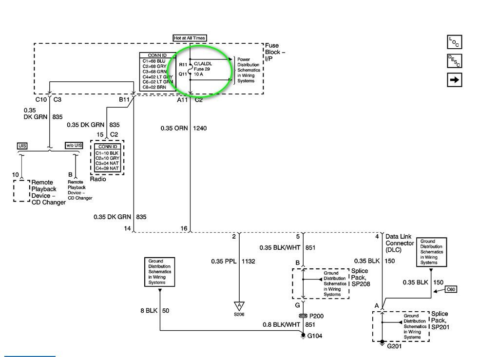

If you have 'No Comm" when hooking up your scan tool you may have issues with your serial data line...if you know where the 2 splice packs (Star Connectors) are to the left of the BCM pull the bus bar (shown in pic)off the top of the one with 4 wires and see if you can now communicate...if still no good pull the other bus bar off the top of the other one with 9 wires I believe...see if you can now communicate !!

Check your fuse 29 and see if it's ok
simplest an in most cases the problem when its not working

Fuse 29 was OK. Boxes were dry.

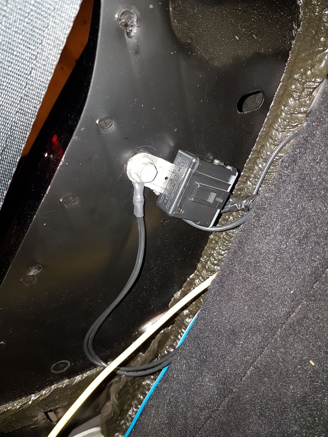

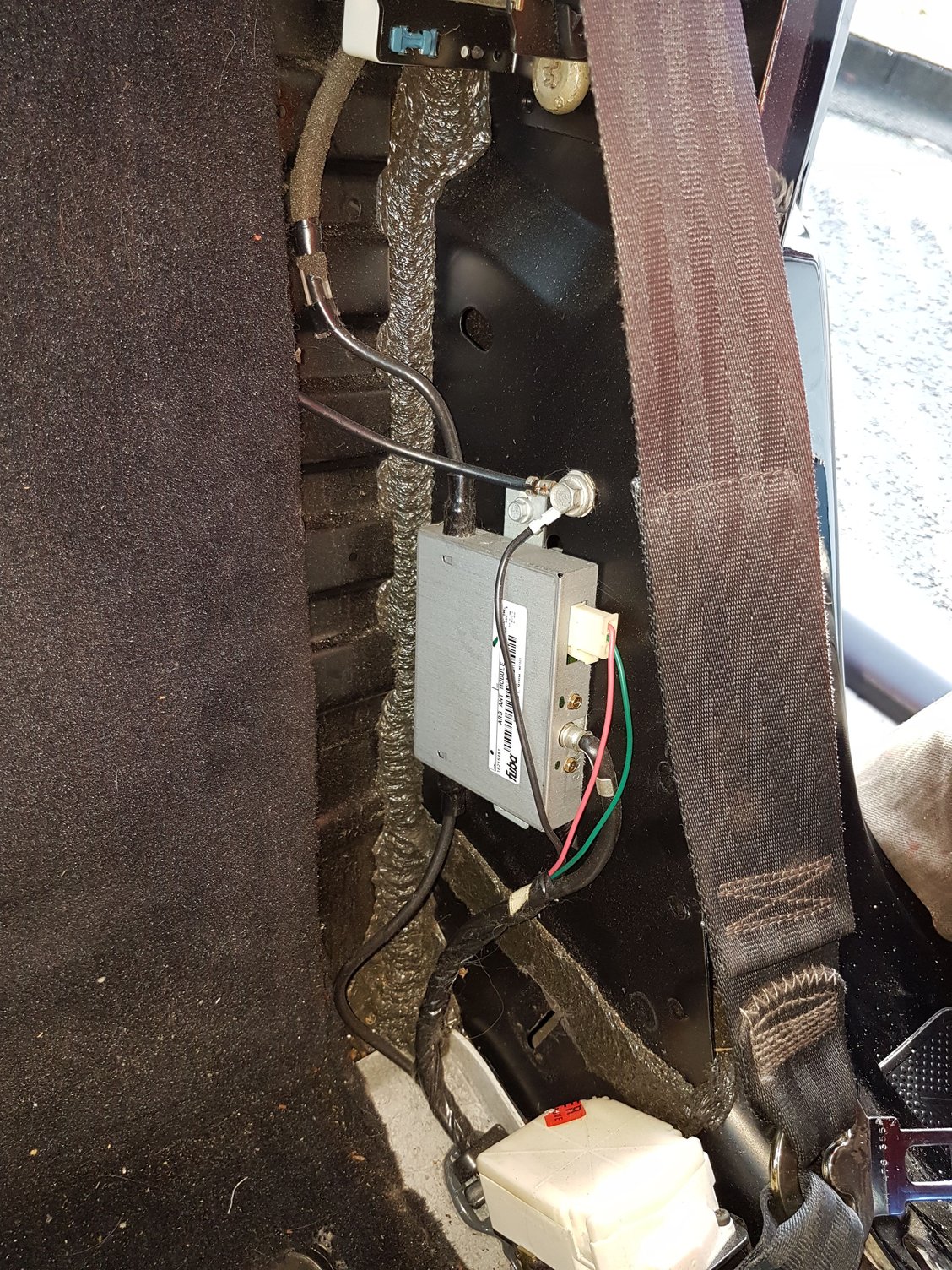

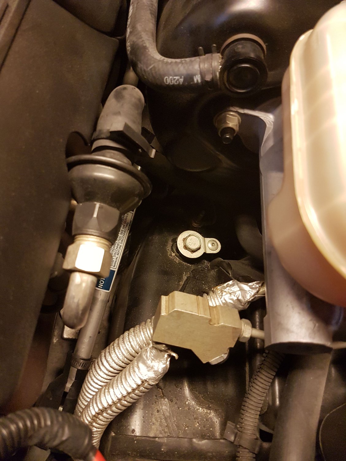

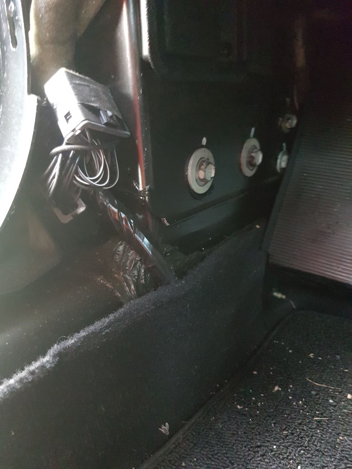

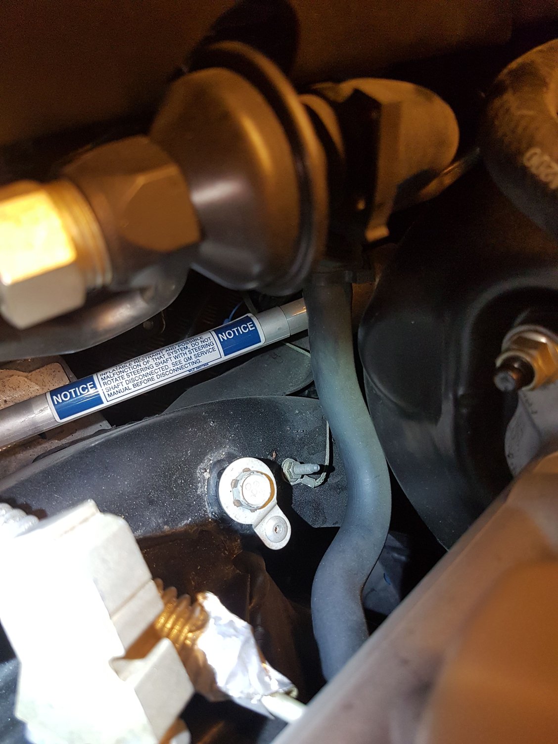

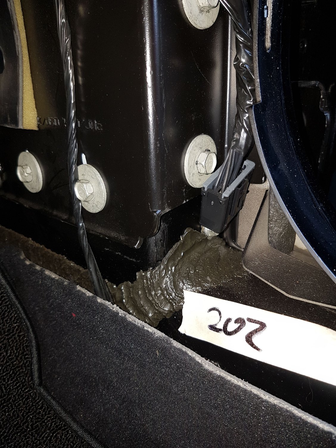

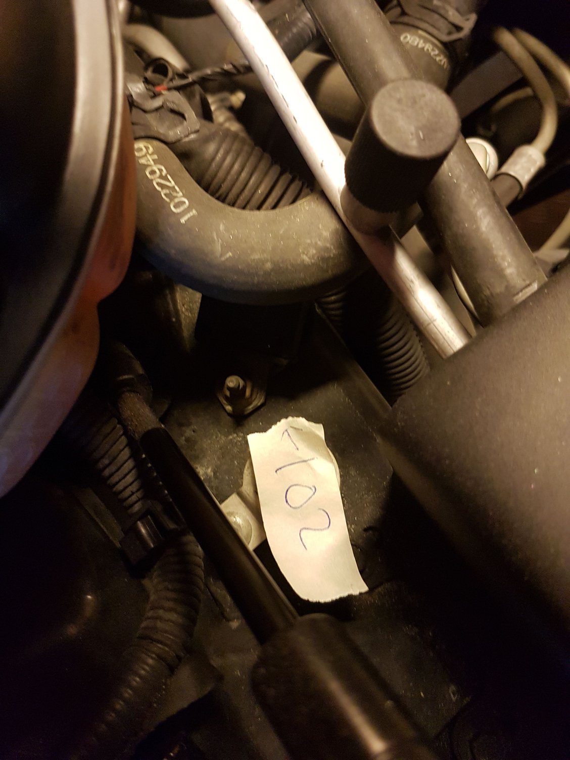

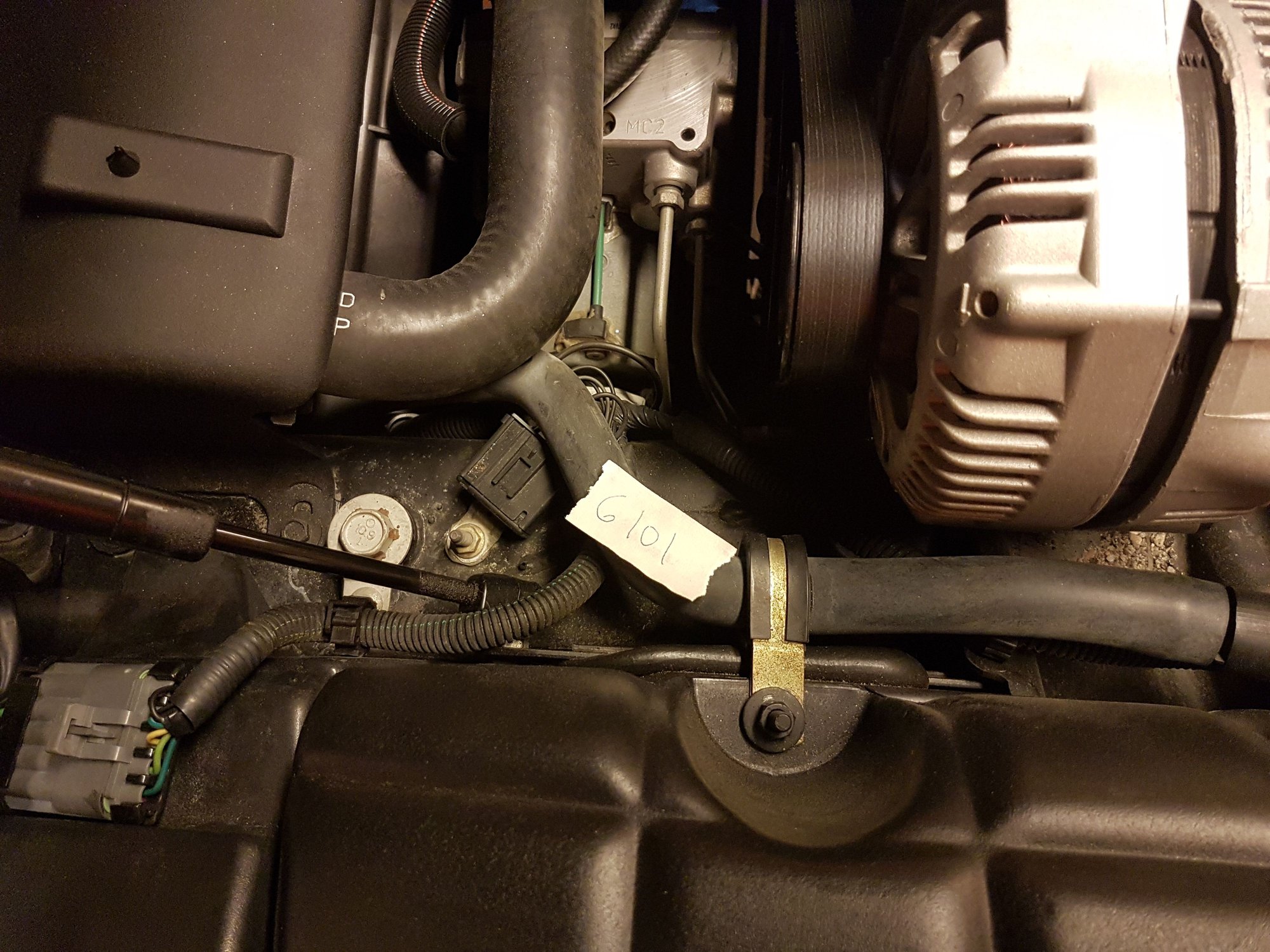

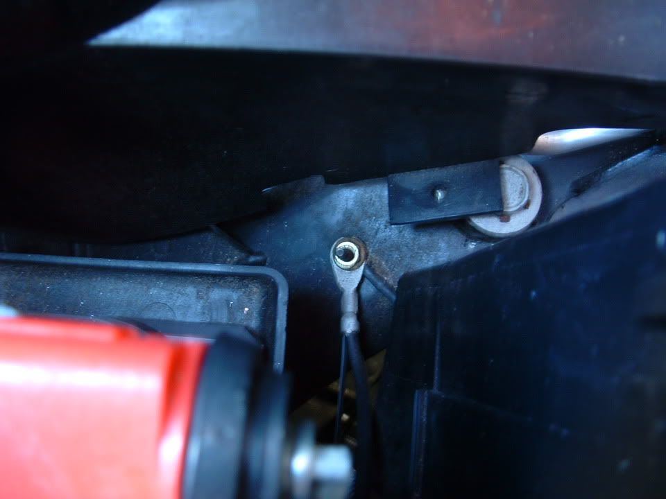

Hope this collection of of images can be of any help
G101
G102
G103
G104
G105
G106
G201
G202
G301
G302
G401

Awesome...thanks so much! I will check those out as soon as it stops raining!

some more info for you this should help you out to
click me for gound info

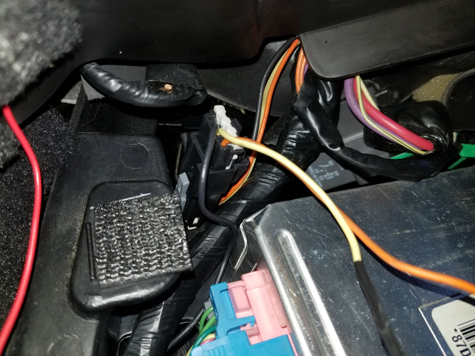

Also...what is this plug above the DIC for? A PO tapped into the yellow power wire (I think it was to hard wire to the cigarette lighter USB charger, because it goes into the center console), and the orange wire is not connected to anything.
Hard to tell where you're at in the picture...Is that the BCM in that pic ??...I can tell by the 87D number... I will look at that connector when I get home...so the connector has 3 wires ??...orange, yellow and black ??...is that black tape on the yellow wire a butt joint and does it change color ??...looking at wiring it looks like the radio circuits have a lot of orange wires. It is OK to pull both combs out but I don't see how everything is going crazy now....all the modules should be isolated from the data line...is the fuel gauge is going to E and the water temp is maxed out along with the DIC warning ???...when you start splicing into the radio circuit you can run into a lot of electrical issues ...try pulling fuses 5 (radio/cd), 28 (bose) and 24(radio/ant) and see what happens...even try pulling that connector shown in your pic and see what happens too !!...is there an aftermarket radio installed ???
p.s. If you have a multimeter probe all of the wires on the Star Connectors with the combs removed and see if you are showing 12 volts on any of them with key on...the radio data wire is on Star Connector 1 is colored ORANGE BTW...LOL !!!
Those 3 wires are taped or stowed...yellow wire is hot with ignition switch and orange is hot at all times...it is listed as C206 !!...looks like orange wire feeds the cigar lighter.
