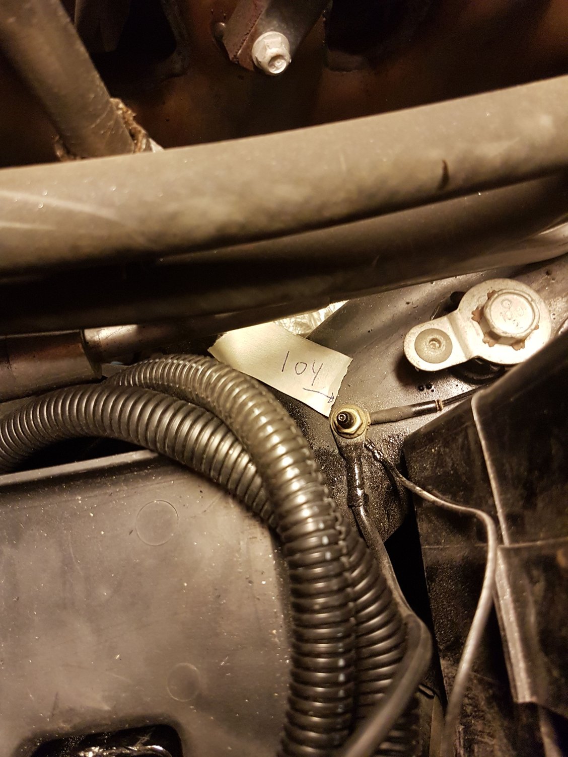

I don't have a picture of SP208 , Rob , only the G104 .

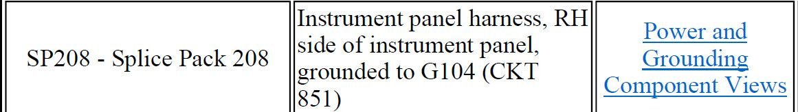

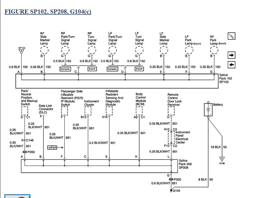

Found this "The ground for the BCM goes through a SPLICE PACK (SP-208). Its located on the engine compartment fire wall on the main wiring harness behind the battery."
Thanks O !!...if G104 was corroded the OP would have issues on everything on that splice pack...the comb will have to be removed and inspected...SP208 should be on the inside of the car...all 1XX SP's are in the engine compartment !!...I also see Pin 5 (chassis ground) of the DLC is located on that splice pack too.
