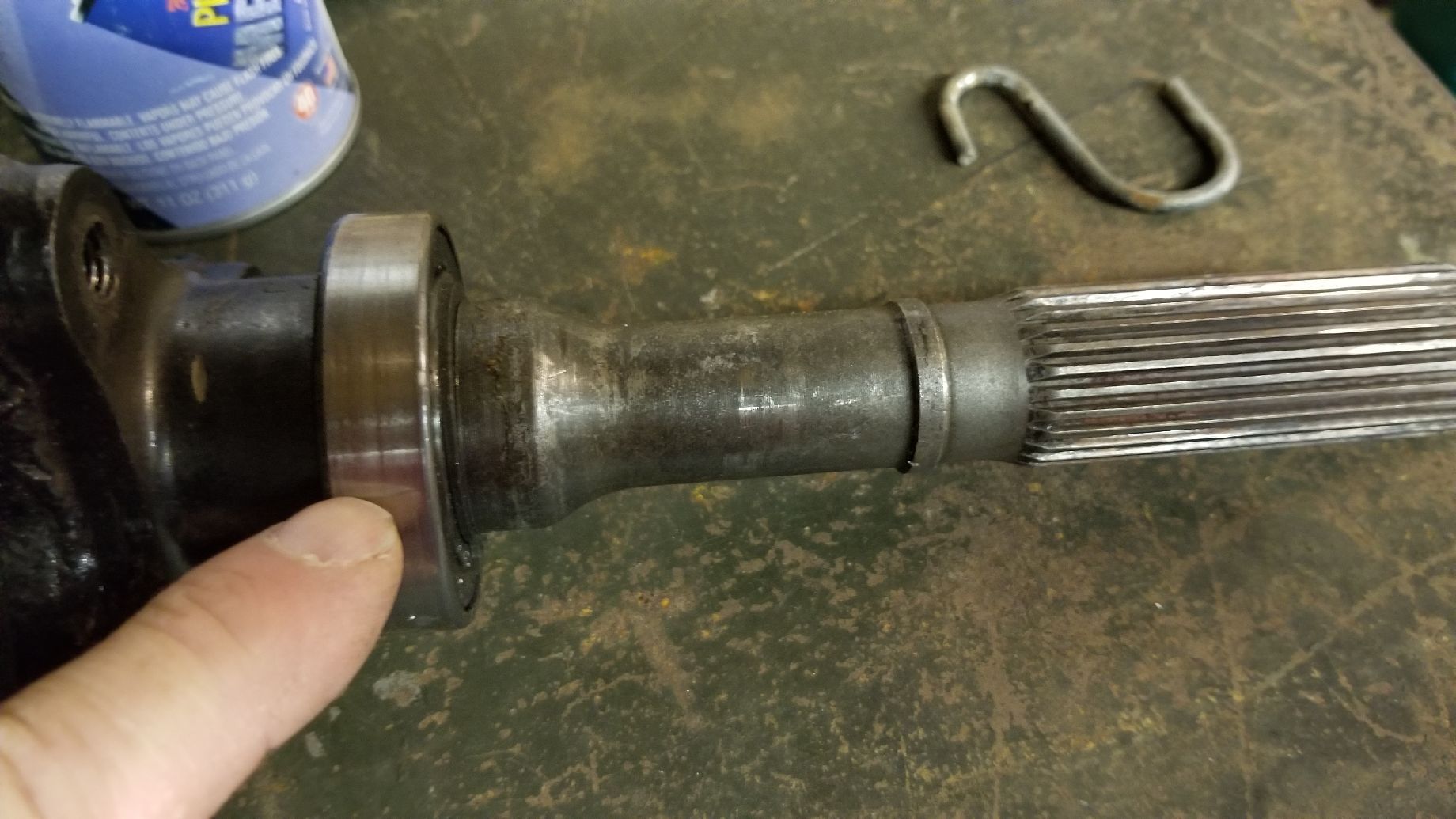

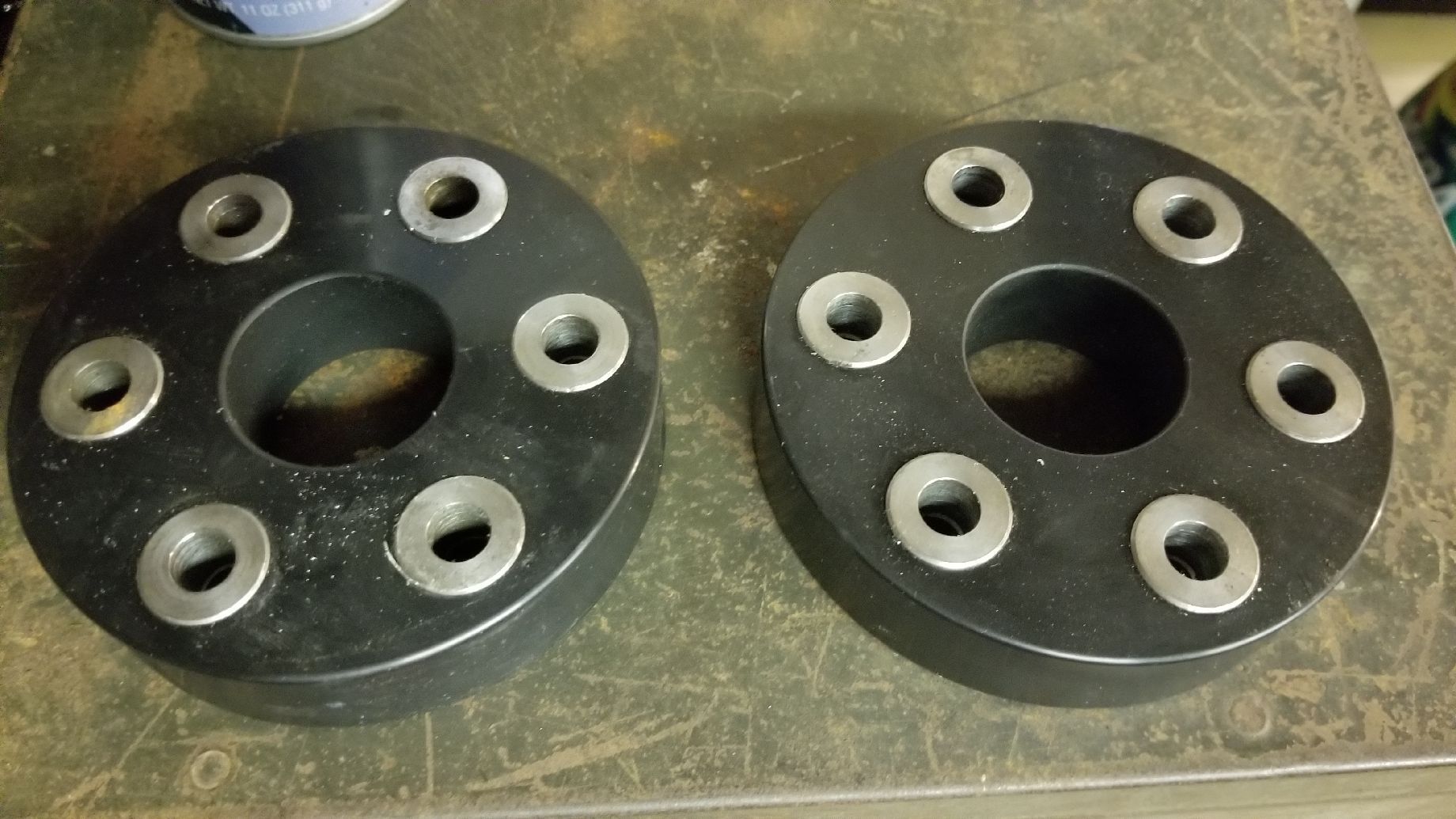

I wouldn't put the stock DS back in go aftermarket.The only problem with the ZR1 couplers is they are thicker and the bearing on the spline shaft will stick out some,So you would probably need a custom DS made,You would have to put them on your stock DS install it and take measurements,or you can go with the DSS couplers same thickness as stock,Those will eventually wear out with that much HP,Mine did after a few years.Pics of DSS couplers and bearing on spline shaft.
