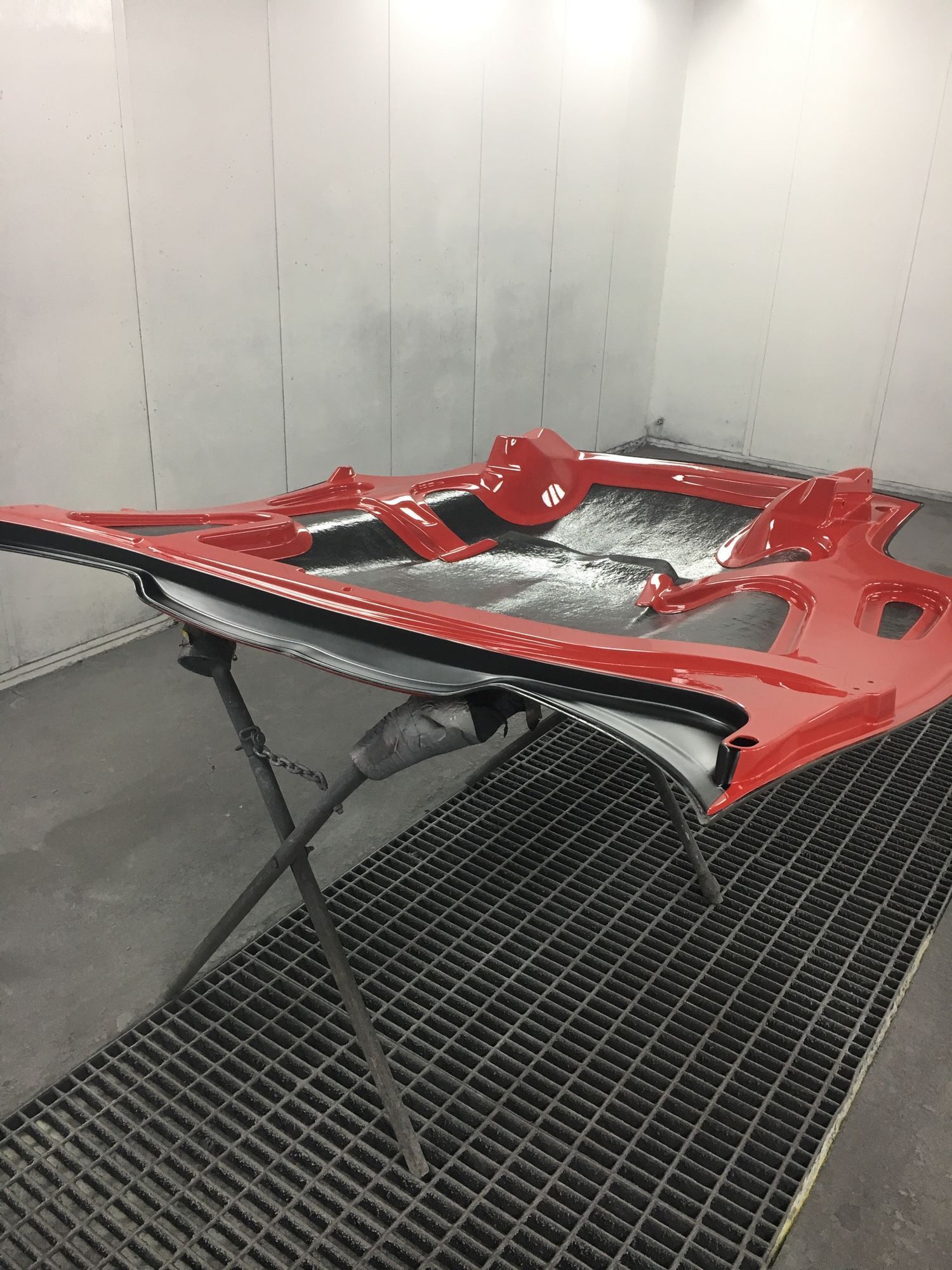

I know of a paint shop here that can definitely match the paint perfect to any color with out any blending of any kind....they have this expensive little device that "reads" the color perfectly and spits out a code for the paint mixture content...then the painter paints a large paint chip to show how it matches up before painting...yes there is hope....do a lot of checking and get in writing...
....and believe me....i was one picky sombitch when it came to my MCM hood...
pretty close color match....... huh ?

This hood looks terrible. I will help you out and buy it from you.....lol
