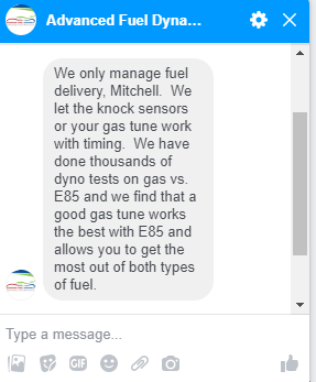

Just adding this to the conversation so this thread has some factual information from the manufacturer. DOES NOT ALTER TIMING MAP.
I should add that they are 100% incorrect about the timing tables of your pump gas tune being the "best" for E85 as that is just an asinine claim. The main benefit to running E85 is the ability to run increased timing and/or boost which is where the increased power comes from.
