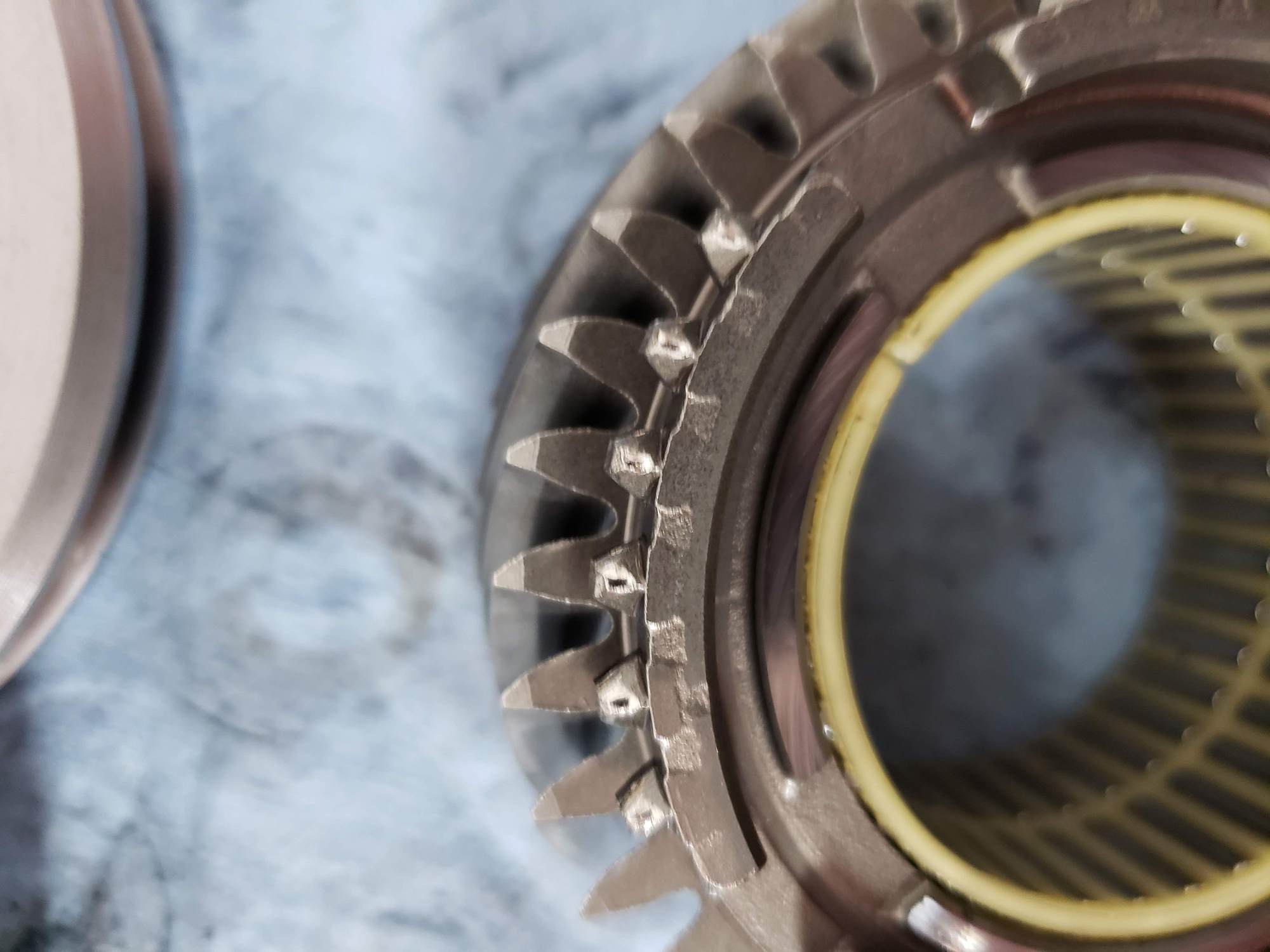

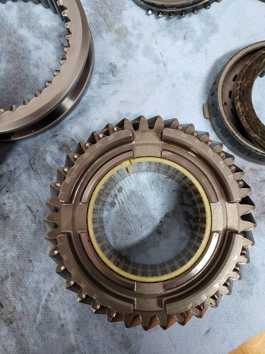

Look at the little coffin shaped teeth on 3rd gear. If any of the points are smooshed or sheared that is one point making things harder for the syncro collar to slip past.

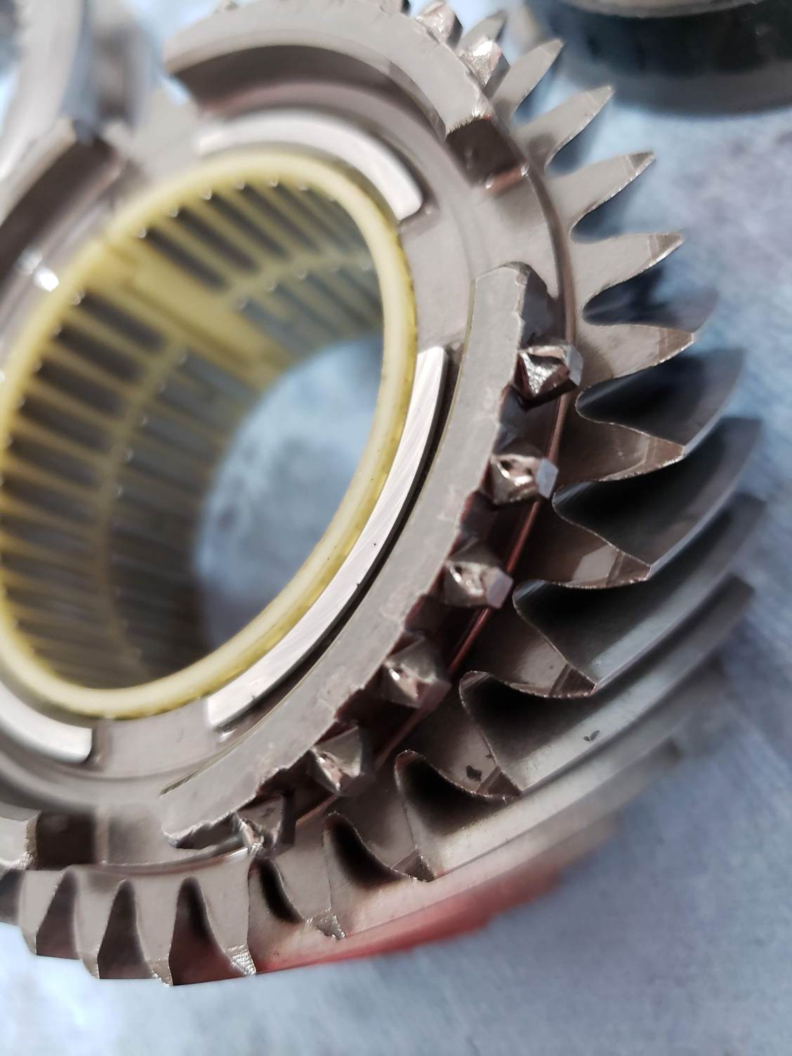

They definitely look more hammered than they probably should. Where is the best place to get the tranny parts?

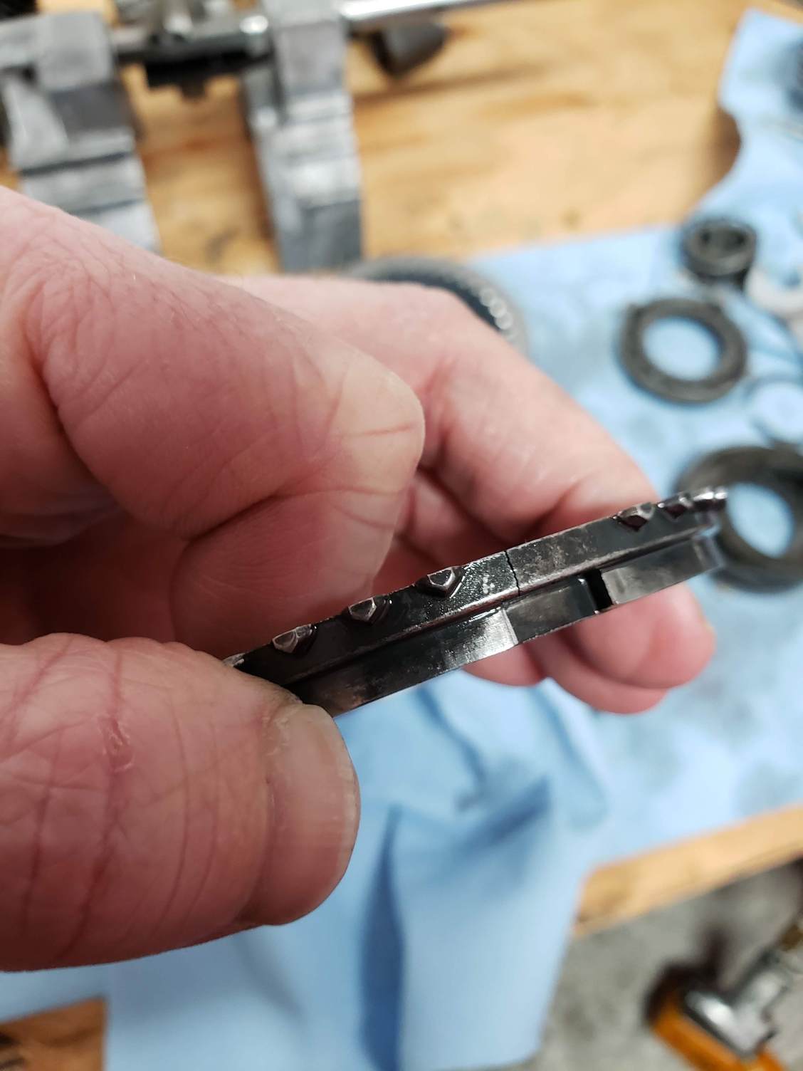

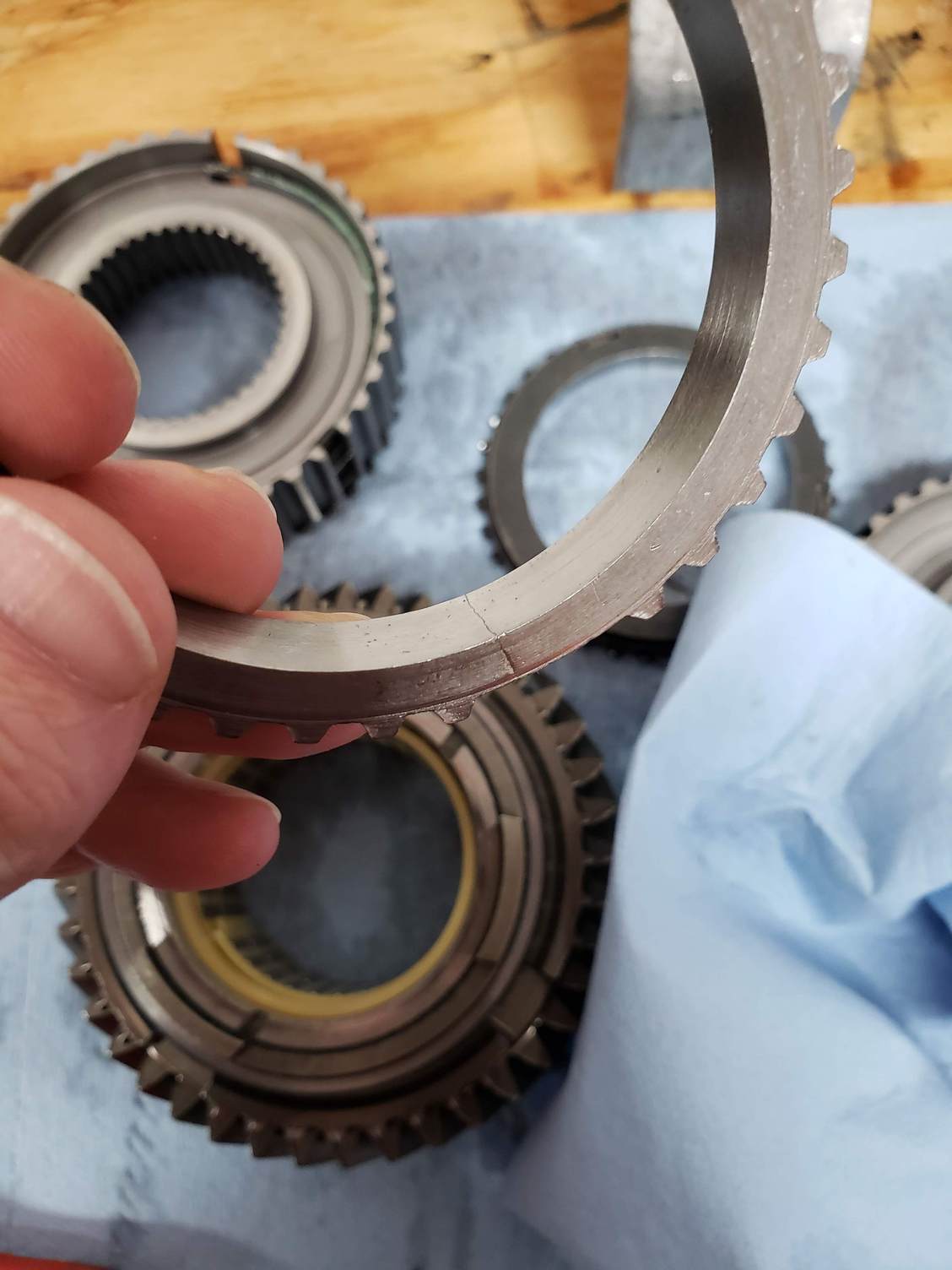

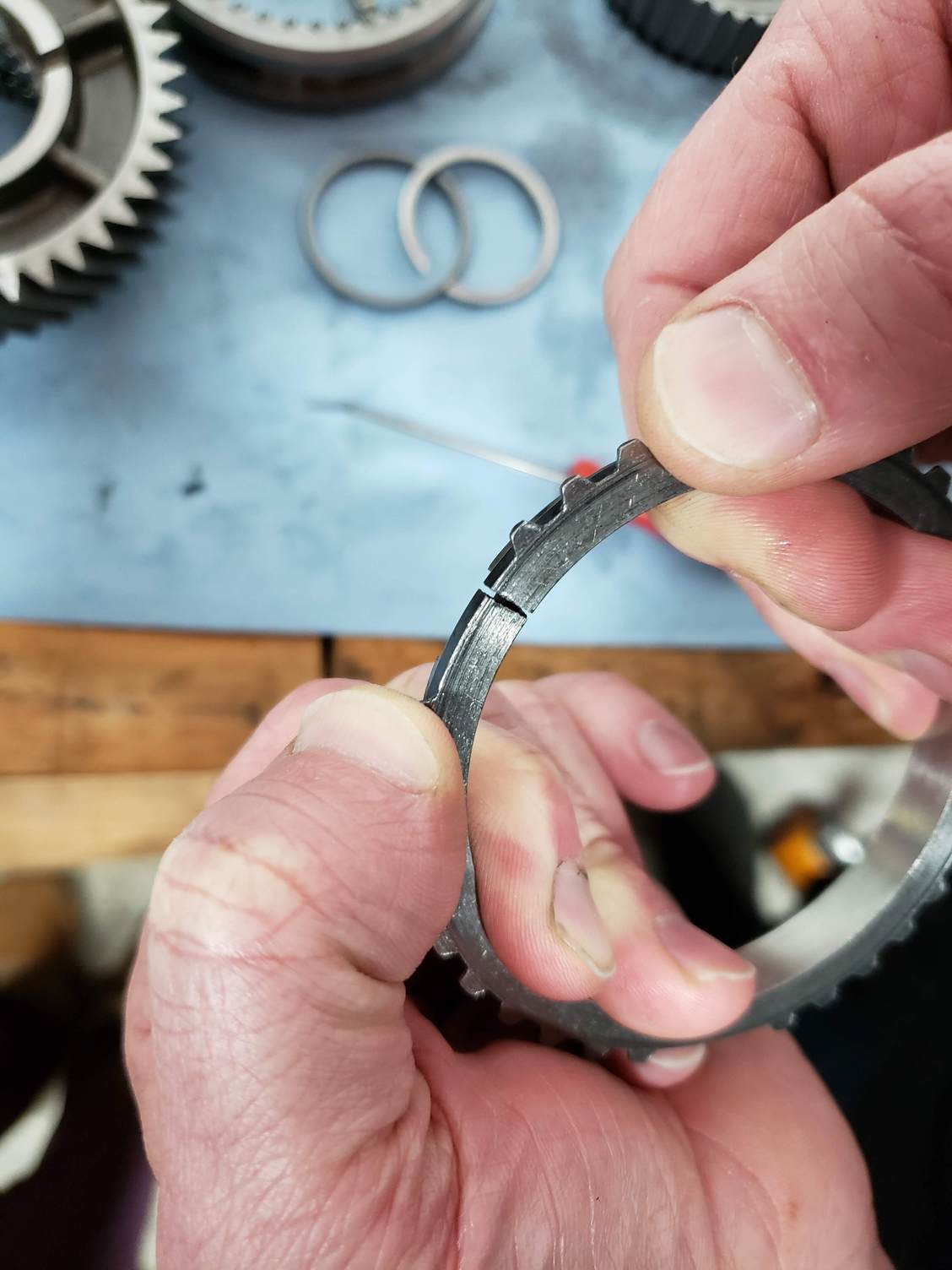

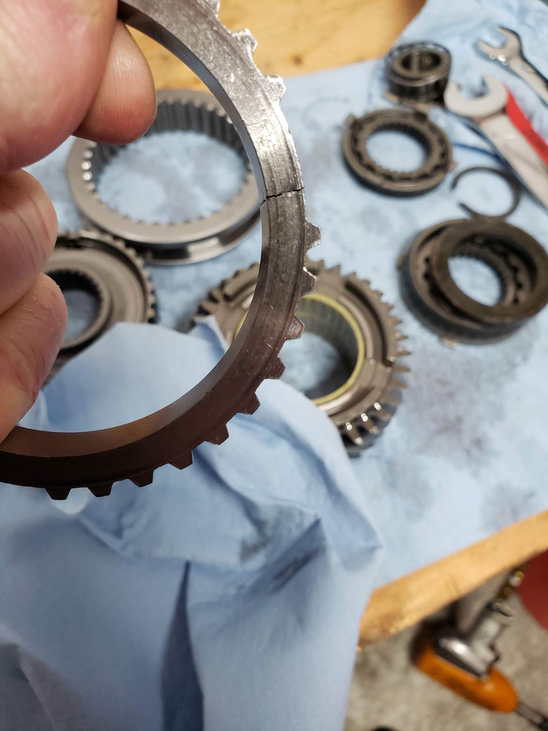

Well, in case anyone else has this issue, I think I found the source of the problem. The 3rd gear blocker ring was cracked clean through on one side. I found this post that helped me identify it.
https://www.ls1gto.com/threads/t56-r...sychro.256667/
Old Mar 1, 2020 | 12:06 AM
Potent68's Avatar
Potent68
Posts: 123
Likes: 15
Here's my broken 3rd gear blocker ring.

I needed 2nd gear on mine. It was hammered a little more than your 3rd. That said your third gear isn’t healthy.
