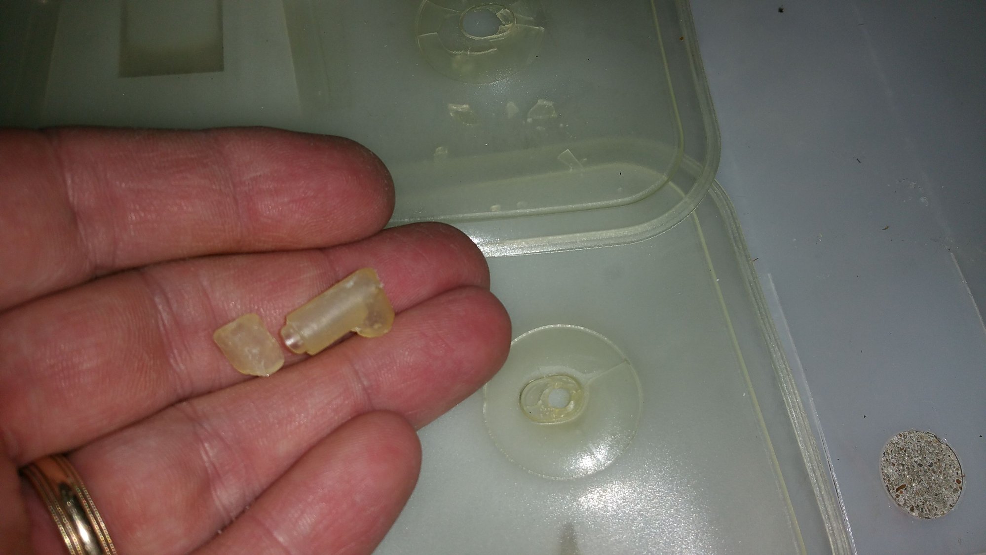

I had the same problem with both seats in my '99 when I bought it. The nipples where the hoses connect to the bladders have probably disintegrated. This what you'll most likely find... just crumbs.

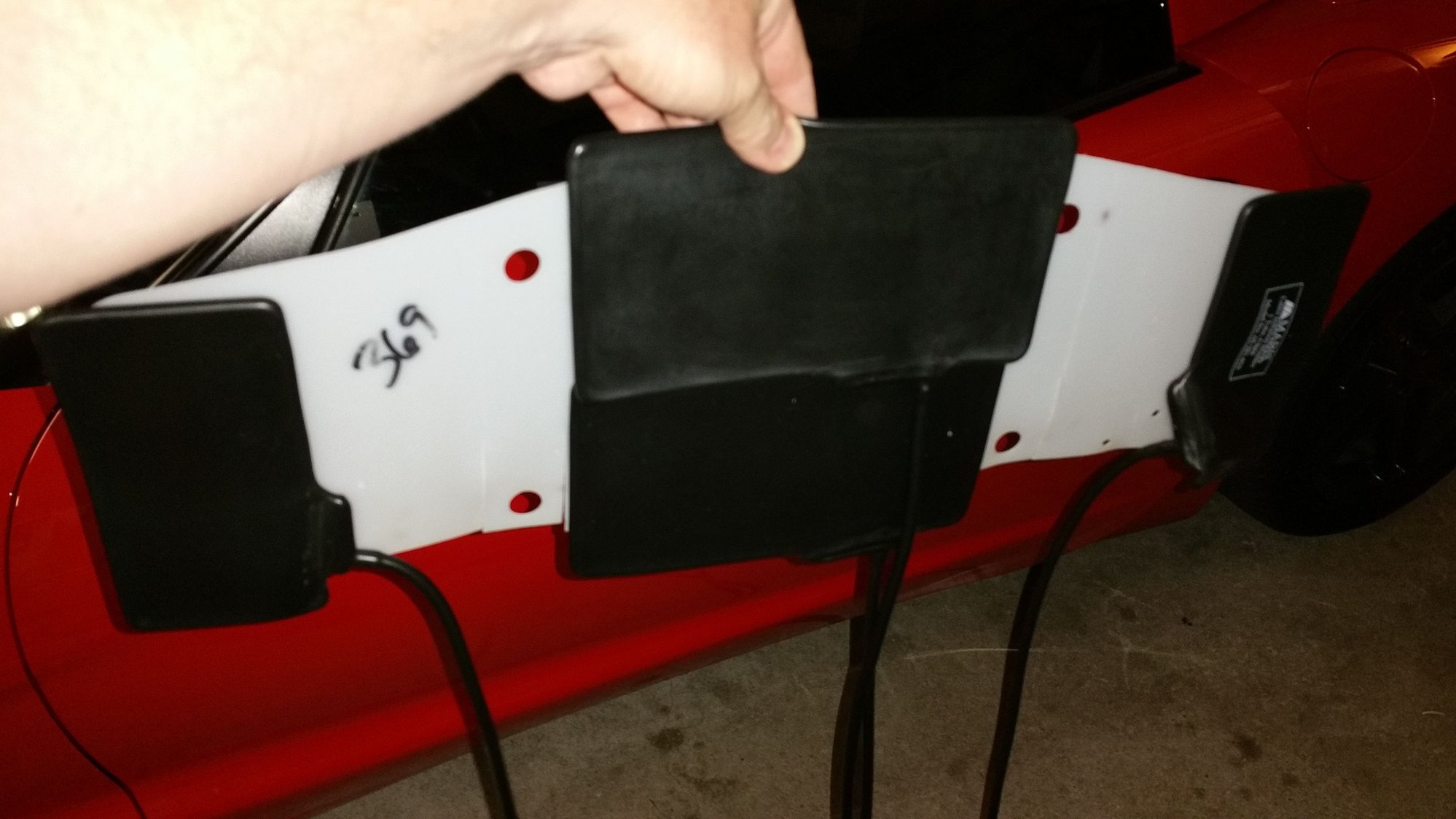

Not uncommon for both seats not to work. Both of mine did not work. I too did the blood pressure cuff fix. The buzzing noise it the pump motor running to try to inflate (or deflate depending on which way you press the switches) the air bladders. I pulled my motors and tested them to make sure they worked. Both pumps did but as pictured all of the nipples on all of the air bladders were broken off!

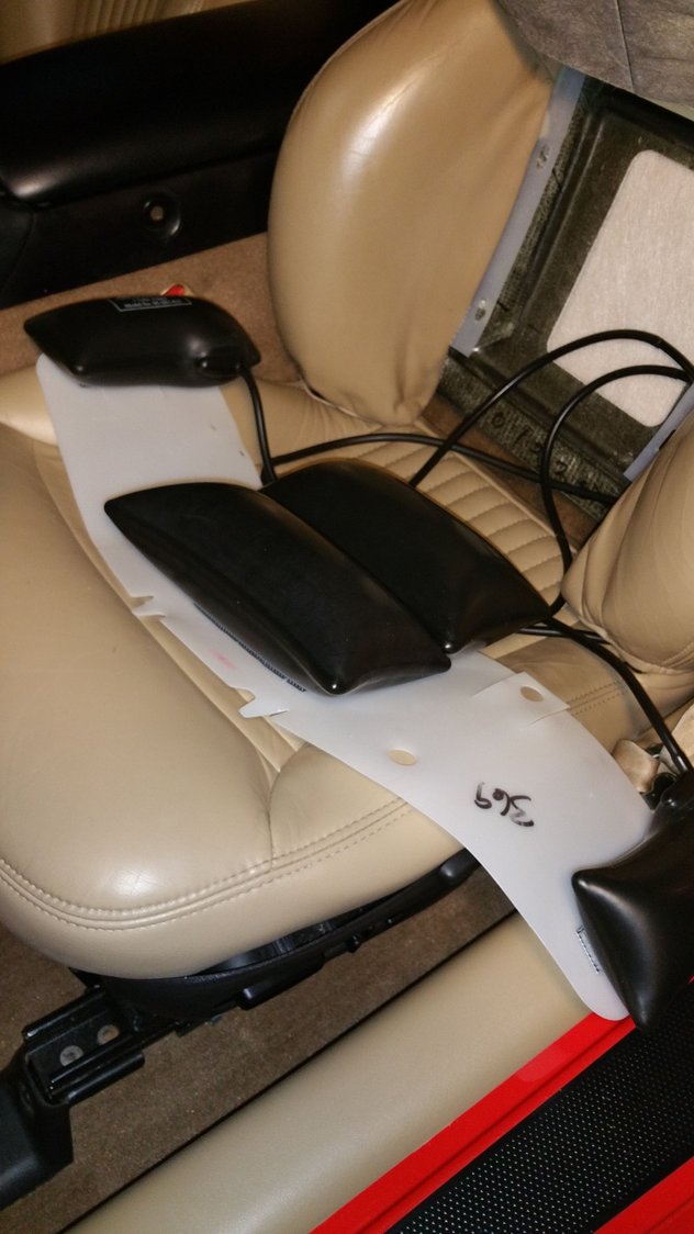

No need to remove the seats, real easy job. Here's the original diy thread.. https://www.corvetteforum.com/forums...l-style-3.html
some of the pictures might not show up anymore, and links to the cuff bladders may be dead since the thread is so old. You'll need 2 adult, and 2 child sized bladders for each seat, and a few tubing connectors.
That's about as far into the seats as you'll need to get. Just unclip the center section and raise it up out of the way.
