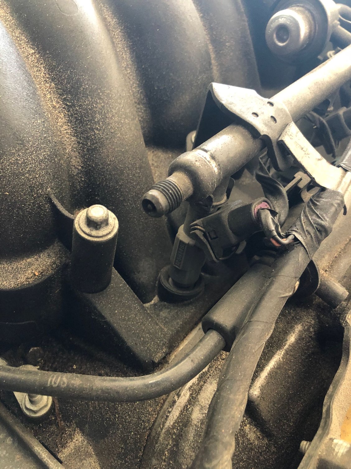

I’m waiting on a custom tune but I had to run a data log and download my tune to my tuner and the guy doing my tune said I have an serious air leak. Said I’m reading lean +19%. I’m not seeing anything obvious under the hood but I did notice this on the drivers side which is uncapped while the passenger side has a cap? Is this normal?

That's just a pressure relief valve for the fuel system. No big deal that it's missing the cap.

That's the fuel rail. Atmospheric pressure (14.7 psi give or take) is not going to push into the pressurized fuel rail. You need to be looking at all your rubber hoses hooked into the air intake system for cracks. You might not be able to find anything visually so spray around seams and hoses and clamps with some brake clean and listen for the engine to rev up to find the leak.
Thanks pal. Any common places I should be checking since I’m running so lean?

I like oharal's suggestions of spraying a fluid like brake clean around the various rubber hoses and connectors. If one of those has a tear, for example, engine idle will change when the brake clean gets sucked in through the vacuum leak.
