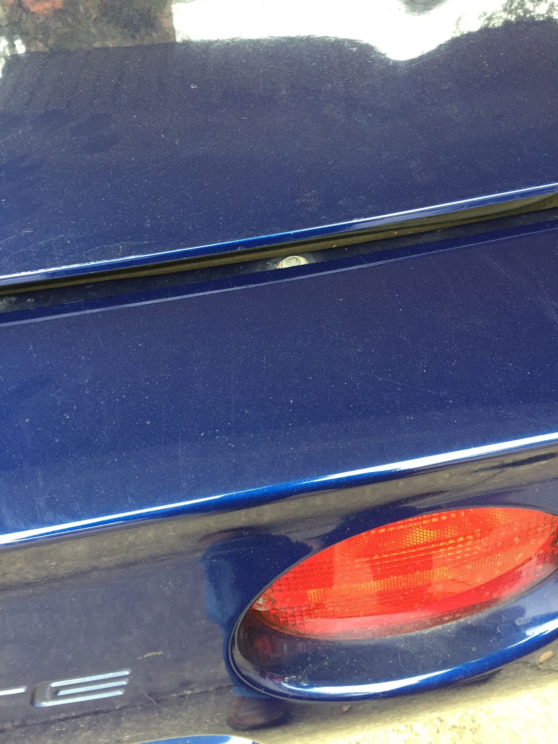

From: Lafayette Louisiana
Pop with new struts
