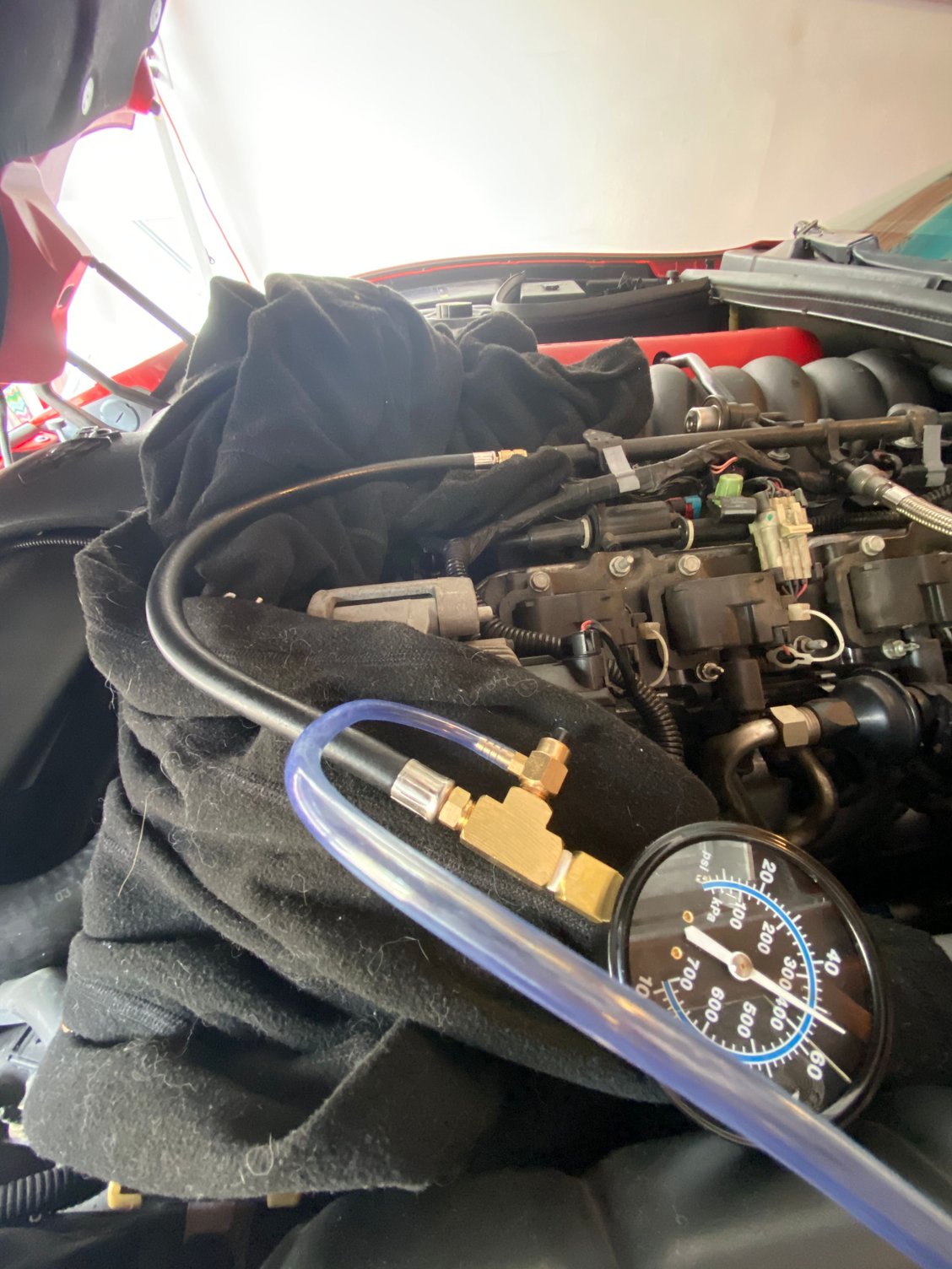

A week ago the 2001 base c5 auto started unlike its normal self. I always turn key to on, let pump prime, then turn over and she insta starts like a champ.
Now however, it turns over almost hesitantly. Takes 1-2 seconds longer and feels like a weaker ignition vs it’s typical rocket ship self. Funny thing is once it’s started it runs great. And if I turn it off and restart, it fires up like it should.
I’ve started by checking fuel pressure. Put the tester on, turn key to ignition, and got 50psi. 4 hours later it was down to 40 psi. 12 hours later it’s down to 15 psi.
With such a slow leak I can’t believe it’d be the check valve right? And 50psi should be enough to start the car yea?
My largest concern is fuel pump as I do t have a lift so I’d have to pay to have that done. But with such a slow leak I’m leaning more towards a leaky injector causing a hesitant rich start and slow leak, or the ignition switch itself.
Hoping someone might have experienced something similar. Thank you!

Don’t worry about the 4 or 12 hours later !!...per the 2001 FSM you should have 55-62 psi static key ON and should not drop more than 5 psi after 1 minute key OFF or after the 2 second prime !!...if within limits relieve the fuel pressure to 10 psi...if it drops more than 2 psi after 5 minutes the book says replace the fuel pump...that’s it !!...if it drops more than the initial 5 psi we can discuss that (injectors or check valve).

yea it didn’t move at all for a minimum half hour after trying. If my FP is low though hmmm that’s something else.

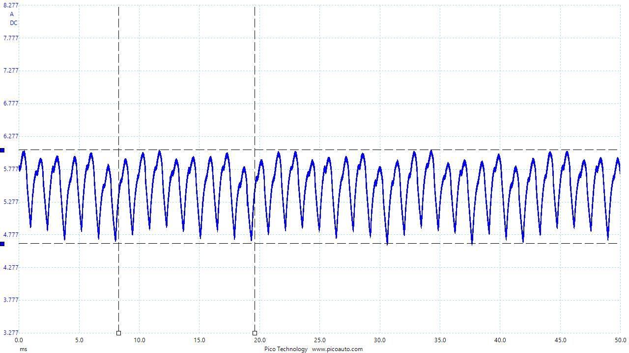

You said your static pressure 50 psi so you're a tad low but the first thing I'd check is your battery...12.66 volts is fully charged (11.89 volts is dead and 12.45 is the MINIMUM good charge) so I'd check that FIRST !!...low battery charge can cause a few issues so make sure your battery AND charging system is in top shape. When was the fuel filter ( fuel filter/PRESSURE REGULATOR) changed last ??….my fuel pump (waveform enclosed) on statically with key on draws about 6 amps @ 5300 RPM...you can check current draw with a DVOM jumping between pins 87 and 30...most DVOM's are rated for 10 AMPS max so you should be OK there...another thing is your injectors AND coil packs (coil packs on cold start draw around 8 AMPS EACH) are fed through ignition relay 42 so if the relay contacts become pitted that can cause issues...every so often my '01 takes a few more cranks to start but I don't worry about it...it usually starts on the first crank...give a yell if you need more guidance. Oh, and a failing cam sensor can cause “hard start” issues !!...also if you do think it’s pump related I would clean the pump ground (G401) which is located onboard of the left rear tire on the frame rail.
