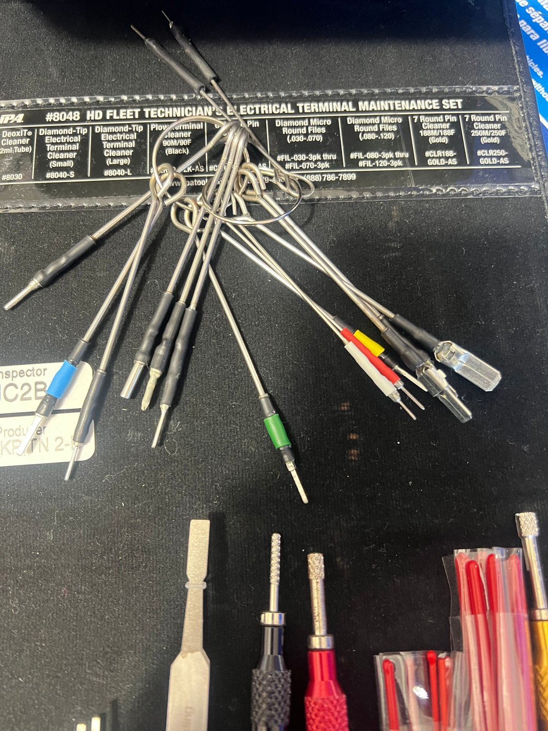

This bucking could also be a TPS signal dropping out…I’d check the sensor terminals for fretting and also a terminal tension check could be done..make sure the terminals look aligned !!..you can get this kit cheap on Amazon…good to have !!
…a scope is best to look for this fault…a voltmeter refresh rate is just too slow to pick up the voltage dropping out…a scope can see millions of voltage samples over a millisecond !!
