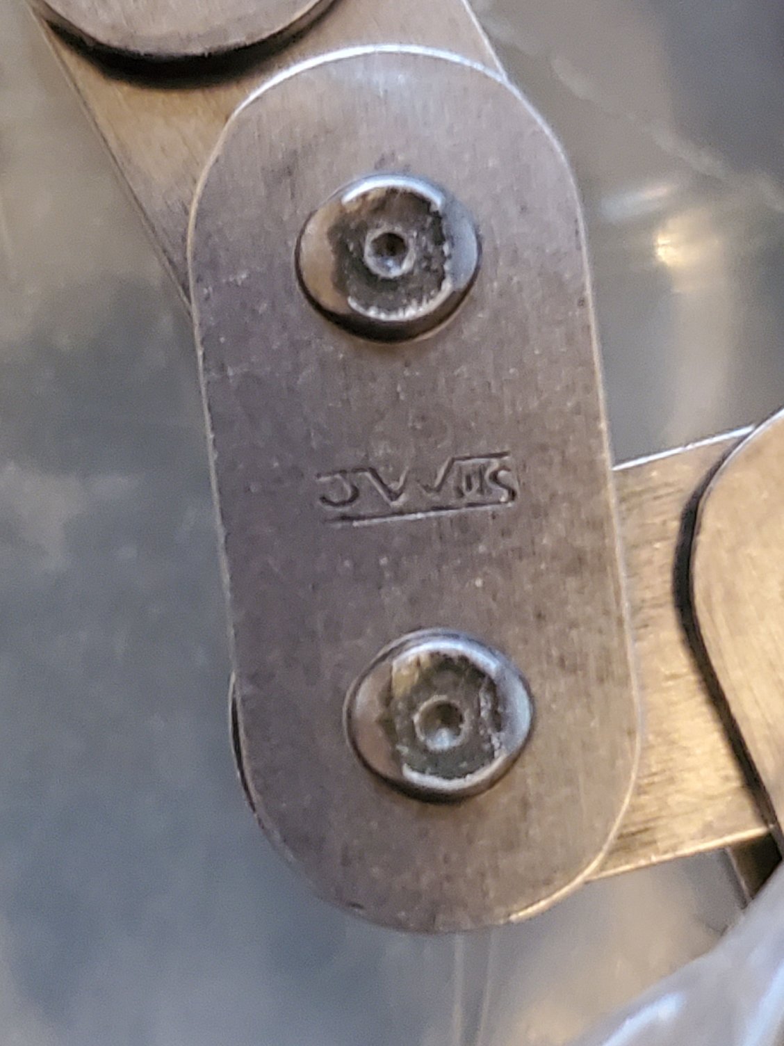

My chain has what looks like some markings like "JWs" or something like that. I am going to upload a pic. Just curious how you identify a true C5R chain. I paid $150 for it and I know VR is legit company so not questioning them, just more curious before I throw this on my 416 this week.

I just bought one from katech the other day. Looks similar to yours. Is there another stamp on it somewhere? Mine has the Katech logo on one link
i bought from Katech because I came across this link where Katech said that Hinson motorsports is knocking the chains off.
https://ls1tech.com/forums/generatio...ame-price.html

That is the “JWIS” marking from the German manufacturer IWIS. They make the C5R chain, along with chains for a number of other aftermarket manufacturers and car makers. JWIS chains are known to be very strong and reliable, hence the reputation of the C5R chain.
https://www.iwis.com/en-gb/products-...5-1-jwis~p4767

Starting from the middle of the year last year, we started laser etching the Katech /K into the chains to help reduce the amount of fakes getting out there.
at 1:06 you can see a picture of the chain and the K that is etched into it.
