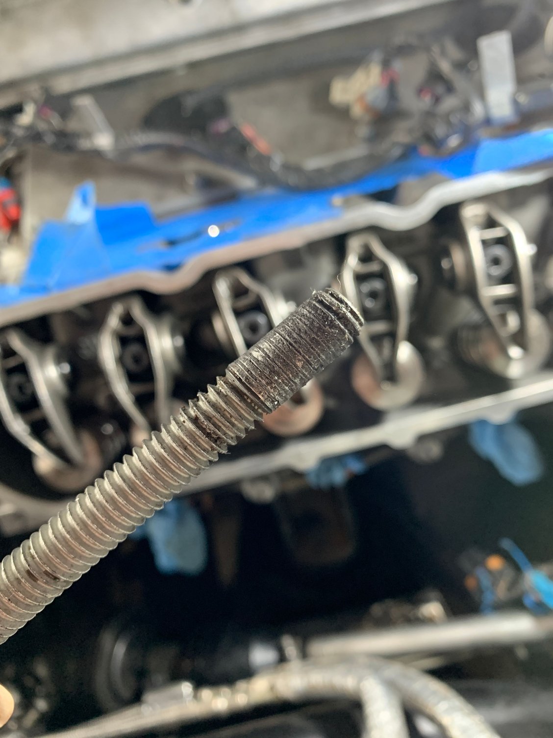

as the title states ...
what are my options here ????? I’m fairly adequate on the mechanical aspect of engines and so forth

This isn't necessarily the most economical solution, but a solution nonetheless:
Amazon Amazon

Check this out:
https://www.corvetteforum.com/forums...ad-repair.html
Good luck, it's the best option.

Did the same thing on my bike. Went to torque down the last bolt after a valve job and it never stopped spinning.
I ended up taking the head off and having a machine shop do the time-sert. Fairly positive it ran me about $50.

big fan of studs !!!!!!!!

did you clean the threads down with a chaser before install?

Good advice, for sure, but a little late for the OP...........
