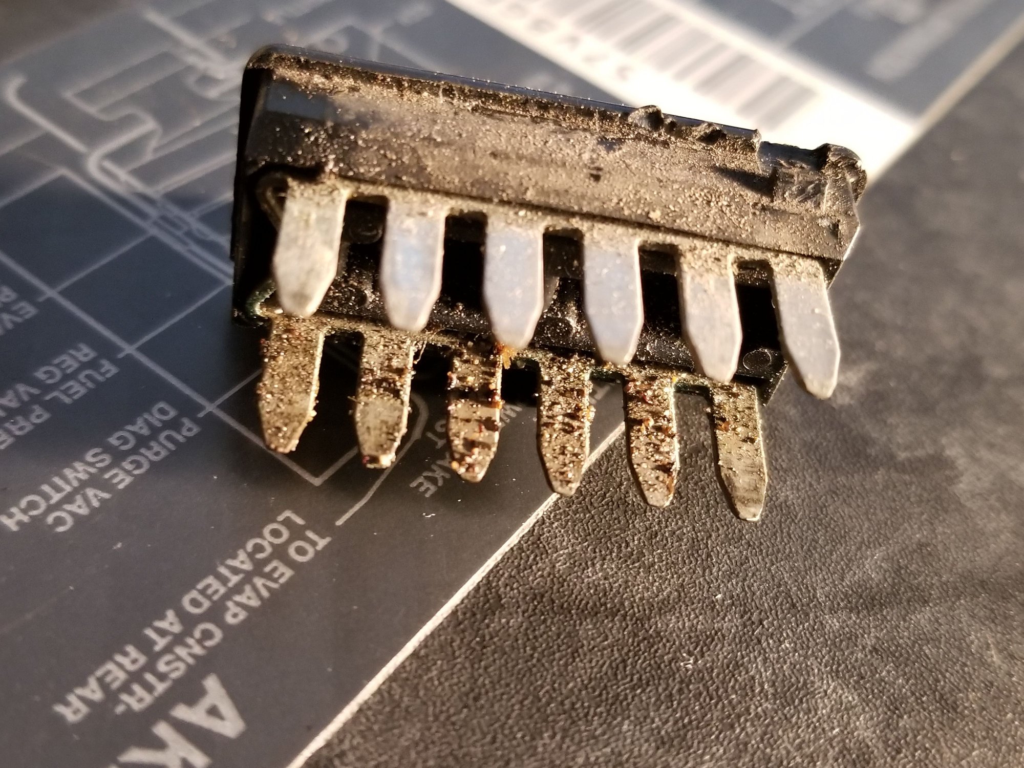

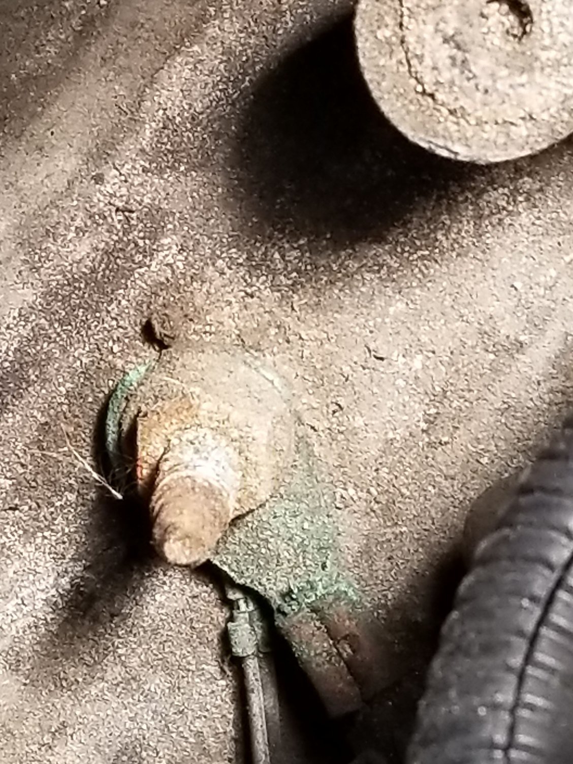

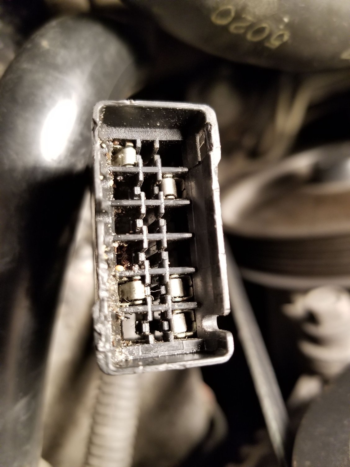

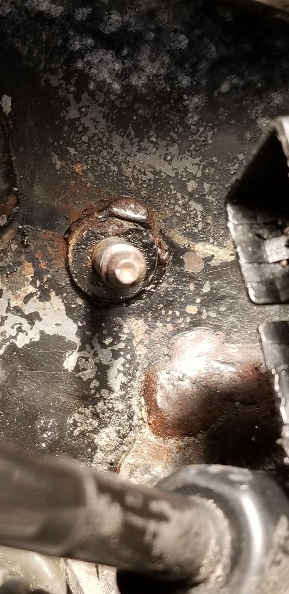

Thanks for your input Bill. I read your post on cleaning the grounds and connectors. Great write up. I'm learning alot from you and appreciate your help. Today I started on inspecting and cleaning up the grounds and connectors. I removed the ground 101 on driver side and removed the male connector. As you can see from the photo contacts look good no corossion just the lower contacts are oily and dirty and female connector looks good has accumulated lots of dirts and oily. I don't understand how the oil and dirts/debris got inside the connector. The 101 ground welded thread to the bottom on frame paint is peeling off and around the frame I sprayed down with WD40 and wiped it off. Do I need to strip/remove the paint and some rust that's there off the thread before i put the ground back on the 101 or is it ok from the photo you see?
Tomorrow I'm going to remove the oils and dirts from the male and inside female connector with contact cleaners then wrap the connectors with that elastic tape. Now do i put dielectric grease inside the connectors?
Here's the photo
Ground 101 male connector oily and dirt debris lower prongs.
Ground 104 below battery. Rusty
Ground 101 frame threaded stud to frame. At bottom threaded stud to frame paint peeling off and can see some rust on frame. Ok to leave like that or do i need to grind off paint and rust to bare metal before i mount the ground on that stud/frame?
Hround 101 famale connector inside oily and dirt/,debris inside
