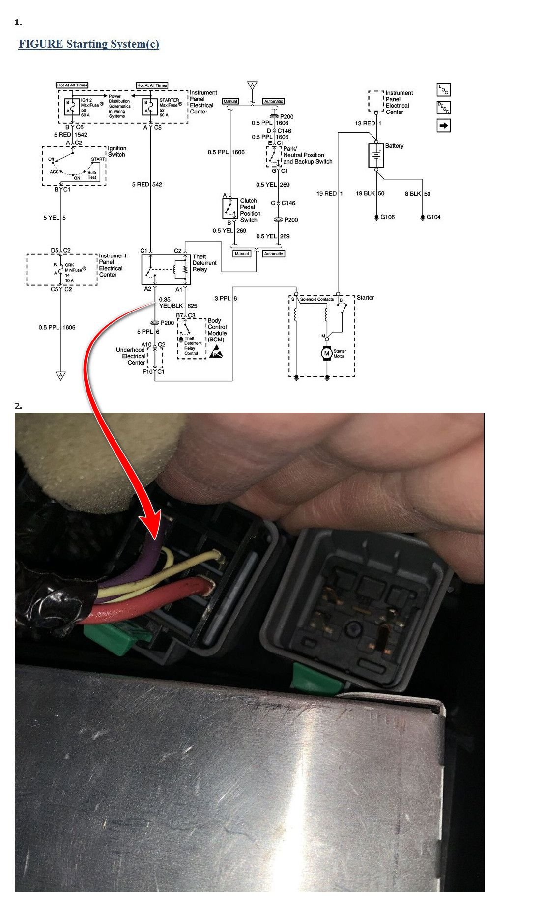

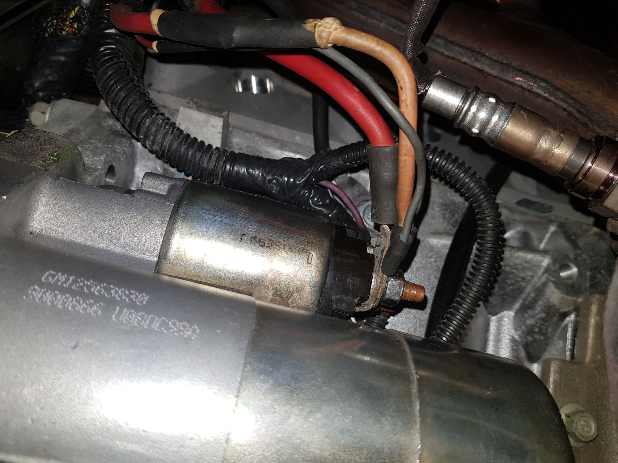

Before you go under your car you can check whether your TDR relay give 12 volt (battery voltage) to the startersolonoid with a multimeter in passenger footwell
If you look through this post will get further info on how to measure
The purple wire shown on the first photo below goes to the startersolonid in the engineroom .
If you try to start the car and get proper voltage here , then you have to go under the car as mentioned above and inspect your starter.

Lots of people post that everything goes dead when they turn the key to the start position and nothing happens, when in reality all power is switched off to systems not required to start the car. You have to check that the TDR is being energized and switching power to the starter solenoid just as the previous post has suggested.
