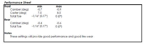

Pfadt Corvette Alignment Specs - Street Performance. Had it done on my 2004 A4 Convertible. Had trammeling issues prior to this alignment. After removing the old Goodyear run flats and having new Continental DWS-06 non run flat tires put on and the Pfadt alignment, no more trammeling issues, tire wear is even across all tires and car drives straight as an arrow.
Here they are, from their attached C5/C6 alignment document

I'm not the expert on lowered suspension geometry, however it should work just fine, based on your targeted alignment category (see document). The alignment will still work as the car sits..
Lowering might cause *other* issues, like bump steer, or bottoming out, but that's another story..
