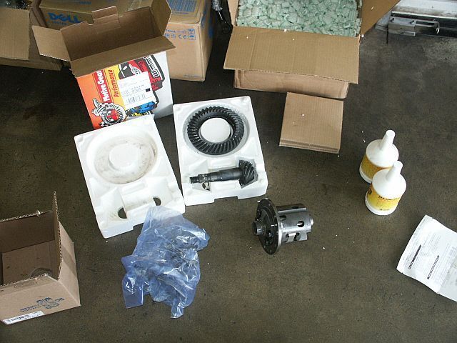

Well the Wavetrac's are gear-diff positraction, like the Torsen T2R upgraded in my past TA:
LS1 TA 4.10's, Torsen T2R Gear Diff
They work the best for street driving / road course / AX. Not necessarily drag racing..that's why RPM put's them in their rear end builds..
