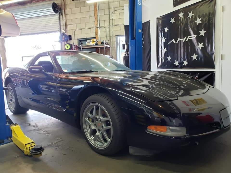

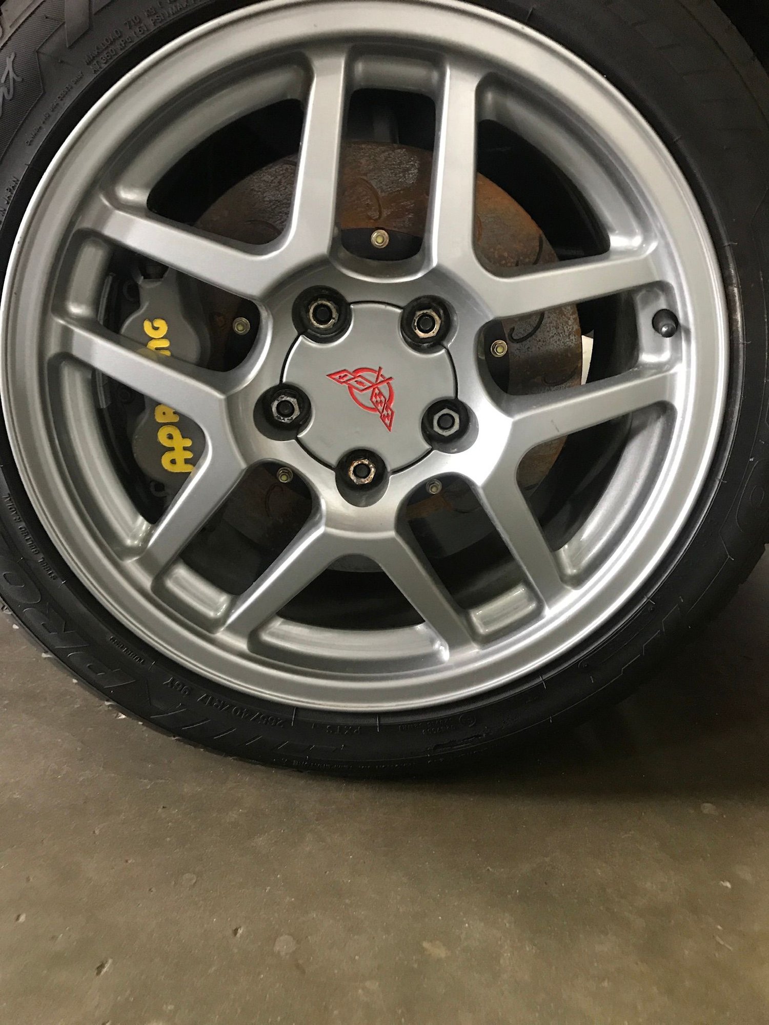

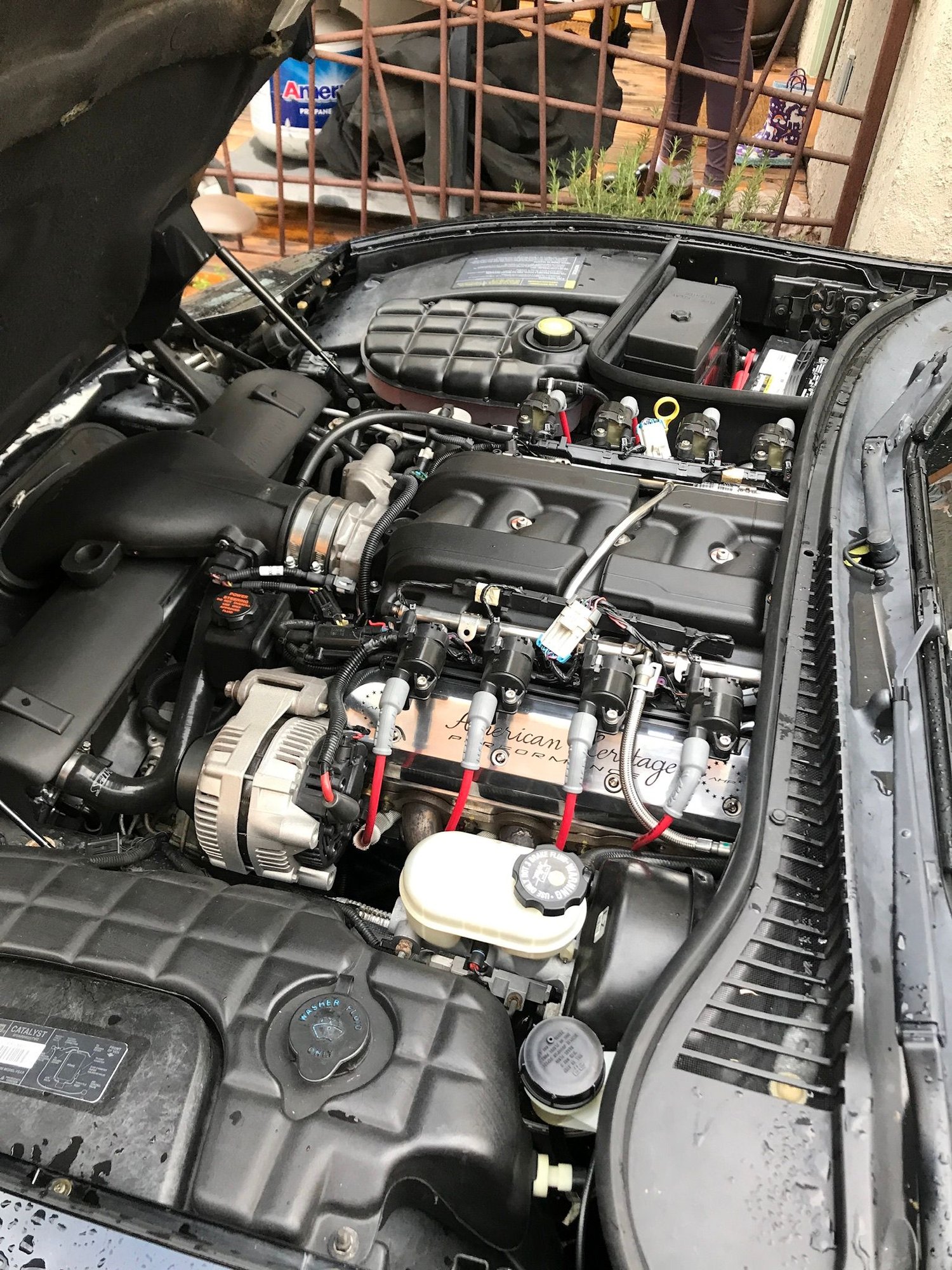

I upgraded my car (including suspension) to handle the engine.
The suspension mods include:
C5 Z06 speedlines w/305 tires, C6 Z06 shocks, Metal End-links, new Wheel Bearings,Axles,not to mention the suspension itself was out of the car during the build.
My question is what does “4 corner balancing” and a full alignment technically include ? Should I corner balance ?
I hope I can really “tell a difference” on the road after it is done. Car seems fine, but it has never even had an alignment and I just slapped all these parts (and engine)in a 2000 FCR.
It seems to sit high for sure not sure if they can/should lower it (?)
i am going to West End Alignment here in So-Cal and they are evidently the best at what they do.

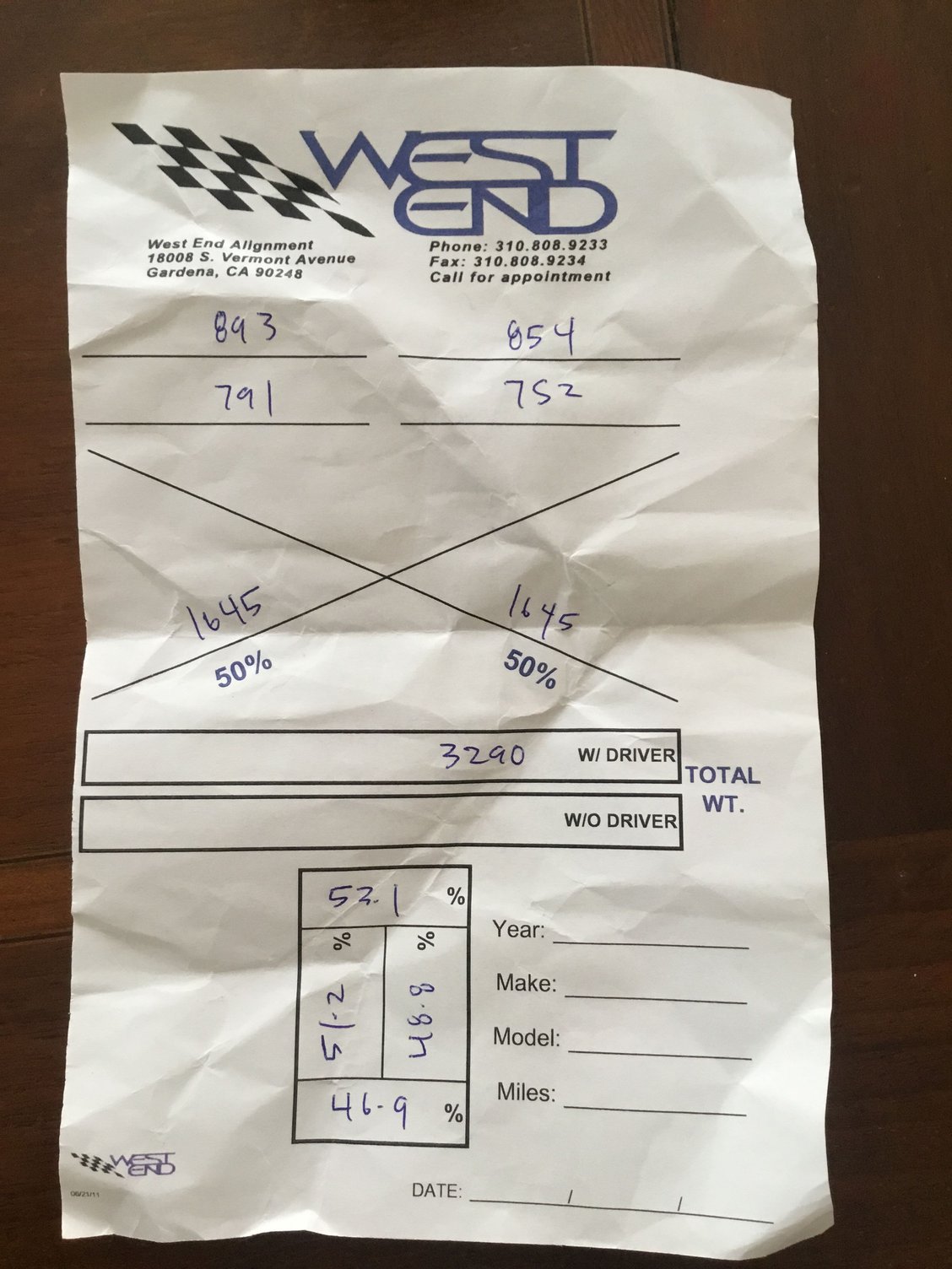

10/4. Below is the corner balance but they did a lot more.
I did not request the camber/toe in numbers, etc....I am running a non OEM set-up so I put myself in Chris’s hands completely and they can manage from here out.
Car is perfect I will say. More confident and planted. I can paint a trail of “11’s” on the street banging into 4th gear now. Before it would get squirmy between 1st and 2nd, I did not have confidence to even bang into third under throttle.
It is more than just that......but that does illustrate (to me) an improved suspension/balance. I got a lot of torque to manage.

Sweet, I likey the corner numbers, pretty close
Yeah I bet some toe-in in the rear, helps keep the car planted for sure! It's amazing what good alignment values yield..
