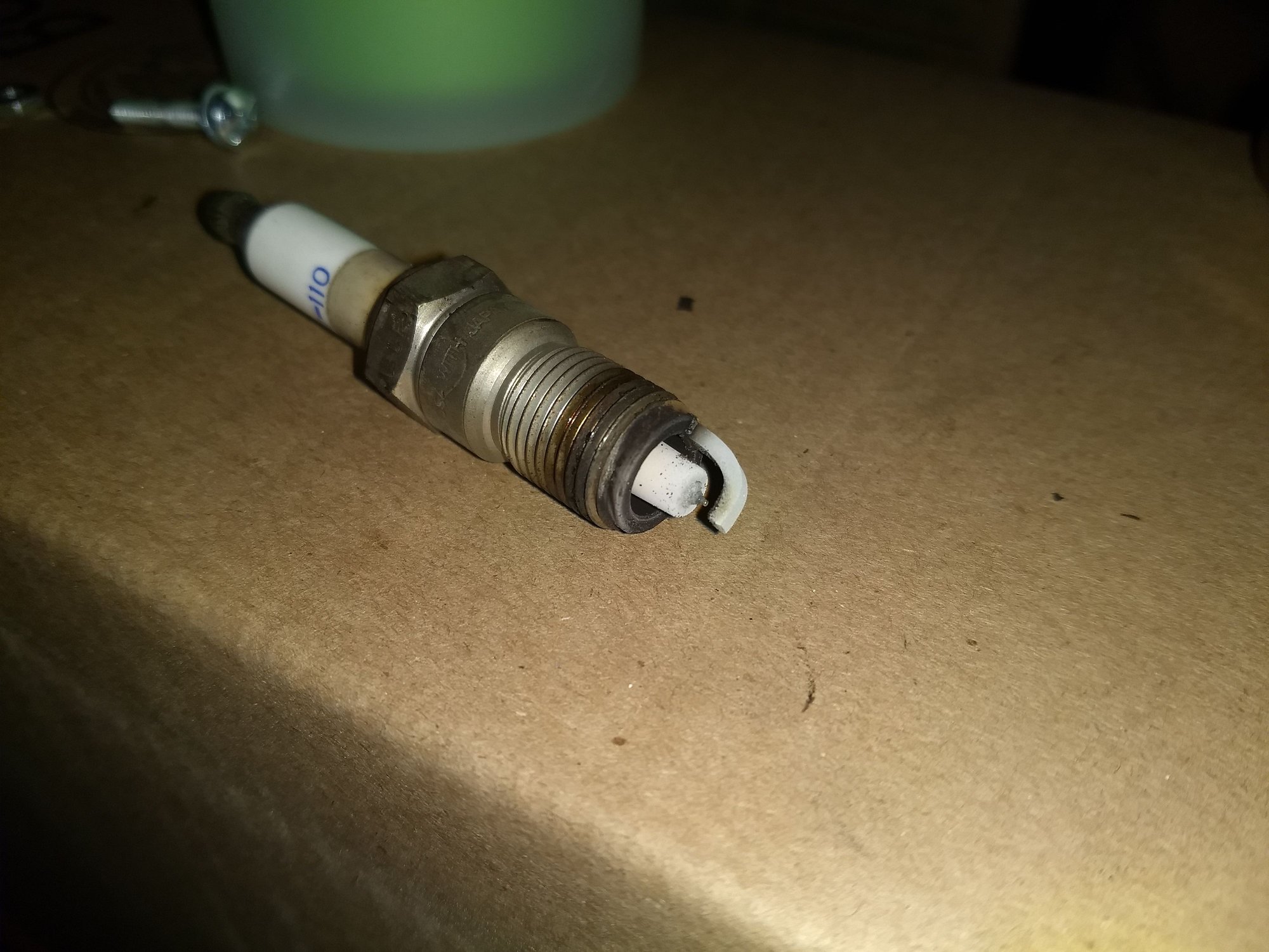

Forgot to mentions, but all of the plugs were clean, just white residue on them like the ones pictured. What size thread tap would this take?
It is tough to get my camera in there to see but this is why I suspect it is just gunked up. You can how far I can thread it in and the rest is just black.

From this picture the threads look bad. But its just a phone pic. not sure on tap size. use the sparkplug threads for the tap size. 14mm something ??

14mm X 1.25 is the size.

I ran a tap through it. A couple small flakes came out but the new plug threaded right in and it is holding tight. I took it for a good 25 mile drive and it runs great. But the rough idle is still there. I forgot to mention that I cleared the P0300 code about 100 miles miles ago and it still hasn't come back. Before my test drive I had given the car a wash including the muffler tips. After that 20 miles there was a very small amount of soot on the bottom of the tips. Not sure if that means anything.
