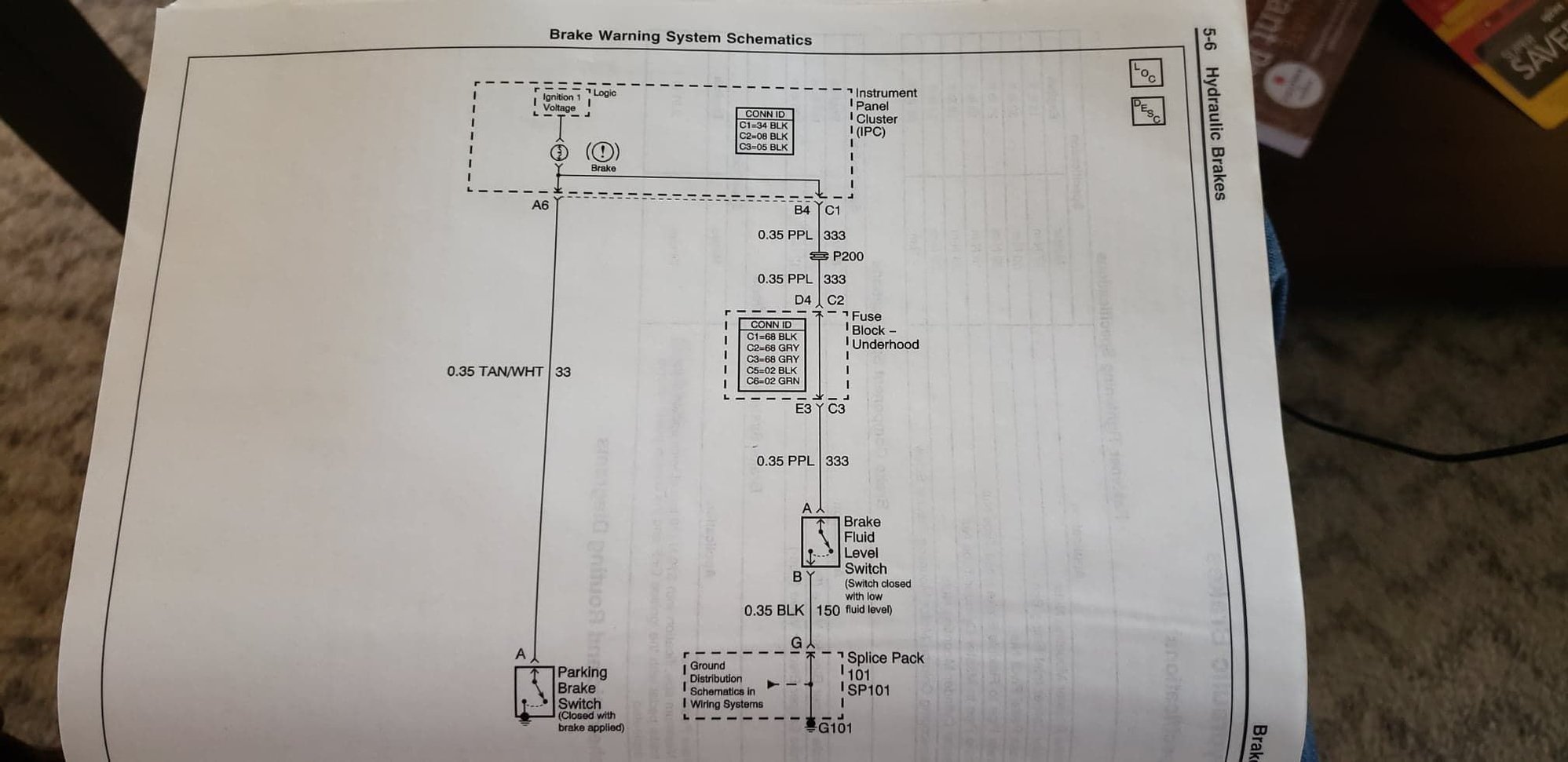

I dug out my service manual for ya. Mine is a 2002 so this may vary depending on your year, but I bet it's the same regardless. The brake fluid level switch closes with low fluid. If the switch is working fine because it's new, and the IPC thinks the fluid level switch is closed because it is seeing ground at the connector pin, you must have a short to ground of the purple wire somewhere. With the key off, disconnect the brake level switch and use your multimeter to probe resistance from the pin of the purple wire to the frame, engine block, alternator frame or battery negative terminal. It should say open circuit. If there is some resistance you have a failed wire that is shorted to ground.

Do you have a DTC number? I can check the manual if there is a particular procedure for it in case your wiring checks out.

Looking at the shop manual diagram, it appears that both the Brake Level Switch and Parking Brake Switch both trigger the same indicator lamp. Are you actually getting a DTC on this, or just going by the indicator lamp? The Parking Brake Switch on my '02 is very sensitive and the slightest touch of the brake lever turns on the lamp.
Brilliant advice, given brilliantly. I am stuck at home today with a foot of snow on the deck. I think I can break out the multimeter on this deal and diagnose what's happening here.

My reservoir is quite full. And the float is all the way at the top, away from the sensor. I think it's an open ground , as has been suggested.
I get a code. I don't remember which one it is, but I'll stick the cheapo OBD2 Bluetooth on it and report it here.

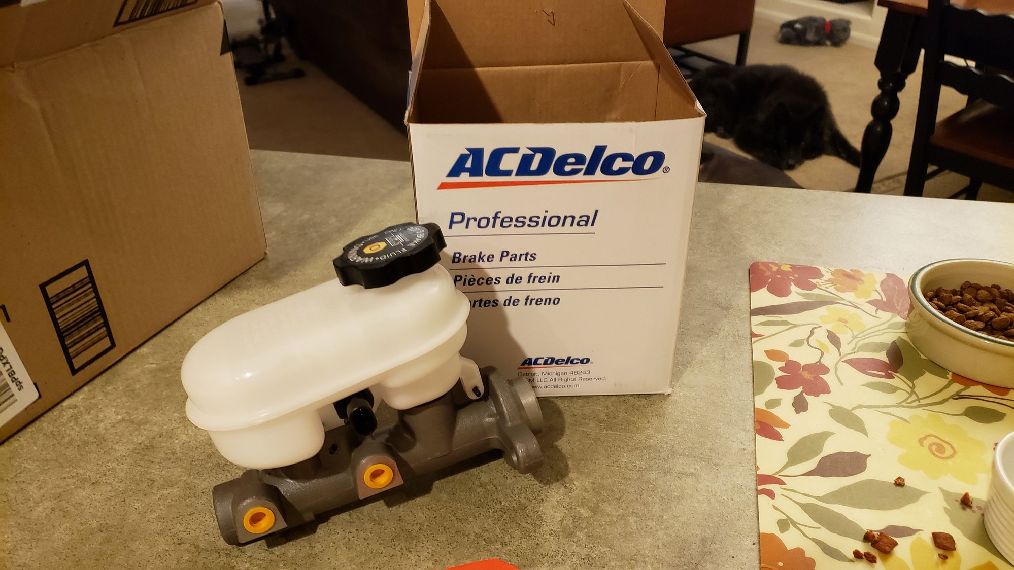

I determined that the reservoir I purchased from Rock Auto is really tall... probably too tall for the Vette. It's for a K1500, as the aftermarket and AC Delco reservoirs are no longer made for our C5 cars, I decided to change out the master cylinder.
I found an AC Delco Pro with reservoir for $68 on Amazon. Only drawback? Delivery date a month out
So I ordered it, and determined that I can bleed the brakes without much drama as I have a cooperative wife, great jack stands, and a Mity-Vac.
The posted Tech Guide by 69 was a blessing, too. Thanks!

Look what got here 3 weeks early!
Old Apr 26, 2020 | 05:39 PM
FOGeologist's Avatar
FOGeologist
Joined: Mar 2018
Posts: 456
Likes: 144
From: Frederick Colorado
Default Master cylinder in...
And no change. I don't have any codes showing up on my cheap Bluetooth OBD 2 scanner. "Low Brake Fluid" pops up every key start, come hell or high water. I'm at 5 key cycles after a battery disconnect.
Well, I threw $70 at the problem and failed.
Now I think I'm looking for a closed circuit/broken wire/early ground or whatever.
