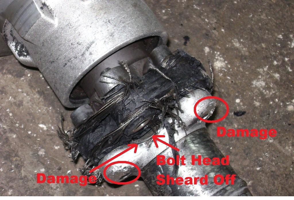

Sounds like the forward Torque Tube Coupler is done and the tink tink noise is the Coupler bolts hitting the drive shaft during power/torque changes when you reduce power…I would not beat on the car anymore until you get the drive shaft removed for inspection as the Coupler bolts could be damaging the main drive shaft tabs/ears…
