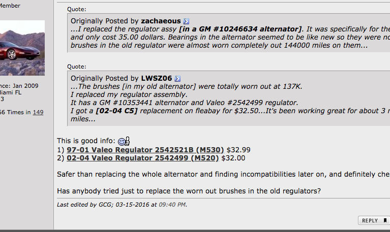

I’ve read many posts from the past and still cannot get a clear answer on this, I’m looking for the part number for a 99 automatic coupe Alternator, does anyone know the correct one?

dont know the part number but, If you look in the sticky section there is alot of good information about your alternator. There are a couple of strong recomendations
1) DO NOT TRADE YOUR ALTERNATOR IN AS A CORE find someone in your area that will rebuild
yours.
These alternators are not the same as other GM alternators and you will have charging system faults with the wrong one

As long as the alternator has this regulator you will be fine.
