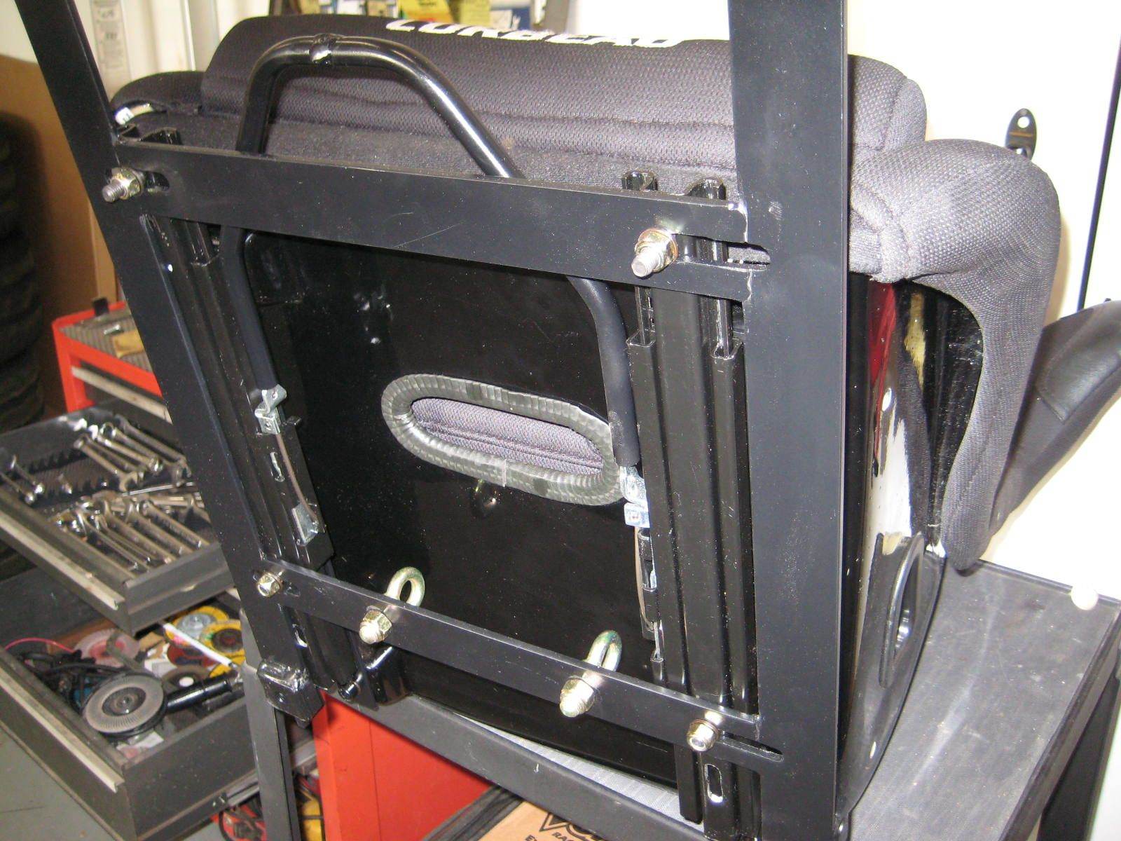

2X on what the other posters have said. Corbeau seats are OK, bur for Corvettes, their frames and sliders leave a lot to be desired. I posted a writeup I did in 2011 or so about my experience with Corbeau A4's in my old C5 FRC. Rather than make you search for it, I'll attach it again.
I'm just finishing putting FX1 Pro Corbeau seats in a 2002 Z06 I bought this winter that will be a track car. I would have gone with another brand, but a friend gave me a FX1Pro, so it was worth the effort to solve the problem of LTA Corbeau frames and sliders.
My experience with C5 seat studs is they are accurately placed, so your problem is not variance with the location of the hold down bolts. The problem with C5's is that the seat belt retractor is low, and this causes the seat well to have funky offset footprint. Since I have a mill and welding equipment I made my own frames.
Here's my frame:

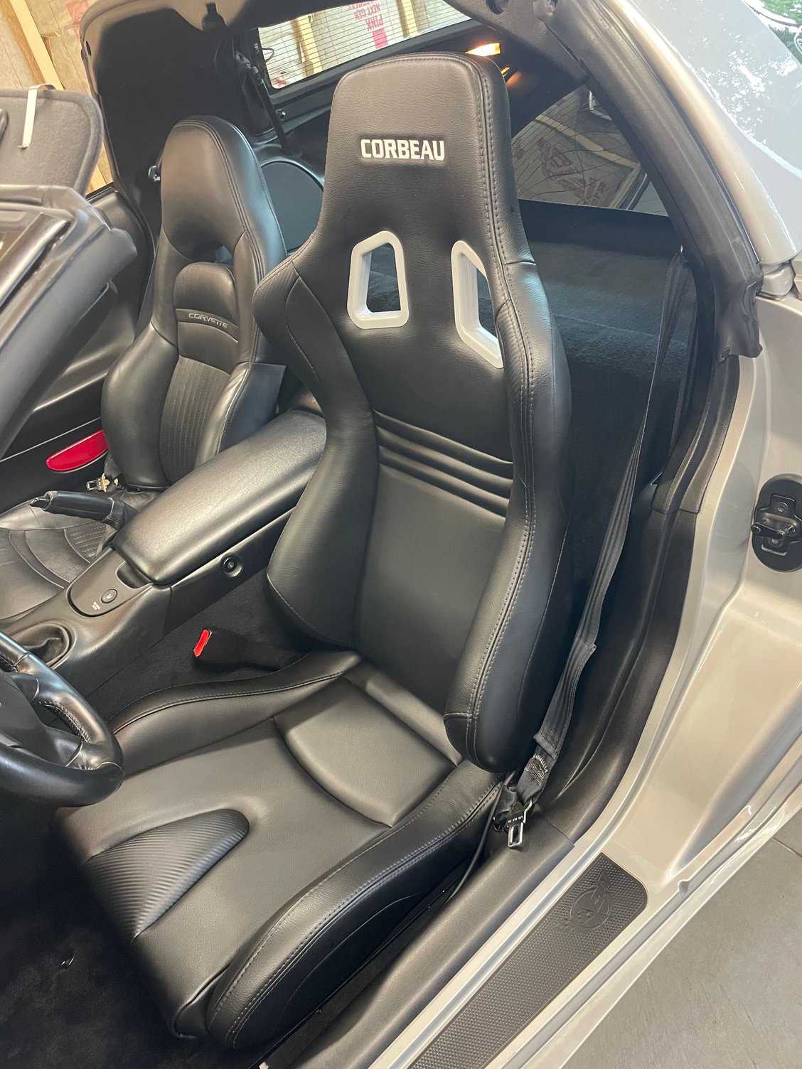

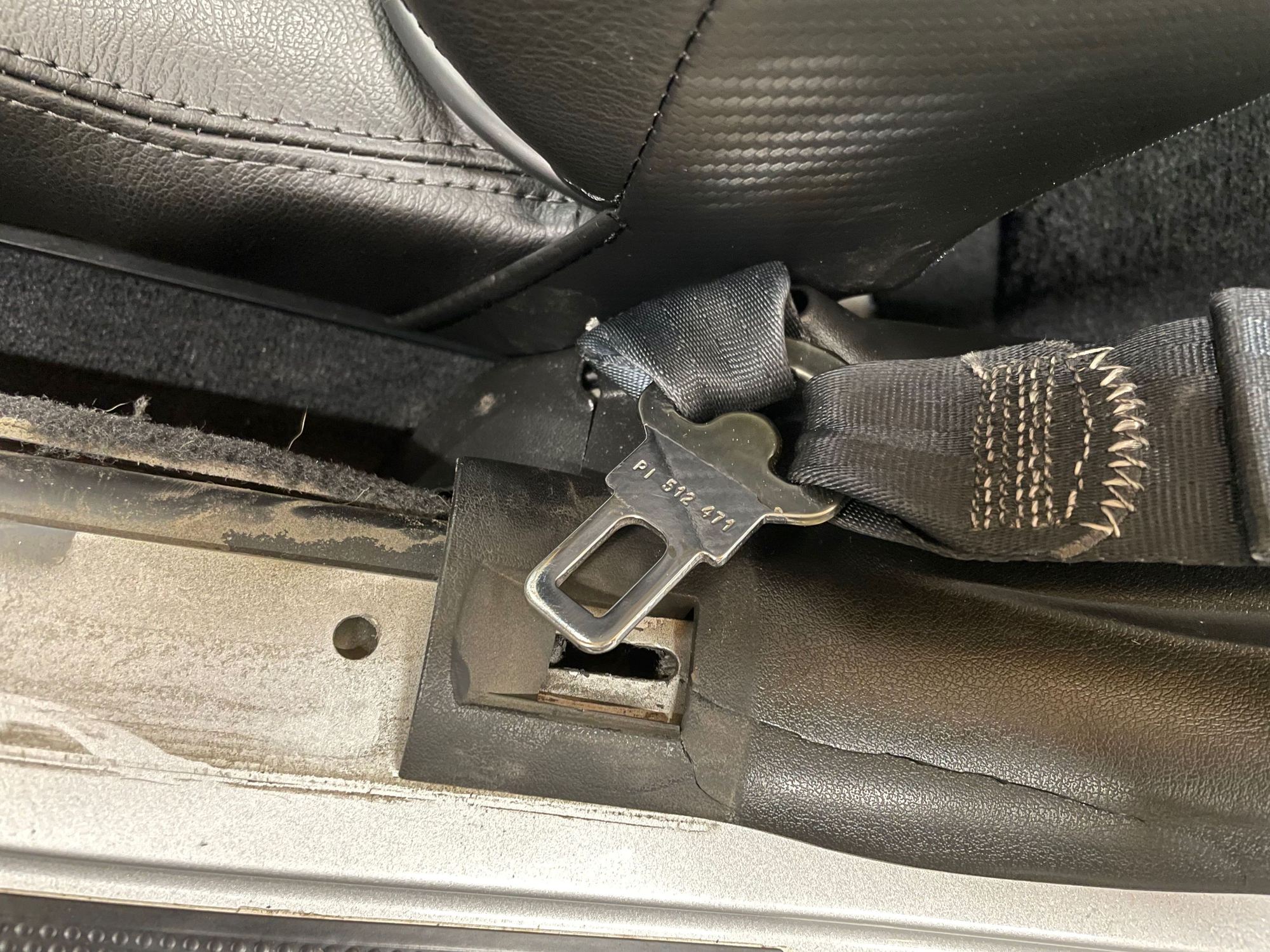

I am asking as I just bought a Corbeau Eco X seat and seat mount for the driver's side of my C5. I tried to install it tonight and found the seat interfered with the seal belt retractor. HARD. See below.
Corbeau Evo X seat and seat mount interfering with seat belt retractor
The seat frame is has two net zero holes to the seat (rear) and two net zero holes to the body (rear). No cross-car adjustment.

Update: I redrilled my Corbeau seat brackets to move the seat 1/4” inboard relative to the seat bracket, This was just enough to clear the seat belt retractor and barely clear the seat belt latch. Weather prevented a test drive today.
