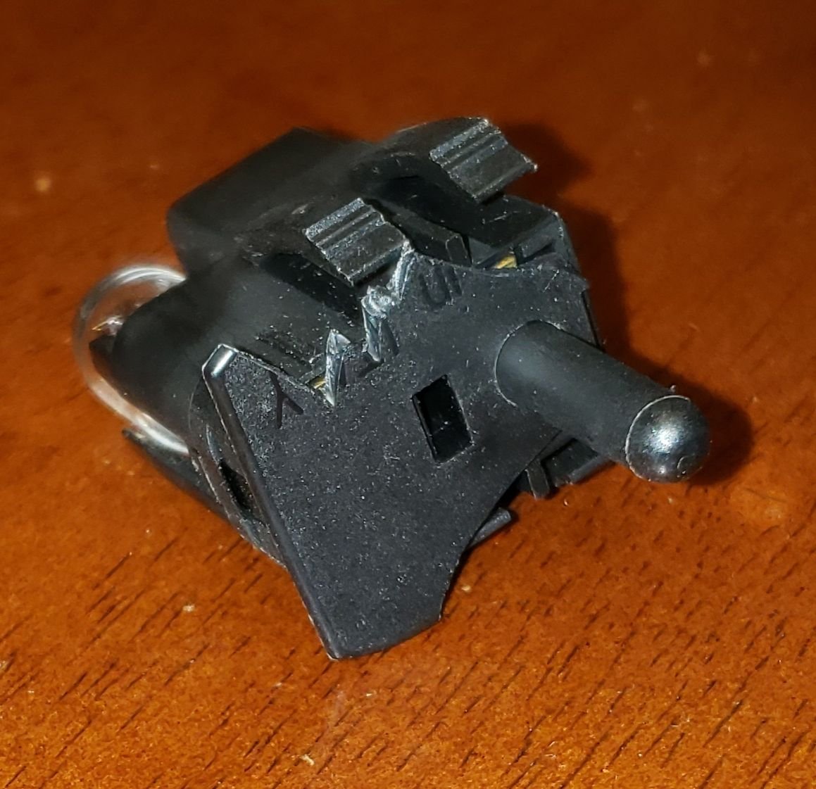

My battery has been "iffy" for a while. Lots of challenges with poor starts, low power drains, "Stupid ovah heah" leaving on both the Bluetooth adapter and the OBD2 BT plugged in, etc.
I decided to see if my glovebox lamp was turning off. I cleared out my glovebox, put in my phone on "video selfie" mode and shut the door.
One minute later, I pulled it out, and discovered the whole video to be lit up - no way to do that unless the glovebox light isn't turning off.
So I was examining the switch, and noticed that it was moving around in the holder... a LOT. Then I looked closer and found that the face of it had shattered, and the switch was flopping around in the mount.
Now I need a new switch. Junkyard?
Now, I'm a naive little buffoon, but not even I can be fooled into thinking that one light is = the only problem. No, 23 year old sportscars are apt to throw you compound curves. I will be doing a parasitic draw test per the CF recommended procedure.

Try Ekler's. They have a lot of this kind of stuff in their catalog. Rock Auto may have it too. Junkyards aren't a bad place to look. Personally, I'd probably just not replace it and tuck the plug back up into the dash.

Thought about this. The circuit needs to be open by having the switch pushed in to turn off the light. Technically I should probably reinstall the thing and screw in a flange to keep the switch in.

Or...remove the bulb. I just went on a spree of replacing all the incandescent bulbs I could find with LEDs. (There must be dozens in the cabin.) The glove box takes a 194. The LED uses so little juice that even if it stays on it should take weeks to have any effect on the battery. But removing the bulb, even if the circuit is closed, should leave you with no draw on that circuit.
