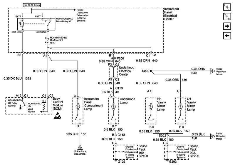

The body control module shuts things off that are on after about 15 minutes being idle. #25 feeds the body control module, one ignition circuit and instrument panel control. # 37, a relay, powers those things that should go off in 15 minutes.
I might start by replacing relay 37, easy and cheap. DO NOT stick anything conductive under the relay to pull it. Relay pullers are cheap.

Let me just add to the previous post this schematic showing what is controlled by Relay 37:
