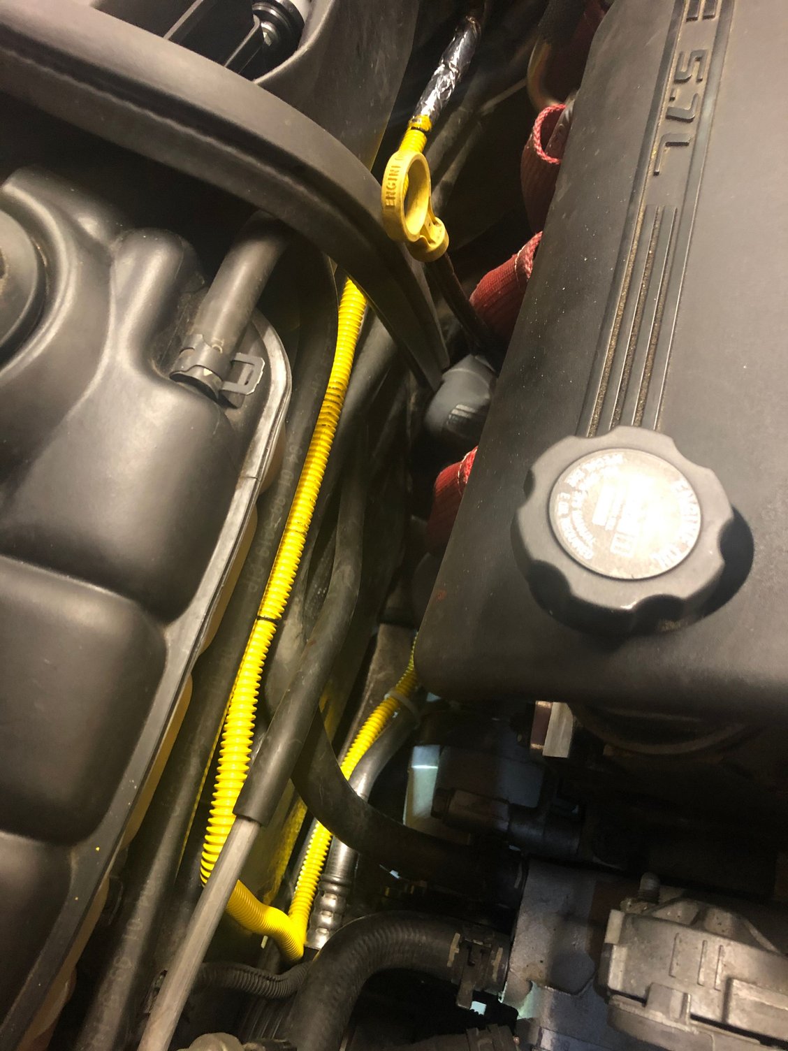

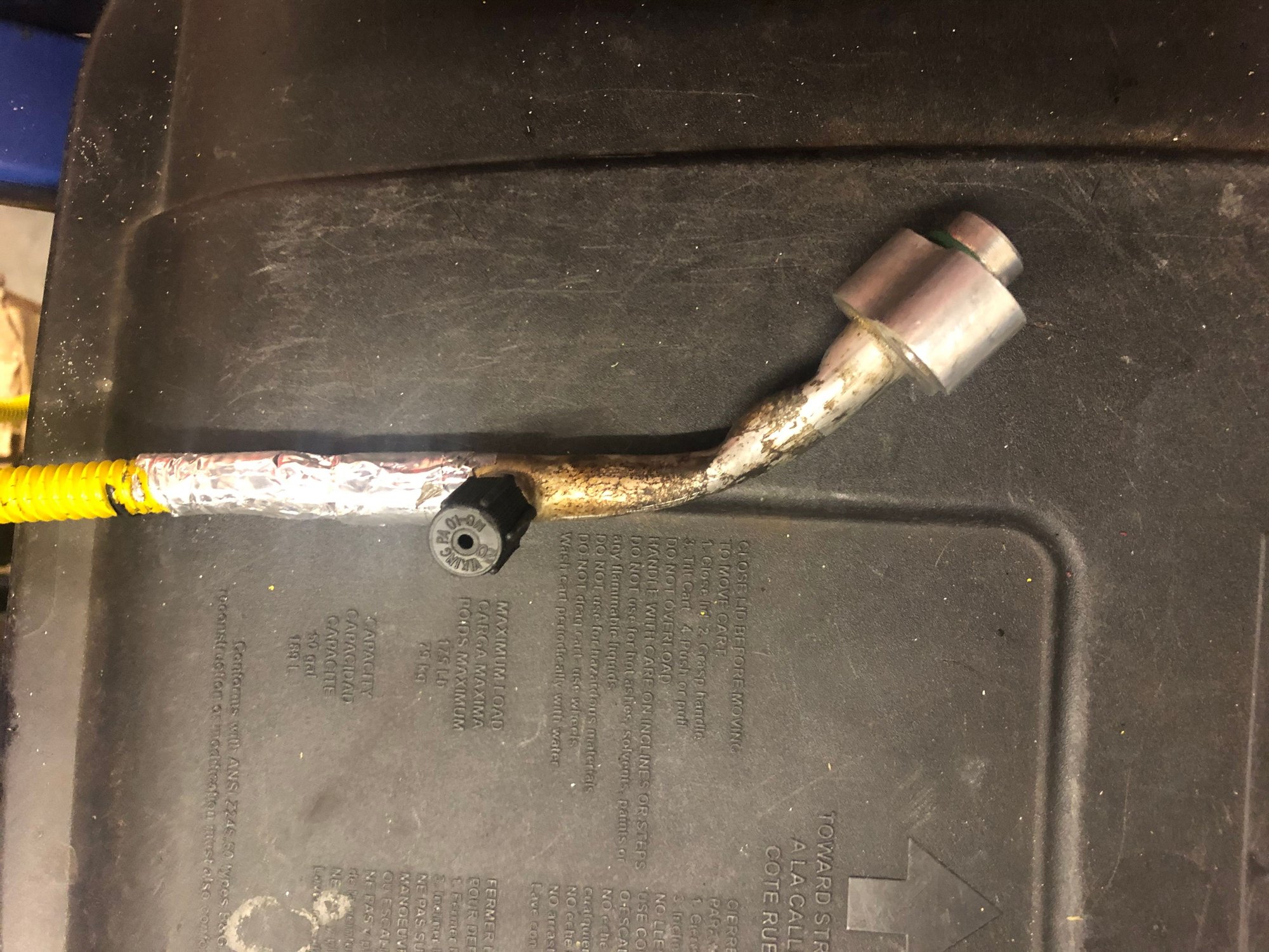

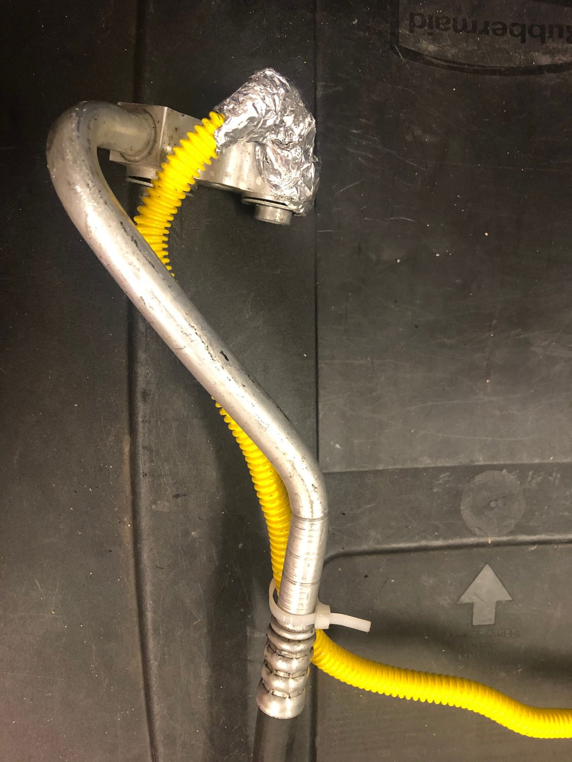

Wanted to put this out there for anyone having this problem. I inherited some huge XS power headers that burned through my old AC line in a heartbeat. It also burned through the replacement.
I used some metal wire to estimate how long of a custom flex line I would need cut into my new (but burned through) line and took it to a local shop that made it for 40 bucks. It now fits great and works.
This picture shows where the cuts were made and the approximate routing. I had them put in 3 feet exactly of flex line, a little more or a little less would also work. I also have a centri in the way and it fits around that as well. I did manage to accidentally unplug that front right wheel speed sensor on install, so look out for that.

Did you have any pressure problems with such a long rubber hose? Is the air cold enough?
Do you have a picture of the new line?
How long was the new section?
I’m so disappointed with the XPS headers, They have given me several problems besides the AC, I think dozens of people have had similar issues.’
I should have spent the extra $ and bought a reputable brand name header.
At any rates I’m on my third line, I’m fed up, need to re-route.
I was planning on having a custom shop replace the yellow part of my design with mostly aluminum and a small rubber section for some flexibility..
If your rubber replacement works fine I may just do that instead.

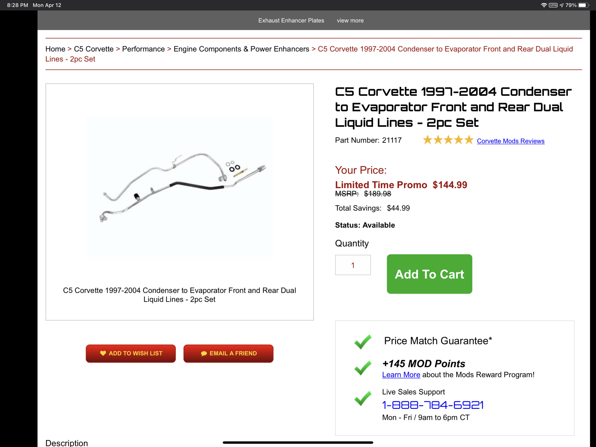

This set is actually a 2 piece replacement. I’m thinking it easier to install after mod’ get it.
Anyone have any opinion on these?
https://www.corvettemods.com/C5-Corv...t_p_21117.html
Old Apr 12, 2021 | 09:10 PM
Smoken1's Avatar
Smoken1
Joined: Apr 2013
Posts: 5,042
Likes: 1,157
From: Oregon
Careful, there's a lot of bad feedback about that company
https://www.corvetteforum.com/forums...emods-com.html

I should first mention, my problem is exasperated by my compressor being relocated lower on the passenger side to make room for the centrifugal.
I've had no problems at all, it's been ice cold ac since I did that fix. I get condensation on the outside of the car haha.
During my first hose change I put on the newer version compressor (V7?). I've tracked the car last summer and was able to run ac full blast.
I neglected to take a picture of the modified hose, but the guys put in a 36in. rubber hose section exactly where I have it marked in the drawing.
The hose is the same kind of flex hose that was in the section that was getting melted.
If I did it again, I would make a slight adjustment and see if they can get the flex hose even closer to the compressor connection. This is because the only real difficult part was getting the connector on with the subframe getting in the way since the hose now bends down and forward. If I remember correctly, I had to take the compressor back off, connect the new line then re-mount the compressor.

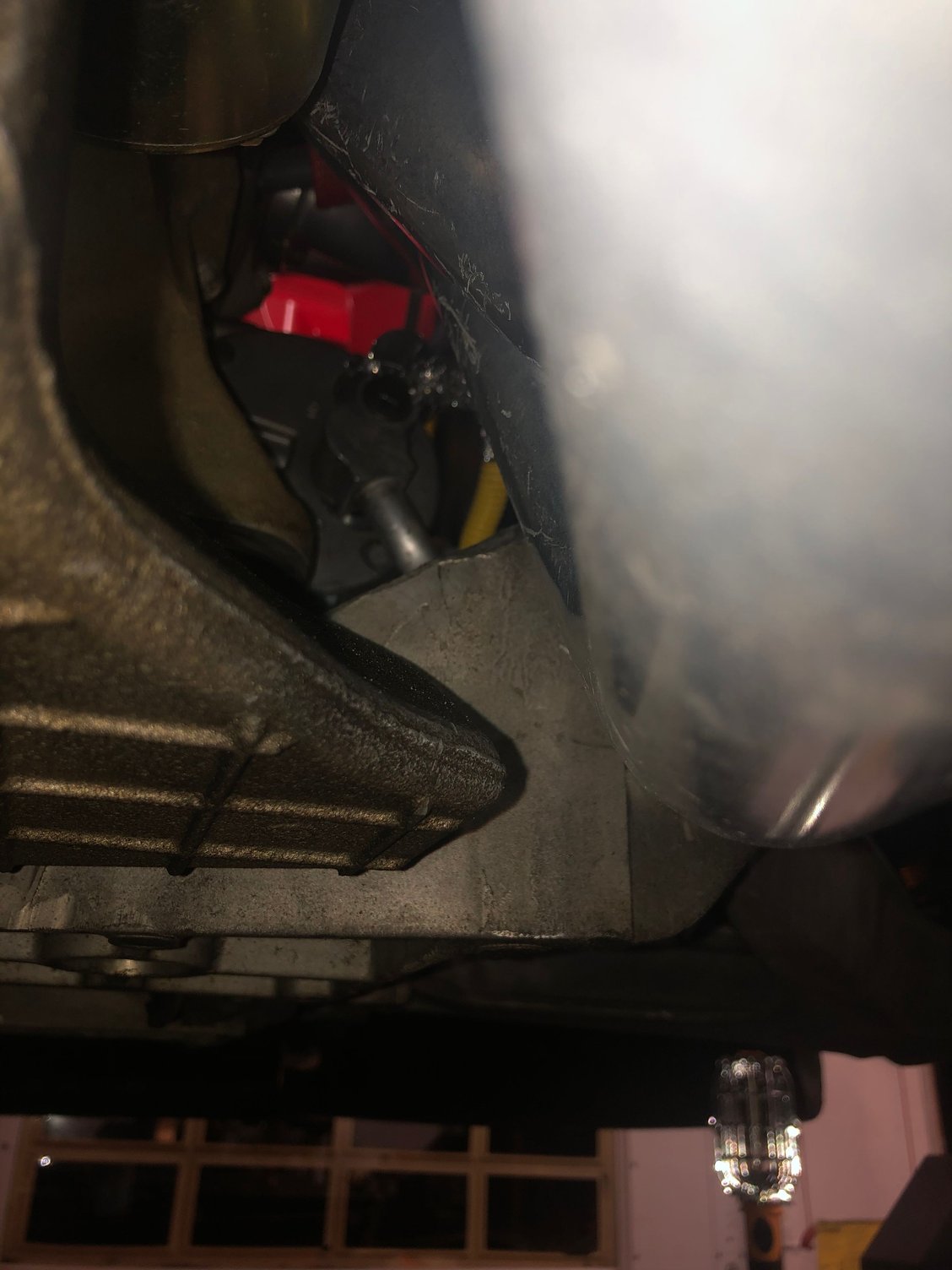

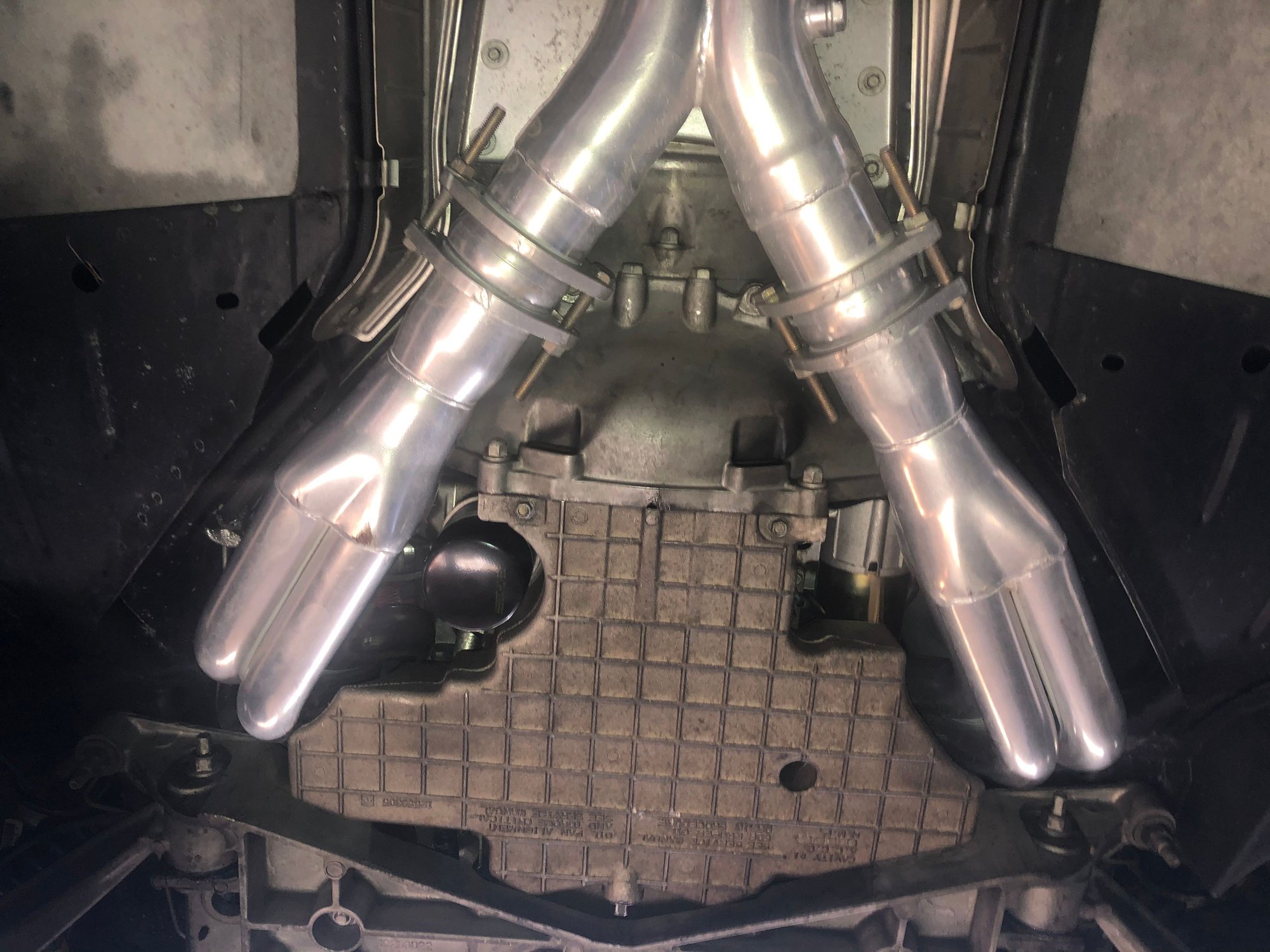

These pics show how badly formed the XPS HEADERS are. Driver side was to kissing the oil pan, I had to remove 1/8” from the oil pan corner.
passenger side so far away a from the oil pan, it causes header to kiss then AC line. Headers are so off normal manufacturing tolerances makes me think there was no QC before they shipped.

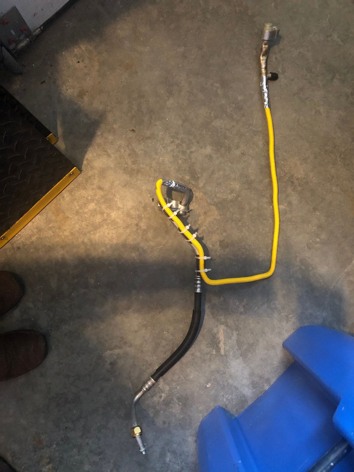

The modified proto would not clear the headers to to AC ports, I removed the passenger from wheel and was able to jimmy it through the passage way on the frame to the inside of the engine bay. I fished in the front line first then fished in the rear line then the block. I fastened all three AC line points to the accumulator, AC compressor ports and the front condenser. Looks like a good fit. The only issue is I was planning on have a 2x 90 degree aluminum tube to get the vertical part of the line by the fender but while installing, I had to bend the rear line quite a bit to get it in and I’m not sure if it will get in with the 2x 90’s. So I may just add about 15” of rubber that will lead the bottom line all the way to the radiator so I can get a smooth curve on the return over the fender to avoid kinks in the line.
Brett told the the 90 degree angles are small so maybe I they will work. I’ll ask for some pix to determine if viable,
The last picture, I bent the tube near the accumulator about 1.5 “ towards the frame. This makes it a straight line to the front and also allows clearance if you need to work on spark plugs or header flange gasket, etc

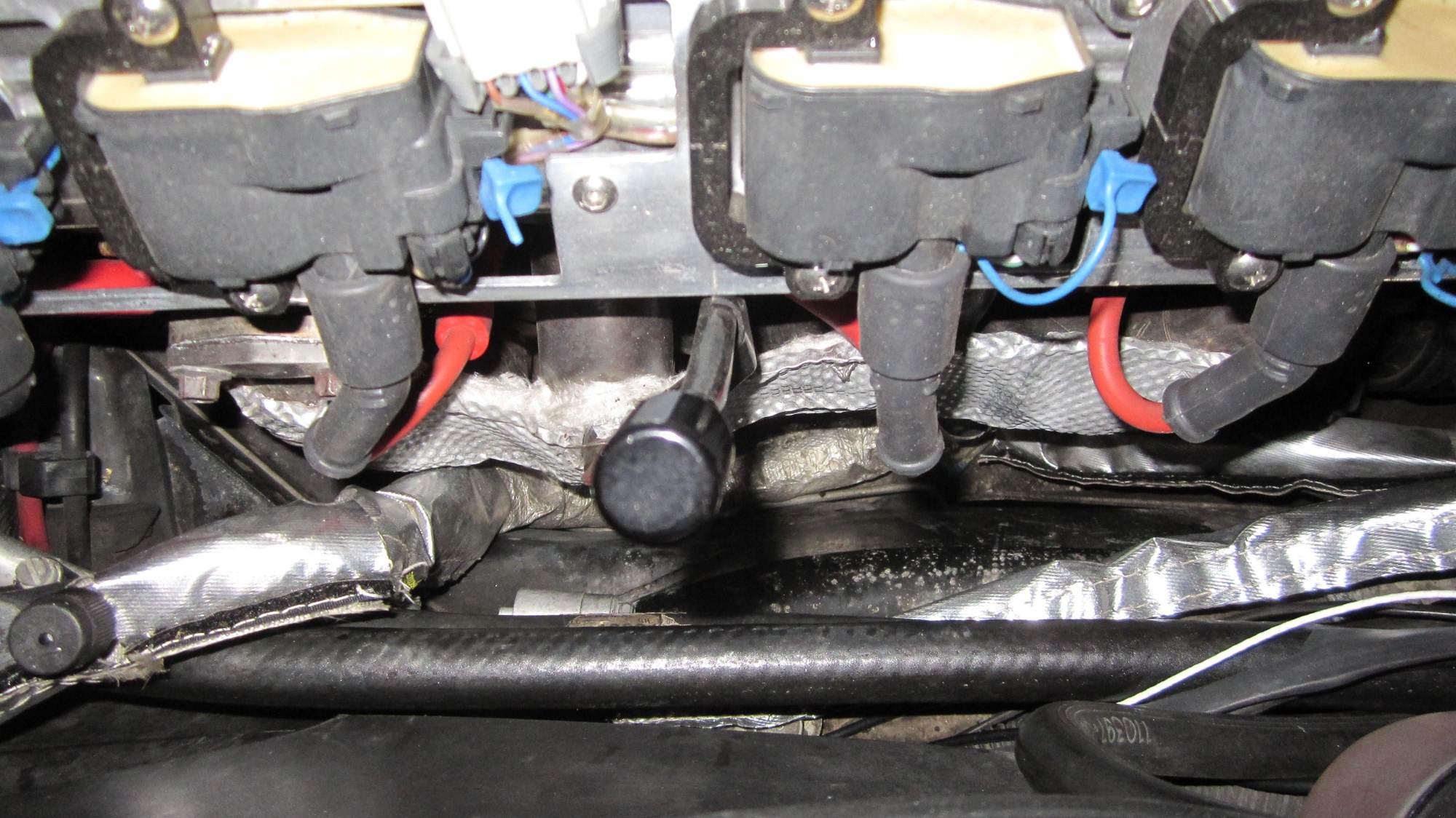

I had enough room to add some heat barrier insulation from Heatshield Products between the header and A/C hoses, some of their hose insulation was put around the A/C lines in that area for more heat protection. These aren't XS headers though.
To 2002 C5Z AC Hose mod - Headers too big

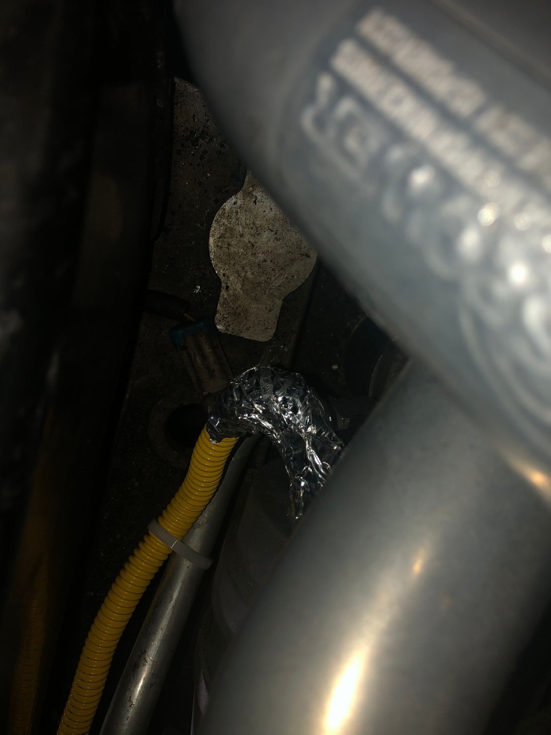

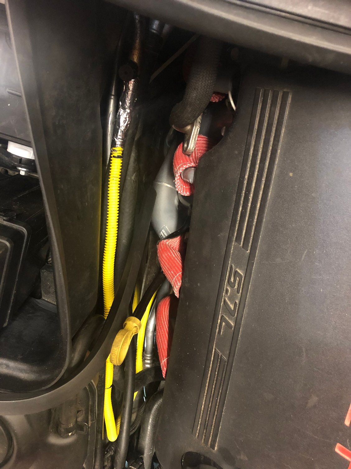

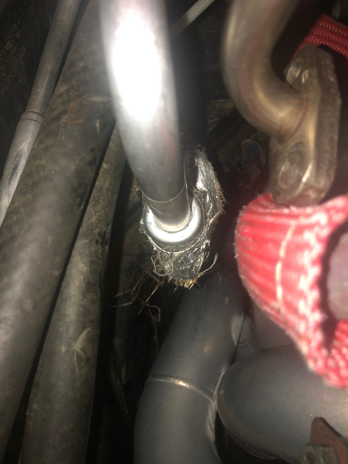

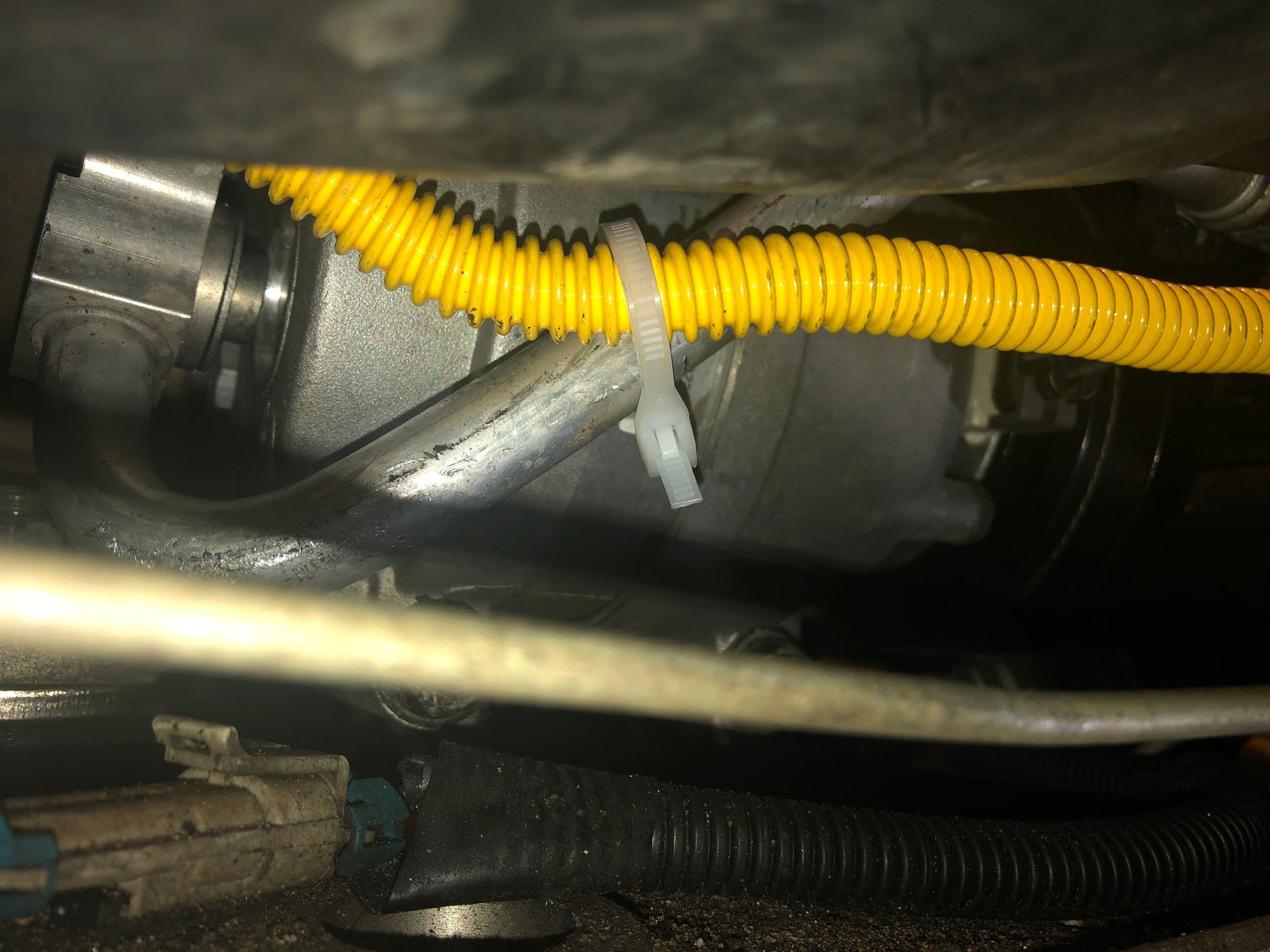

Sorry for the delay - hopefully this helps make sense.
At the accumulator - you can see the tig weld of one end of the modded section.
As it travels forward - towards the back of the centrifugal.
Heres where it turns down towards the compressor. Just forward of the dip stick and oil fill for reference.
Looking straight down - the hose snakes under the side of the compressor makes a bit of a loop, then meets the connector at the back.

Thanks for the pix. Looks good.
I was worried about kinks in the line when the line curves down to the compressor. But looks like you didn’t have any issues. I’m planning on installing A&A supercharger in May. If I go with a longer line (to avoid kinks) , is there enough clearance beneath and to the right of blower bracket to return to accumulator?
If you get the cut the line on the compressor side as close as possible to the connector it will have even more room for the curve than I did. Yes, in the final picture, the bracket to the right is my supercharger bracket.
Here, I marked it in red.
