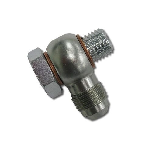

There are a couple ways to cap the lines to prevent the fluid from draining while the calipers are removed. I personally just found some spare bolts laying around that fit the banjo fittings and used them to clamp the original copper washers in place like this.
You could also try what this guy does.

You know lots of people have recommended the Doug Rippie lines because of their AN style fittings vs the banjo bolts on the Goodridge lines which is what I was originally going to get. Why does everyone rave about the AN fittings? Why are these better than banjo fittings?
