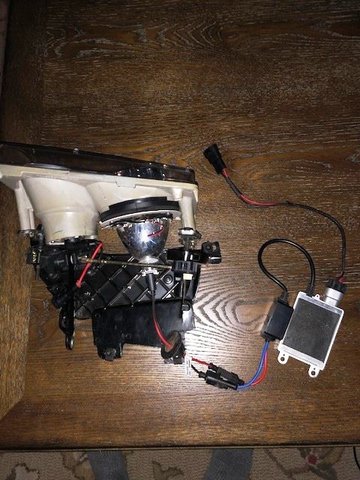

I finally got around to installing the patch for my headlights and noticed that the low beam on the drivers side was not on. I took the light out and found two wires were detached and I can not figure out where they came from. I have studied the installation guide on the Radioflyer website with no luck. Any help would be appreciated.
Bottom view. Note the loose wires from the projector.

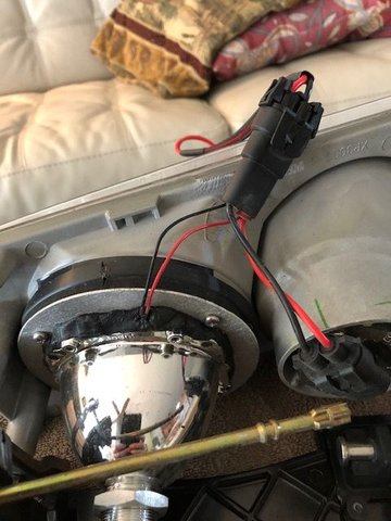

The red and black wires from the projector are detached.

I got it. I removed the passenger side headlight and found that the black and red wires had pulled out from the LED connector. Made the wire splice and should be good to go.
