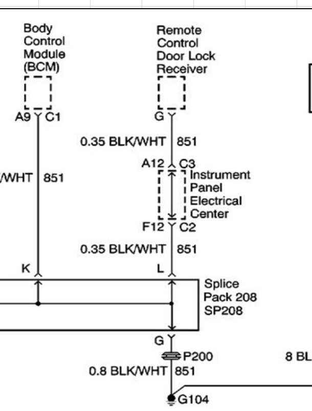

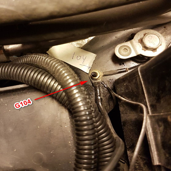

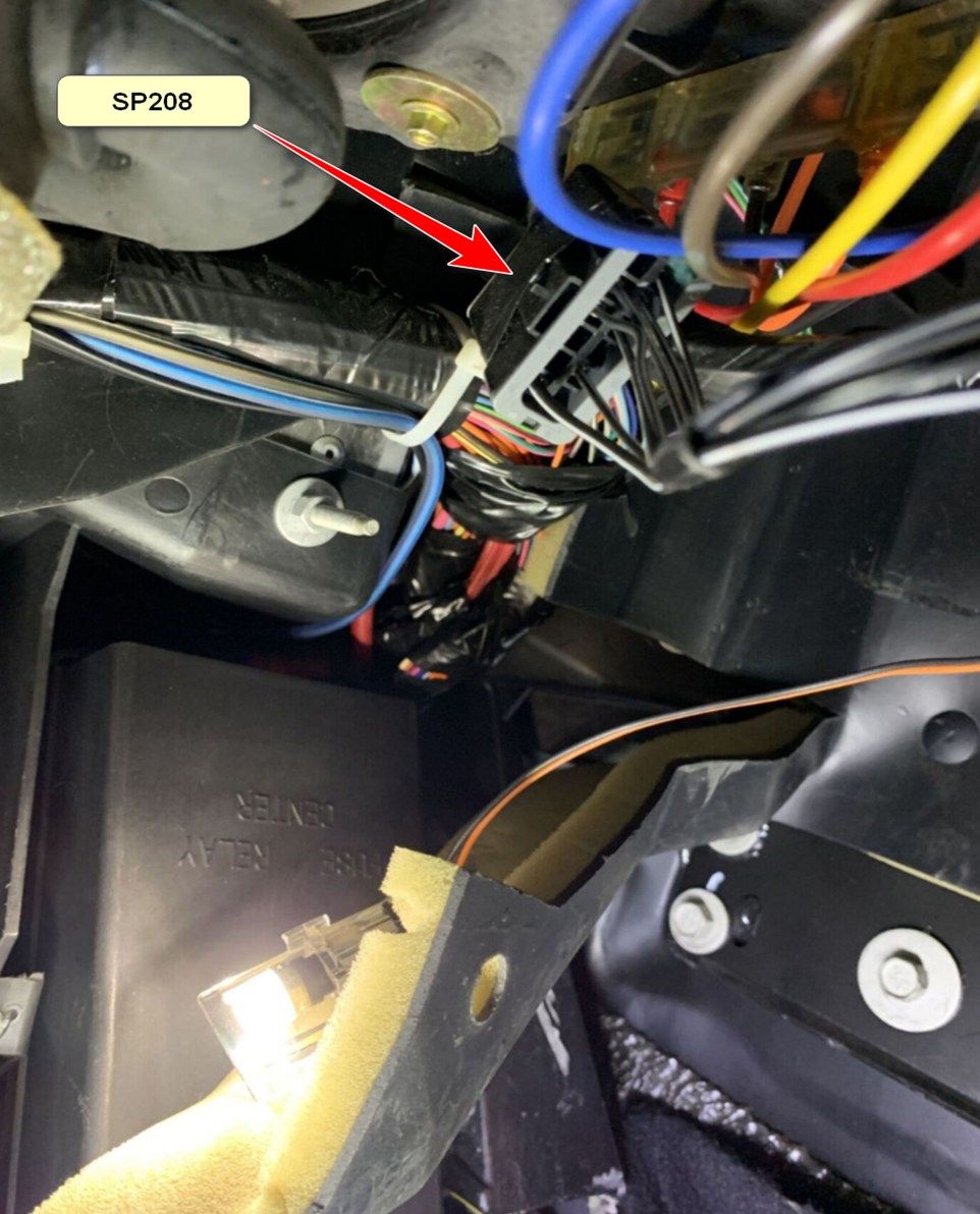

Your FOB and TMPS is "speaking" to the Remote Control Door Lock Receiver . This unit is speaking to the BCM using the serial line .
Both units are connected to the splicepoint SP208 . SP208 is connected to ground G104.
SP108 is located above the BCM as shown in the photo below.
I don't think the BCM is causing these problems

oelarse, Thank you for the response. G104 was good, I will have to find and check SP 208

Maybe with the G104 ground being close to the headers there might be enough heat expansion to interrupt the ground, but I do not know how to check that.
