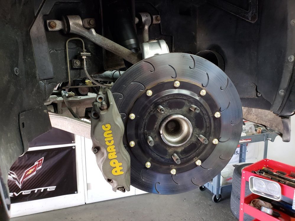

Hey guys, I had AP Racing burnish the rotors for me when I bought them (it is service they offer) and they shipped their best “street pad” for installation.
Problem is the super high pitch squeal whenever I bring the car to a stop.
Super embarrassing!
Anyway, I have to bring the car to AHP To get my oil changed (first oil change post engine build) soooo...what is the absolute quietest pad that you guys are running these days ?
