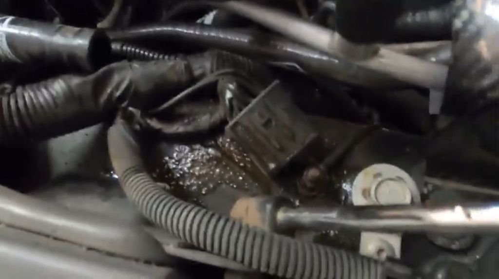

Old May 22, 2020 | 05:15 AM
mstromquist's Avatar
mstromquist
Joined: Jun 2007
Posts: 7,430
Likes: 4,829
From: BEST Corn-Nation
2015 C5 of the Year Winner
I had the same issue just a couple weeks ago. My tank was leaking from the bottom tube facing aft. The plastic had deteriorated enough to allow a small leak and it was pooling up on the top of the frame. Then running down onto some wiring cover. Never really saw anything on the ground and when I took the tank loose I saw the evidence under it. If your tank is around 10 years old or so my bet is it's the tanks.
