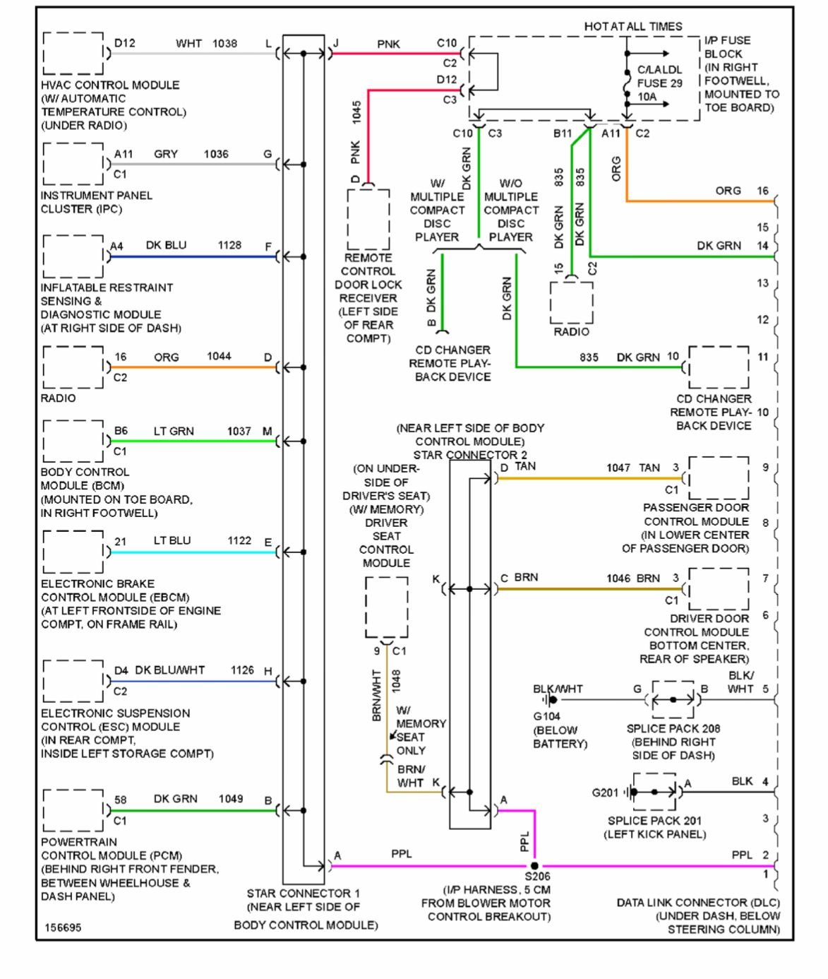

I would check the star connection #1 in passenger foot well. See wiring diagram...

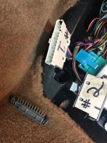

Thanks for the help. Pulled out and reseated plugs did all of them. Pushed and wiggled also but still not working.
