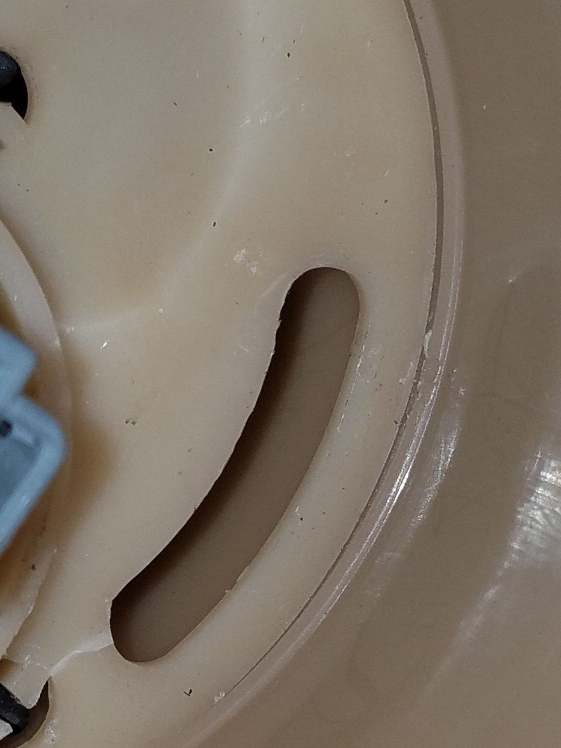

Thx neutron82, yes this is excaly where im at. I can't get the pump out. I still don;t understand the last part. Ill show picture and tell me what to press down.

put a hook tool in that big slot and another in one of the small holes if you have one that will fit and pull up, if you were pushing down that's why it won't come off
Check out the lip. It will not get pass that it's like a 1/32 lip how can it pass that lip??

face the hook more towards the center of that piece, you don't have to pull it from the edge it just needs some upward pressure to release it

Update, there must be something wrong with my canister. I ground down the lip and pulled the handle off the orange pick im using so back to harbor freight to get a new and continue to try but i think it's a losing battle.

Well just bend the hooks straight. That's how much force im applying.

Im i missing somthing here?? Does the round pick up thing on the bottom has to come off? Or it's straightforward just pull one side at a time??
