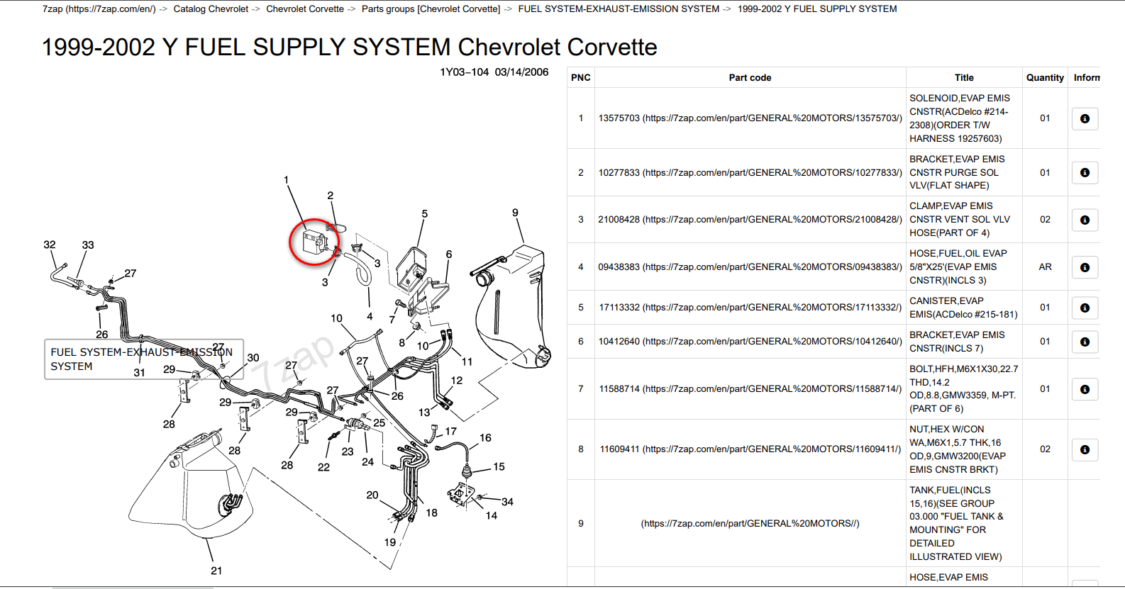

The vent vale is located in rear on right frame .
The photo shows the canister and the vent valve .
If you had a tech 2 it would be possible to monitor the tank pressure and at the same time open/close the vent valve from the Tech2 and check any pressure change
