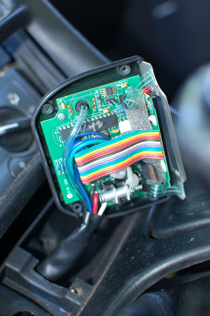

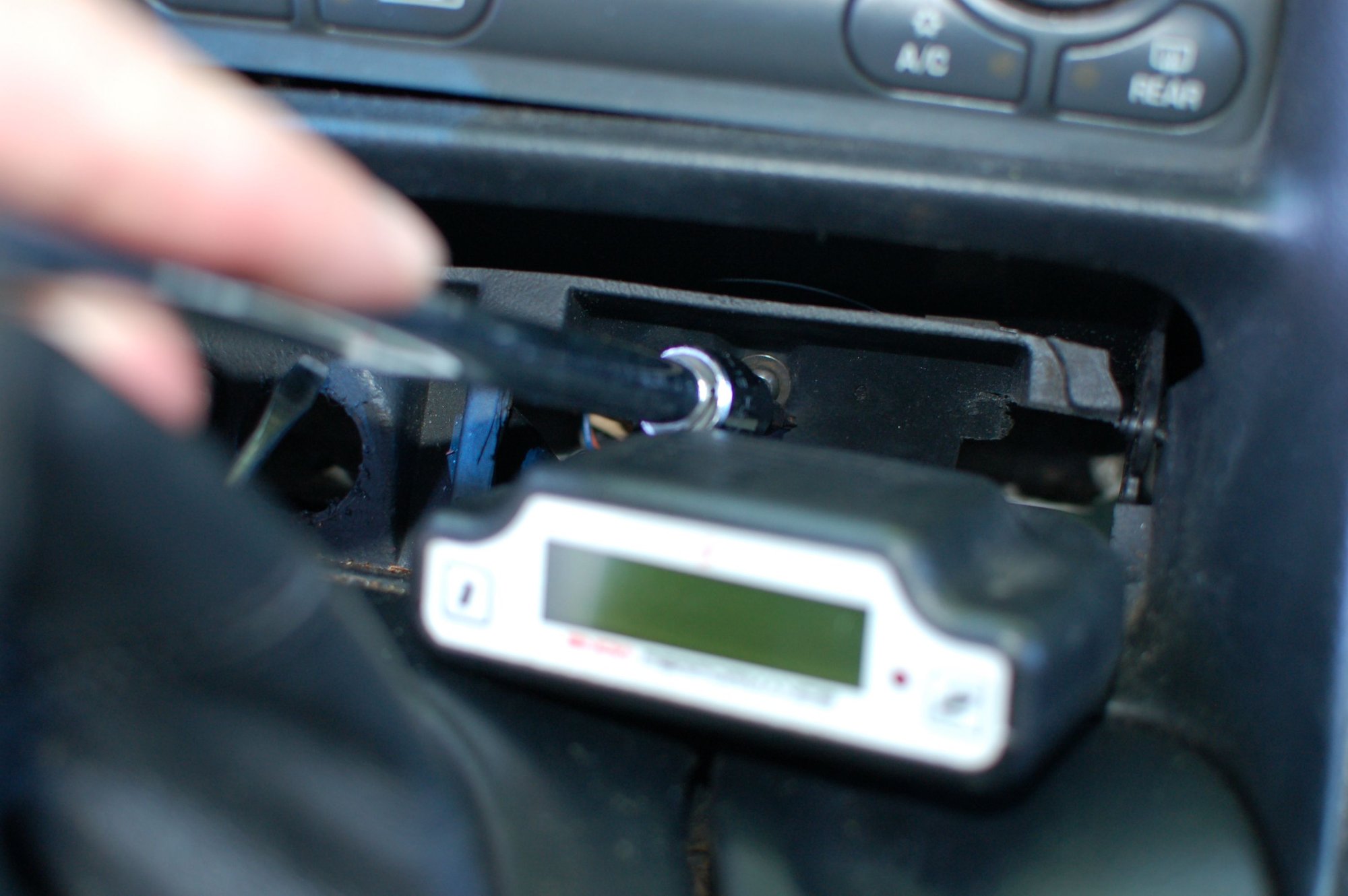

Hoping for any tips anyone has if they faced this same situation: previous owner put a boost controller into the ashtray. But they didn't put in any connectors, just cut a hole big enough to feed the wires through, but not big enough for the controller. Now the little bastard is blocking my attempt to remove the radio bezel. On top of that, there's two blue wires. So I'm going to put in a molex connector and a hose barb for the boost tube. I'm dreading that moment where I have to cut the wires. I'm also praying that the tube is a 1/8" inner diameter as that's the smallest barb I could get on Amazon.
I plan on tagging one blue wire on both sides of the cut. Any other tips before I get started? TIA.
