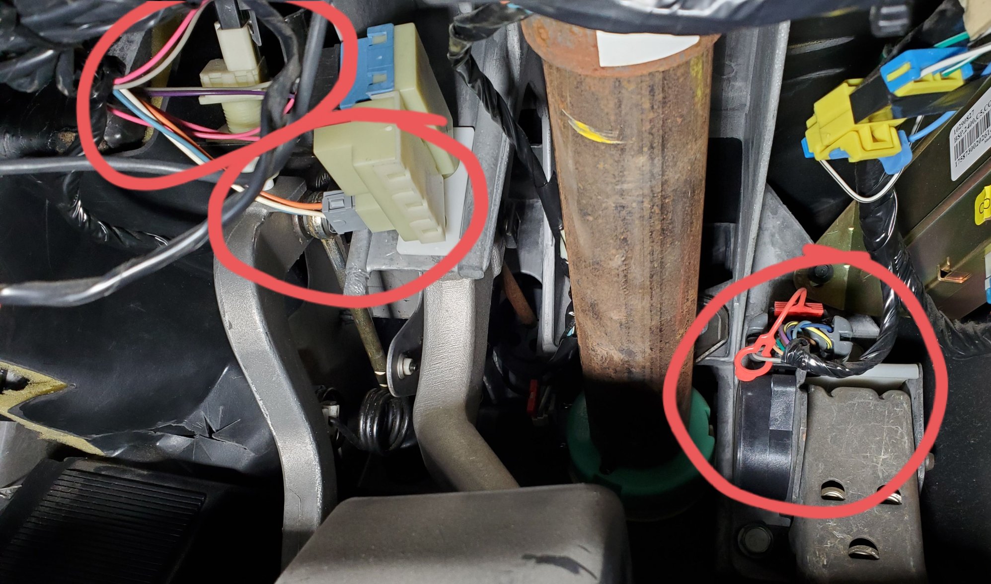

Is these the correct connections? Also, my obd doesn't have the red/ white wire. Do I tap into the orange wire on the obd? Thanks

Those look to be the correct connectors. I think I used the orange brake switch wire for power also because it is much easier to get to since you are already there. Unfortunately the car is far away at the moment else I could snap pics of what exactly I did.

Thanks for you help. The instruction on autoblip is misleading.

Agree on the power connection. They should just say use the brake switch orange wire. It is much easier anyway. Good luck. I really like mine when I'm on the track.

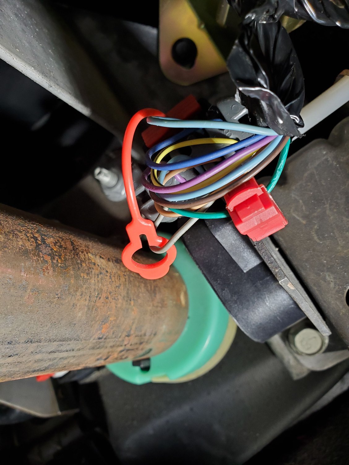

On the throttle position, which light blue wire did you tap into?

I don't remember there being two lt blue wires. According to the pin out the one you want should be near the tan and ppl wires. Seems to be the lower one in your picture.

Thanks so much for your assistance. Done and it work great.
