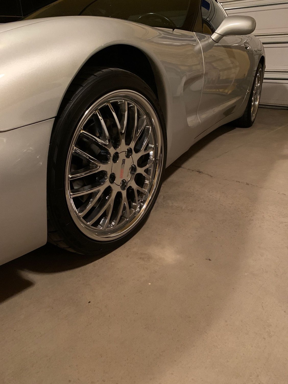

I recently bought a 02 coupe and I want to lower it. It has a nice set of 19/20" Cray wheels and the fender gap is like a 4wd... Anyway I jacked up the front. took off the wheel and then jacked up the leaf spring. The bolt is completely seized. So much so that now the head is rounded off... I soaked it with WD40 and still nothing. I know I can buy new bolts but what would be the recommended method of getting the existing bolts out?
Picture of the fender gap.
