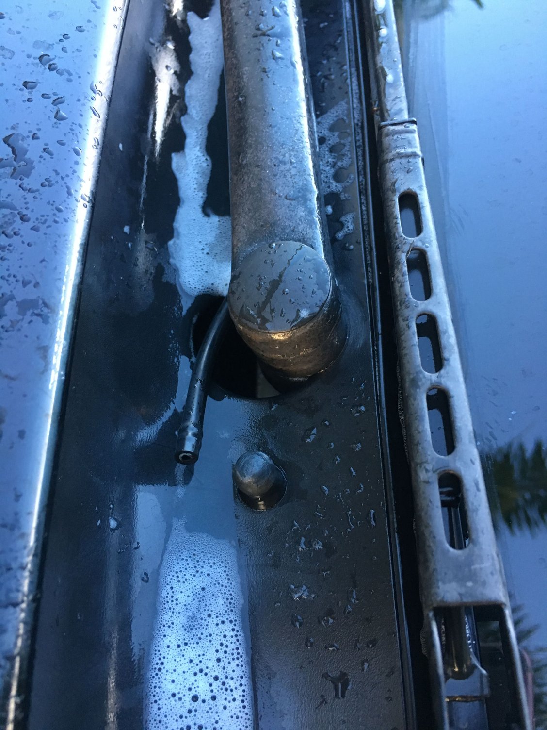

thanks dude. Would you happen to know what this little plastic round ball that feeds the washer fluid to the washer arms is called? Mine just dry rotted broke off when I barely twisted it.
What’s that little round ball part called that feeds the washer fluid to the wiper arm via the rubber hose? Anyone? Mine just broke off!

Originally Posted by mbella2000
Wow thanks for the quick reply. Ok thanks brotha.. Does it just snap in place? Is there some kind of bolt or grommet that holds it in? Peace
The pump is held in with a grommet and pulls right out. You have to disconnect the electrical connector. As for that little plastic piece, I think you will have to buy the "washer hose assembly." Try RockAuto.com or one of the forum vendors.
thats a windshield washer nozel. They are very brittle. Unfortunately they are discontinued and no aftermarket. You’ll have to look at junk yards for a replacement.
Ok thank you. Yea mine dry rotted when I turned it yesterday after messing with the washer fluid bottle motor. I saw them on ebay for the c4 for $24 used but damn.. Ok Ill try the forum or rig in my own . Thanks for the reply.
