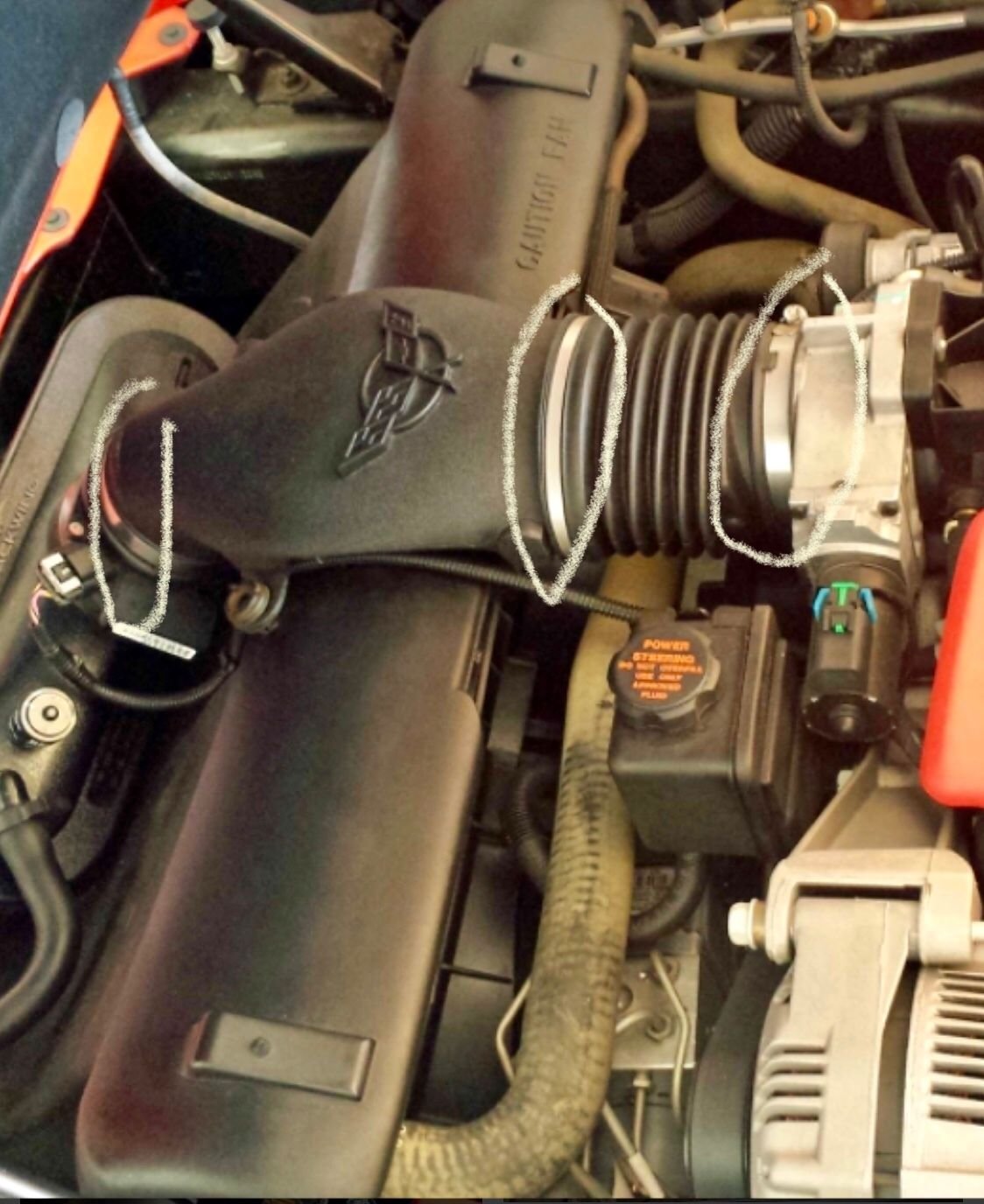

Normally the air bridge between the MAF and TB is removed during pump replacement...sounds like a vacuum leak between the 2 especially with that high idle !!

Maf & tb??

Yes !!...MAF and TB !!...areas circled in white...look there !!

So what should I be looking for?

Loose clamp or maybe the rubber boot may be torn...make sure the boot is on securely !!...is not this I would suggest taking your car to a good diagnostic shop !!...I’m only guessing here and I don’t like to guess diagnosing Corvettes !!

I shot some starter fluid - no rpm change - anymore suggests?
