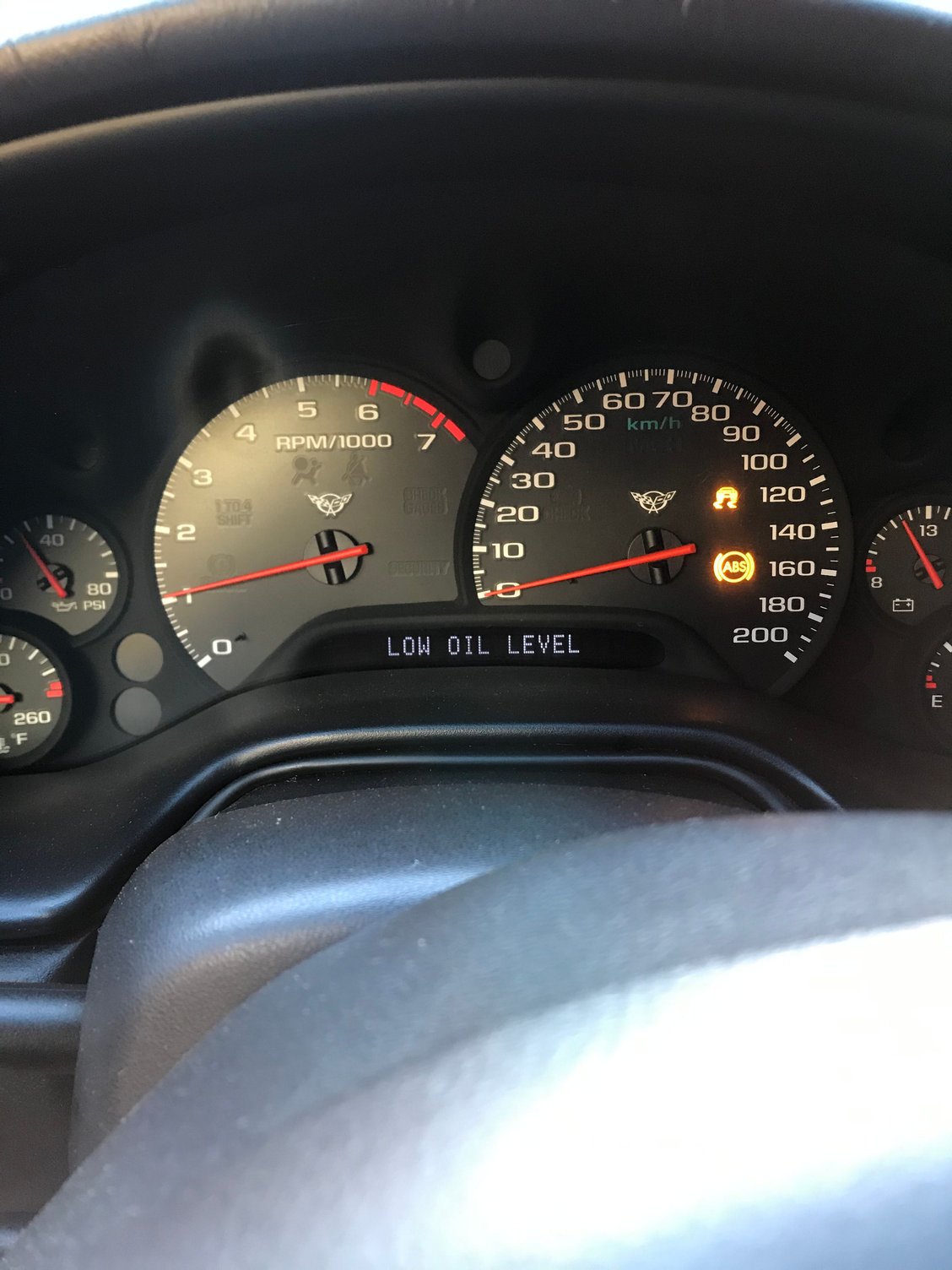

I have never seen this light before, I JUST had this engine spec’d and built for me, it was broken in on the dyno with a carb (700hp) and then they tuned it with the MSD Intake, fuel injection, etc...and delivered to me in March I think. Build in Sig.
I appear to have no oil 900 miles later (?!). I have zero oil leaks and my catch can was maybe 1/3 filled when I checked it.
What are the parameters for the “Low Oil Light” indicator ? Should I just send it back to the shop ?
I was supposed to take it to a fishing trip July 4th weekend and I am now totally up a creek on that and the shop can’t even get me back in to look at it until late July. They did the build so I am kind of over a barrel and cannot take it elsewhere.

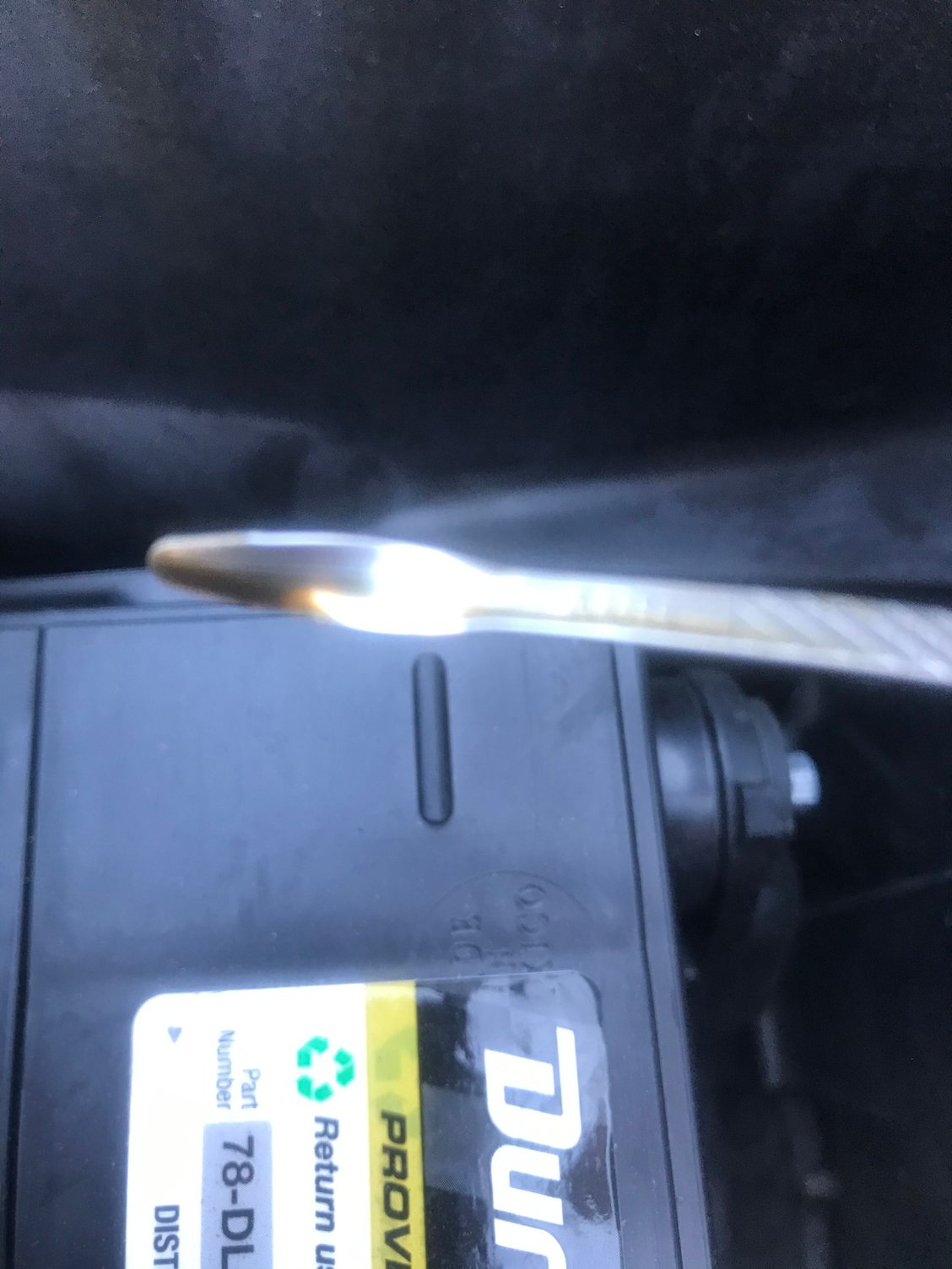

Below is a pic of my dipstick post removal.

Who filled it initially? Did you check it before? Wondering if enough oil wasn't put in to start with.
Do you have smoke out the exhaust?

Yes it smokes a ridiculous amount when I cold start it but not when I run it.
Here is what I get when I check the oil....

New engine build...maybe the rings did not seat properly and it's burning a lot of oil? A new engine *will* tend to burn some oil as the engine breaks in and rings continue to seat etc. My built motor had high blowby and it took maybe 1000 miles until it went to what I would call normal levels..ballpark numbers but you get the idea.
A few ways this could progress but either way get in touch with the shop. Get the dialogue going and ask them what you should do...follow their recommendations. That way in case the engine does need re-ringed or whatever, you have followed their guidance to a T and there won't be any disputes or conflict. Sometimes **** happens, get in touch with them and see where it goes.
But what they will probably say is, add oil and continue to monitor oil consumption. Check the oil regularly and note how much you have to add over 500 miles etc etc.
I didn't know these cars had oil level sensors, I see it still has oil pressure so motor is probably OK.
Smoking a bunch on cold start could maybe be the rings not sealing well when cold or maybe the valve seals leak....and a bunch of oil drips into the combustion chamber from the heads after you shut it off and let it sit overnight.

Nope, something is not right. I've seen many big cube N/A LSX builds without a trace of oil use.
