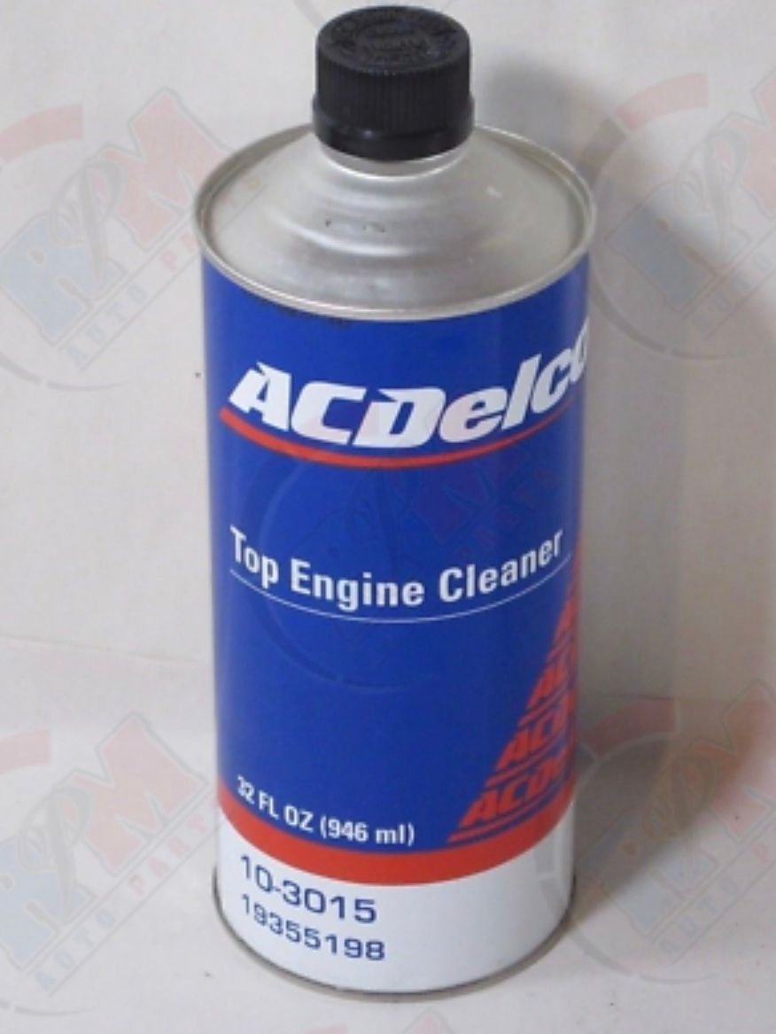

I'd recommend using GM Top Engine Cleaner to clean the top of the pistons and valves of carbon deposits...you can get misfires if those valves are all carboned up...the carbon acts like a sponge for the injected fuel and you’ll get lean misfires...this is even a TSB !!...I did my ‘01 last year with 2 cans !!
hey c5diag,
wjwre do you use this? In the gas tank with fill ups? Is this similar to Techron?

Was sprayed into the PCV vacuum line !!....Techron is more of a fuel injector and fuel level sensor cleaner.
https://static.nhtsa.gov/odi/tsbs/20...37635-9999.pdf
