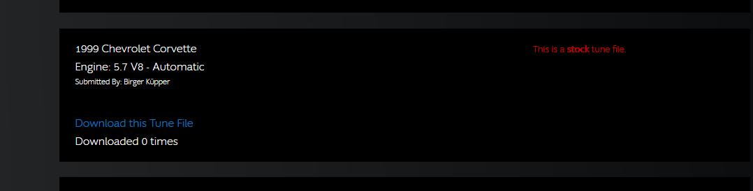

I'm in no way a skilled tuner at all, and am just getting my feet wet with HP Tuners. But if you can find someone around there with HP Tuners you can spend the $100 for the credits, pull a stock tune from the HPTuners repository, and upload it. If you like I can pull a tune off the repository and send it to ya, but you still need to get it uploaded with HP Tuner software.
File Type: hpt
