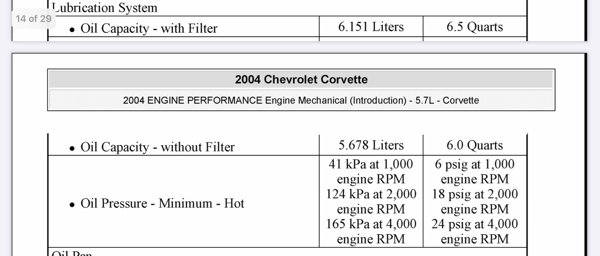

My oil pressure starts at zero on very cold day or sitting for a long time... I think your oil pressure are normal...
here are GM minimum oil pressure.

Holy crap, those minimum oil pressures from GM are REALLY LOW!! I guess we have a good buffer then.

6psi at idle!! Surely that's ridiculous and you'd have serious engine issues by that point?
