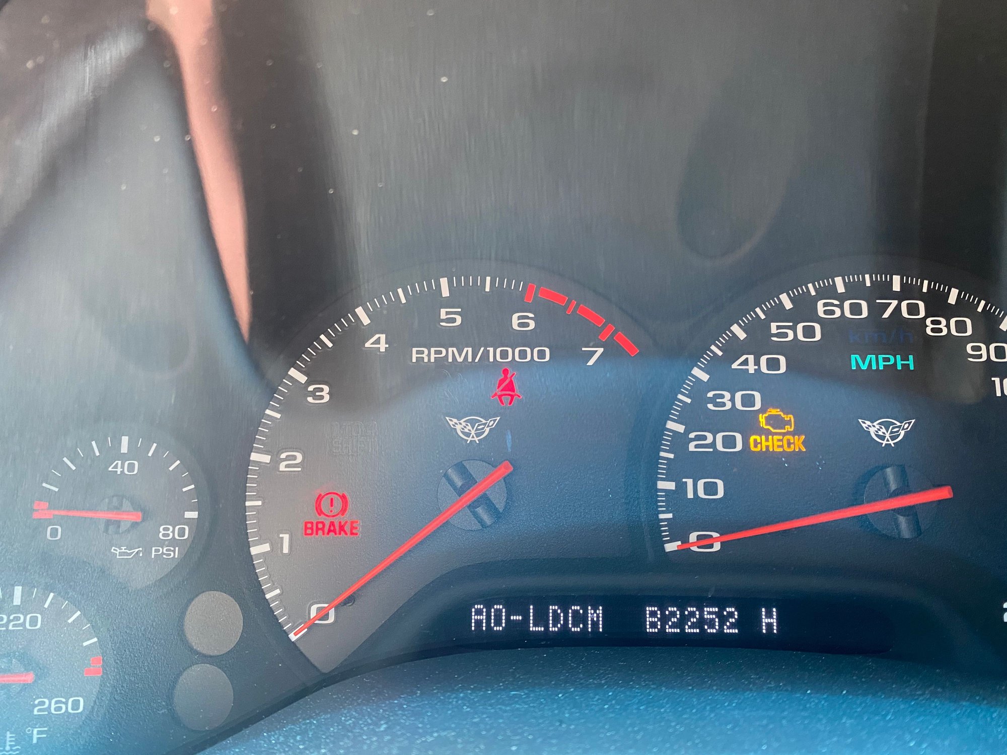

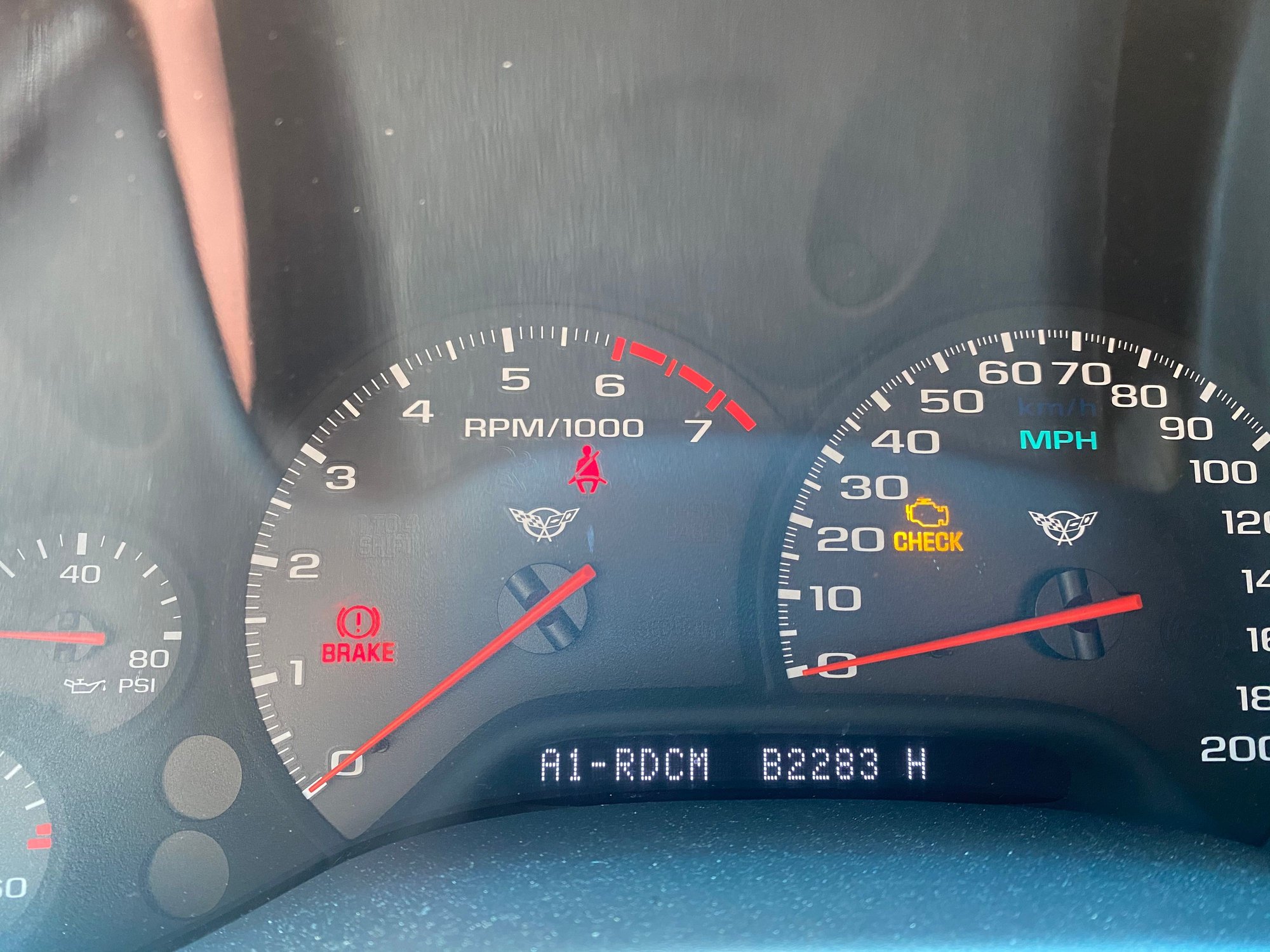

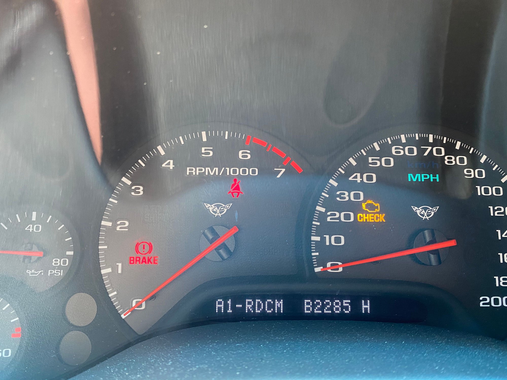

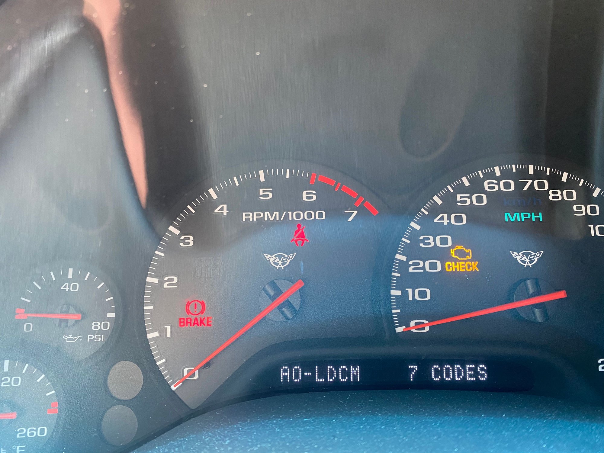

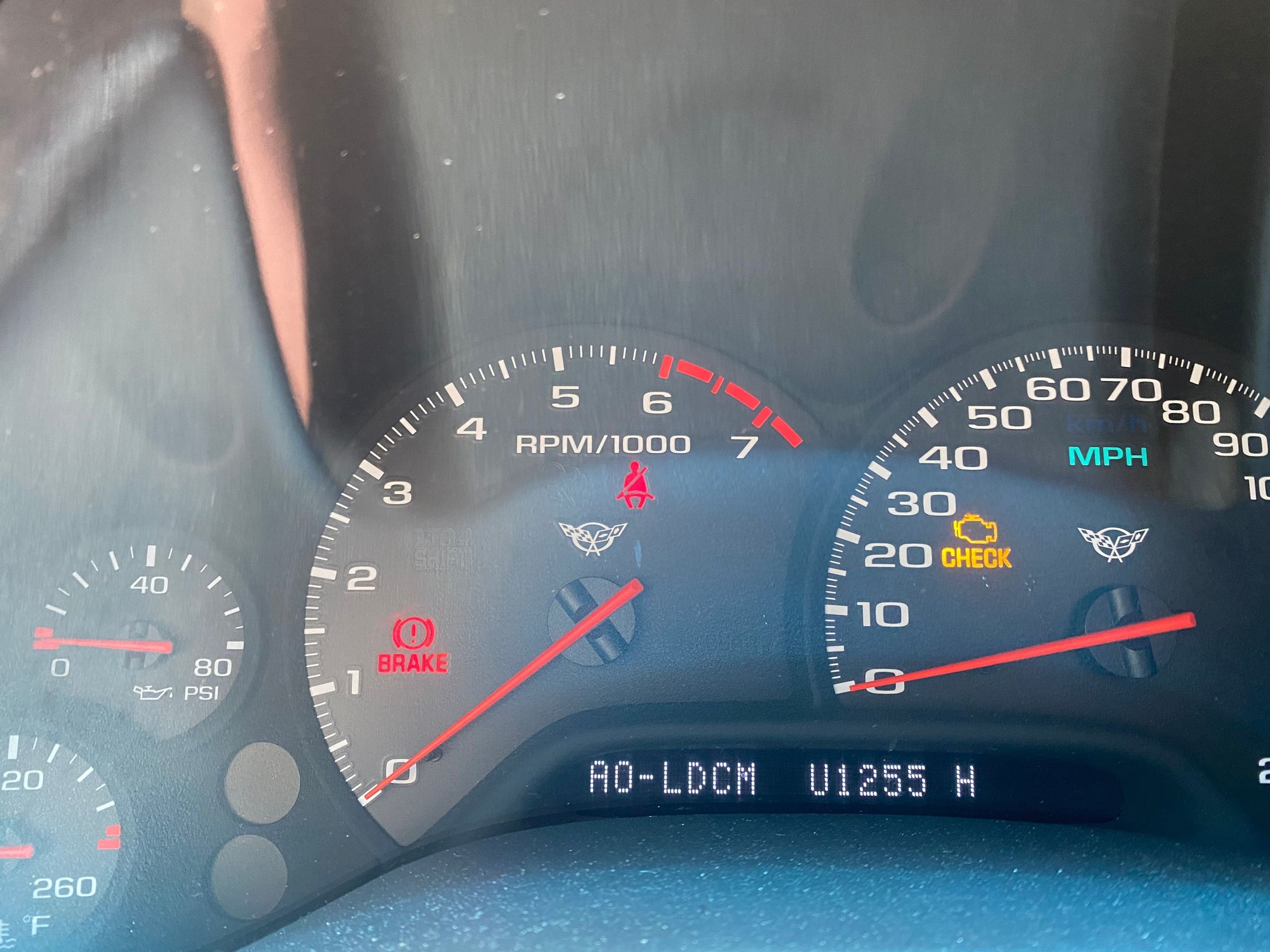

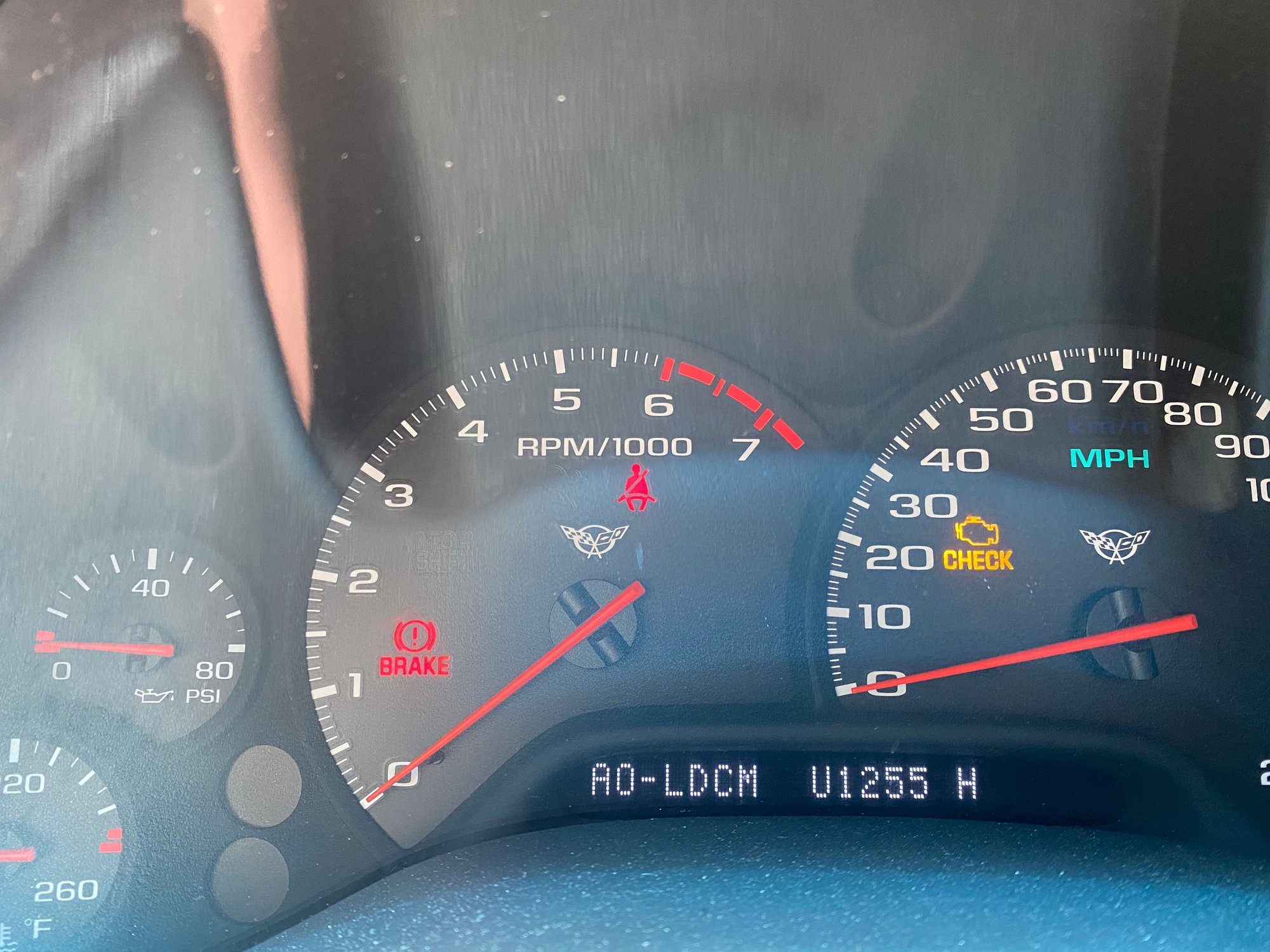

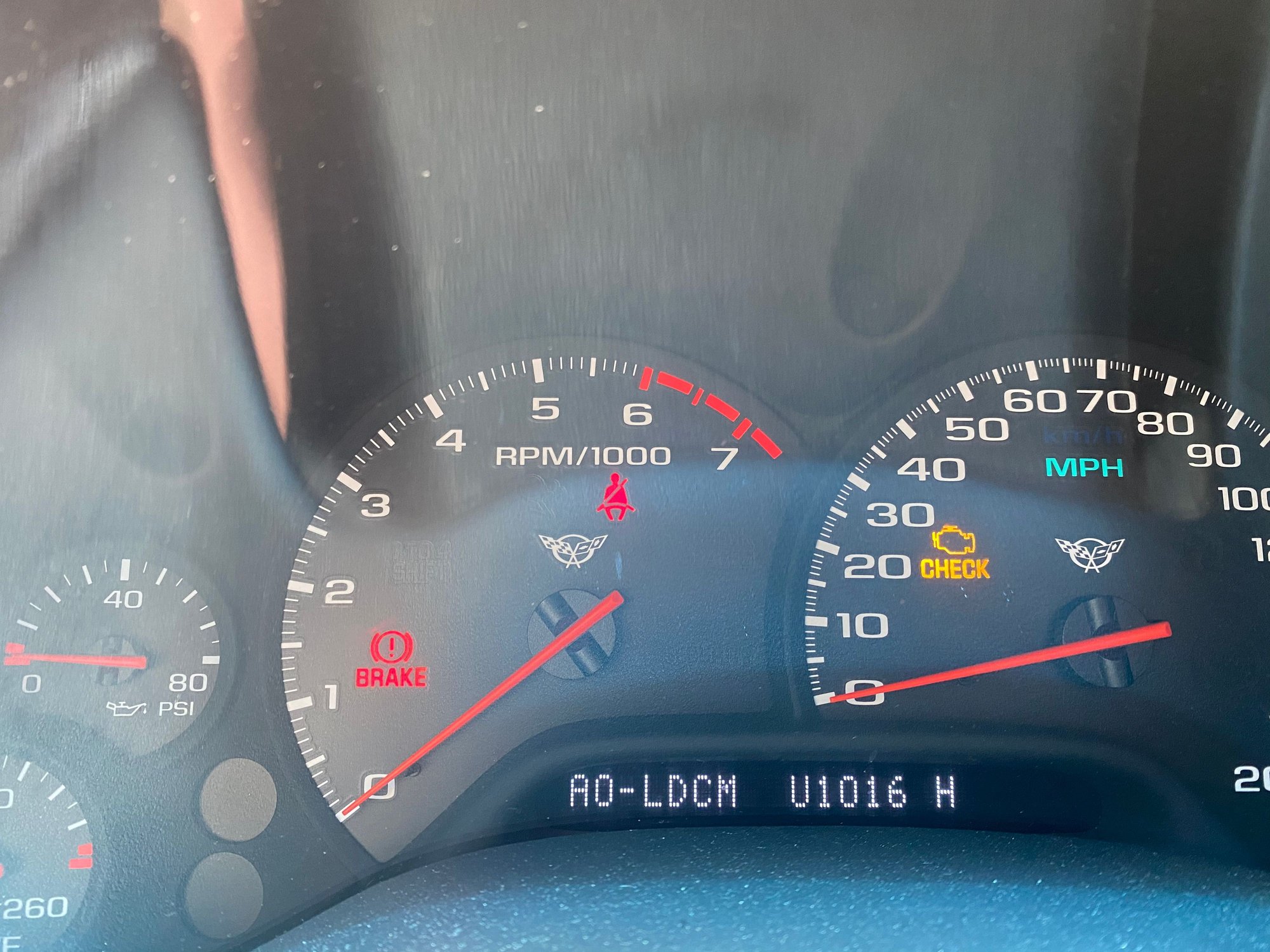

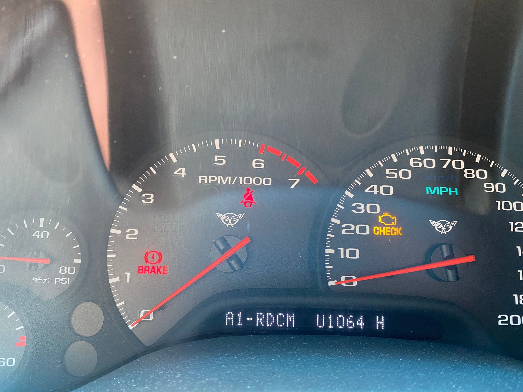

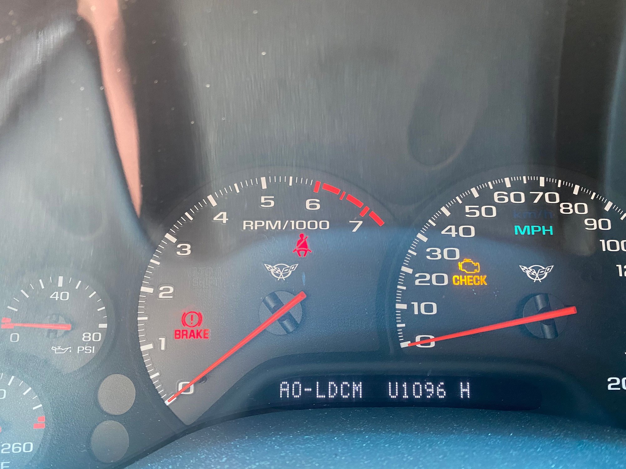

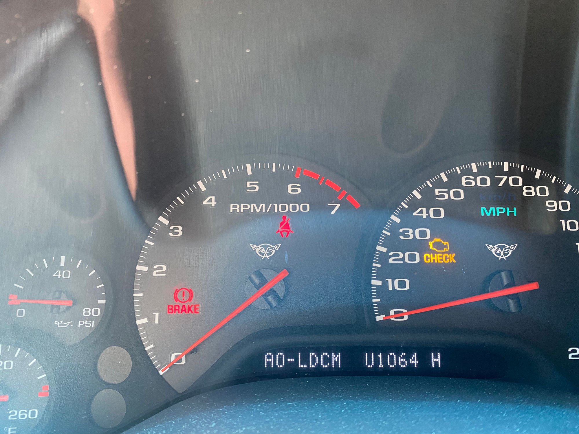

Hello, I hope someone will be able to help me with getting my c5 started. I’m 18 and the vette is my first car and I love it but it has a lot of starting issues. I’ve done two starters, along with the solenoid and I’ve done the clutch master cylinder twice. I pulled a bunch of codes out of the car from the options menu I’ll post them at the end. All the cars electrical works when I turn the key, lights interior lights and all I’ve tried jumping it, no luck also tried tapping the starter with a mallet and extender socket no luck again. I’m thinking it has to be something with the security system and if anyone could help with what I actually need to get done that would be great this way maybe I can do it myself or my mechanic can do it and not just keep replacing stuff for the heck of it. SEND HELP!!!
Photos of codes will be attached

The H at the end of all of those codes indicates they are History codes. Clear all the codes and see what comes back.
Also stop replacing parts until you figure out what is going on. Not sure why you would replace the clutch master cylinder for a no start problem or
was that for another reason??? When you put the key in the ignition does the "SECURITY" light go out?
