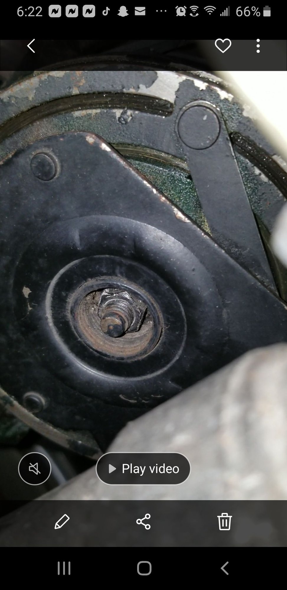

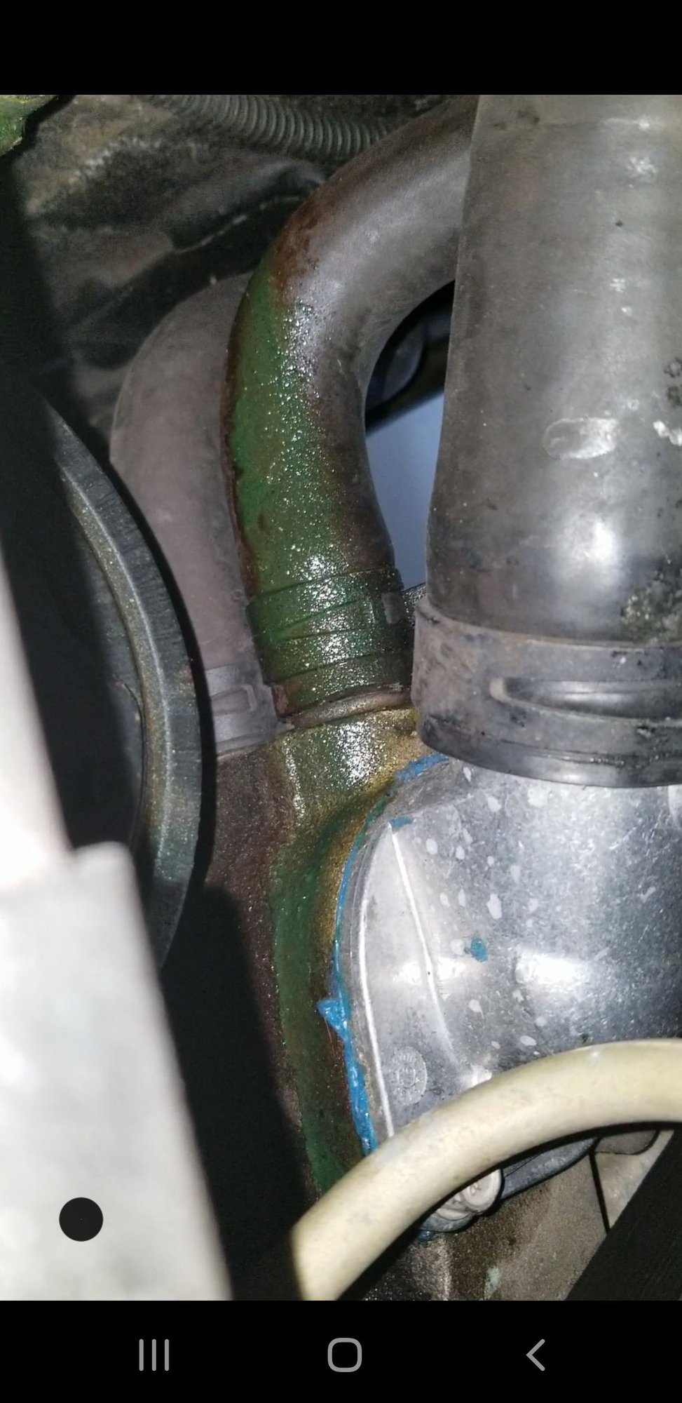

My 97 C5 few weeks ago was covered with green fluid on bottom of the top inlet water pump neck, compressor clutch, idler pulleys. I thought it was water pump thinking that green liquid is coolant but upon detailed inspection it was leaking from front of the compressor inside the ac clutch. I hooked up portable ac charge gauge after using the ac for a week. The ac hauage needle is at yellow which indicated ac is good no refill needed. My ac is currently working fine but i haven't visually inspected to see more leaked out. Oh also when i pushed in the ac clutch at the top it is tilting in so the clutch is loose and moving in and out. Can you conform leak is from cmpressor at front ? I'm guessing green liquid is theac comp. Oil?

GM/Delphi Compressor oil in 1997 definitely was not green. The factory oil is clear if I recall correctly and turns a little brown over time with use. I think you may have mentioned “dye” in an earlier posting. Typically dye for leak detection requires a black light to see it. Did someone put a leak detecting fluid in the a/c system that does not require a black light? If you were weeping compressor oil past the lip seal, I would expect to see a drop or 2 collecting at the bottom of the pulley face after the car sits for a day or 2.
what you are describing about the clutch “tilting” sounds normal. The clutch is separated from the pulley face by about 0.040” and suspended by 3 leaf springs. If you push it with a finger, it will move fairly easily until it contacts the pulley face.
