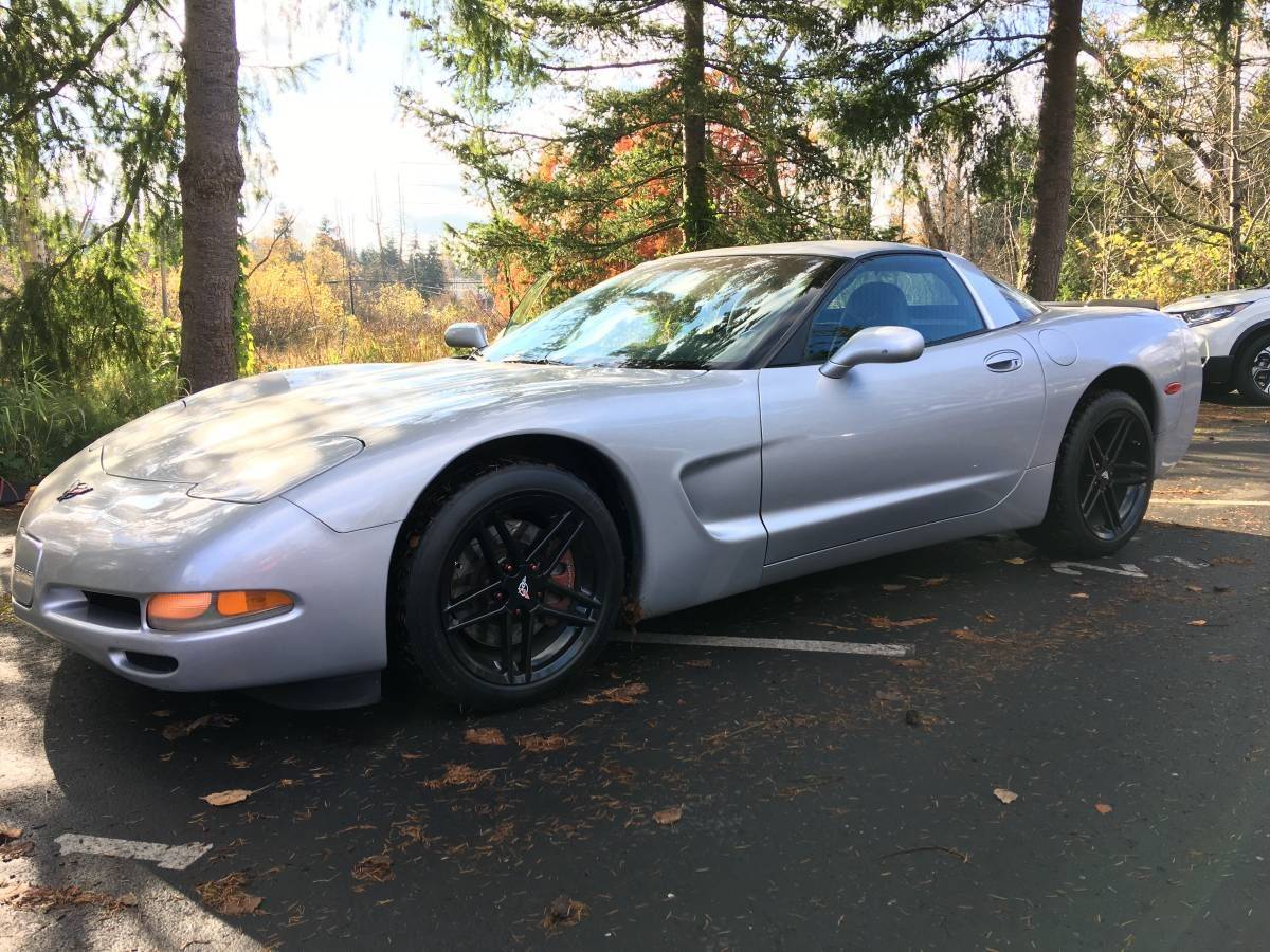

Slowly fixing things on my C5 Base that I bought a year ago and the one thing in the handling department that I would like to fix is a certain feeling inside the car on acceleration around corners and sometimes just on hard acceleration. The car feels like the rear end of the car is sliding sideways on the chassis/suspension, not body roll such as sway bars limit but more horizontal shift. I am wondering if it is due to mono leaf springs? My built 47 Chevy has the same issue and it is a leaf spring car. My Porsche 944 Turbo does not have the issue, but it has a trailing arm with torsion bar set up and it feels like you are on rails with no issues at all in the cornering department.
A bit of information, my 97 C5 has C6 Z06 shocks and sway bars, the car was high, so I lowered it as far as I could on stock bolts while keeping it even on all four corners and I still have the issue. Just about everything in the chasis and body were replaced/upgraded before I bought it so it seemed like a good base to start from. Upgraded the tunnel plate (Elite Engineering 3/8”) and the engine / transmission mounts are solid mounts. I have taken care of most of the quirky items and put in a rebuilt BCM, etc. just a couple quirks left.
Not certain if getting Z06 mono springs would cure this or if there is a brace or something to improve it, maybe I am extremely picky and it isn't hurting anything, but it actually makes me feel like letting off the gas because it doesn't feel like it is tracking straight. In any event, I tried searching for the topic, but probably didn't know the correct phrases to use and thought maybe someone here would have information and even a solution. I am not certain if a transaxle brace of some sort is the solution.
Having a blast with the car, just trying to fix all the small things with it, top on my agenda is a leaky top where targa corners intercept windshield, eliminated leaks at back corners already, once these little items are done I will be doing a cam, heads and intake upgrade, have the parts, just not dumping the money in if I can't get all the quirks taken care of.
Any information or solutions on this would be appreciated, as I typed this it did come to mind that I may have never paid attention to this item with traction control turned off in case it is the tranction control causing it, I doubt it but maybe. Anyway I was wondering if there is a brace or if spring upgrade is the answer, or what the issue could be.
Thanks in advance for your time.
Russell

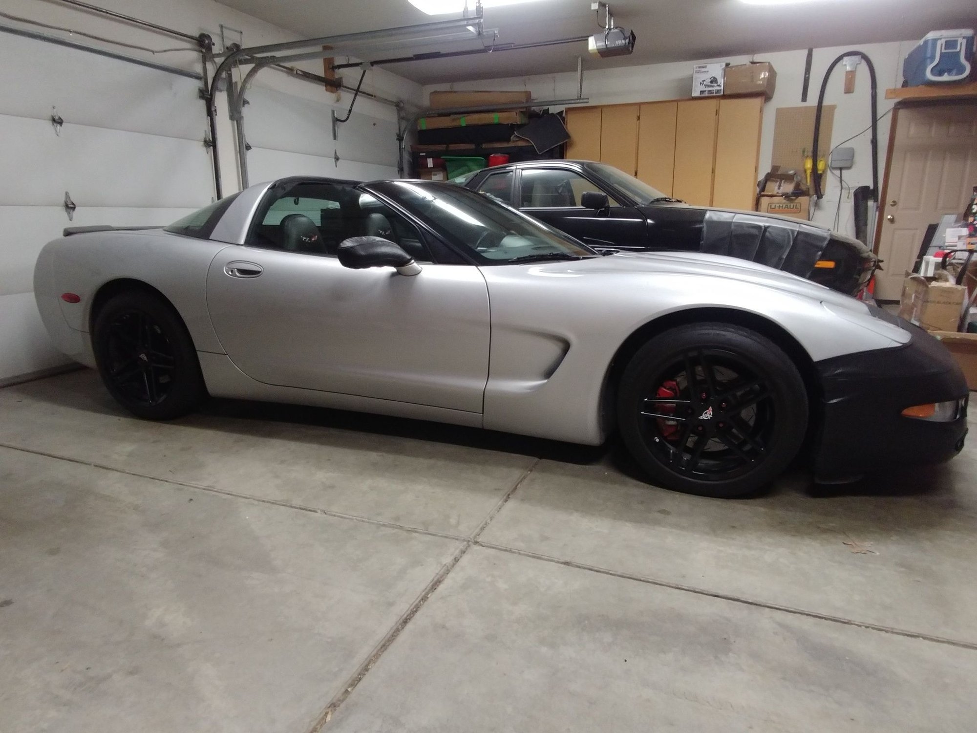

I need to get under there and look for something loose, worn out or broken between rear end and frame/body as that is what I am sensing/feeling a shift and not alignment. However, I don't assume I am right, one time I thought an automatic transmission had issues in a car and it turned out that the coil for one cylinder was going out! LOL So what it feels like isn't always what it is, so everyone's input and observations are very welcome. I try not to be that guy who only hears what he wants to hear.

Interesting, I am around 4 3/4" and 5 1/4" from bottom of body to grade, and my wheels are centered pretty nicely in the wheel wells, Yet I think something is amis! LOL Maybe I need to raise it at least a 1/4".....
