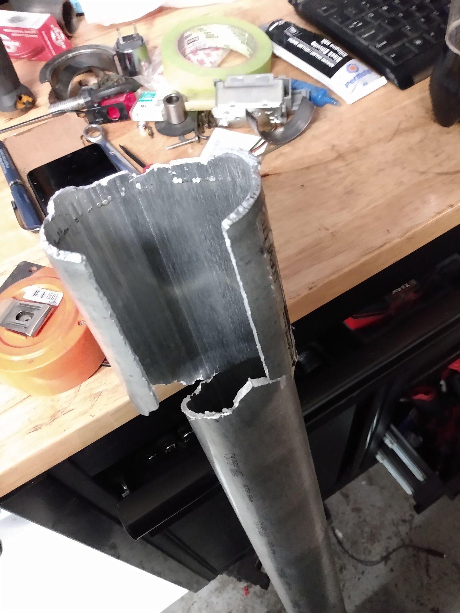

A4 auto with billet couplers.
Idling on jack stands doing some idle tuning on new engine.
Converter seems to spin free.
Any ideas. This is the front of shaft.

Thats got to be a first, never seen one damaged that way. Where's the flange the coupler bolts to?

Wow. And with no load.
still in torque tube will pull later

22 thou run out on section that broke. back to rubber couplers lol

Do you think the solid couplers caused the failure?
