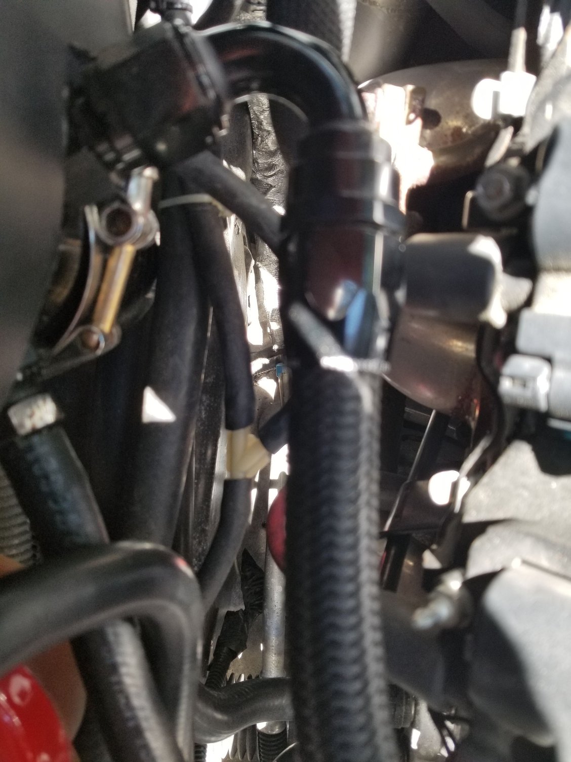

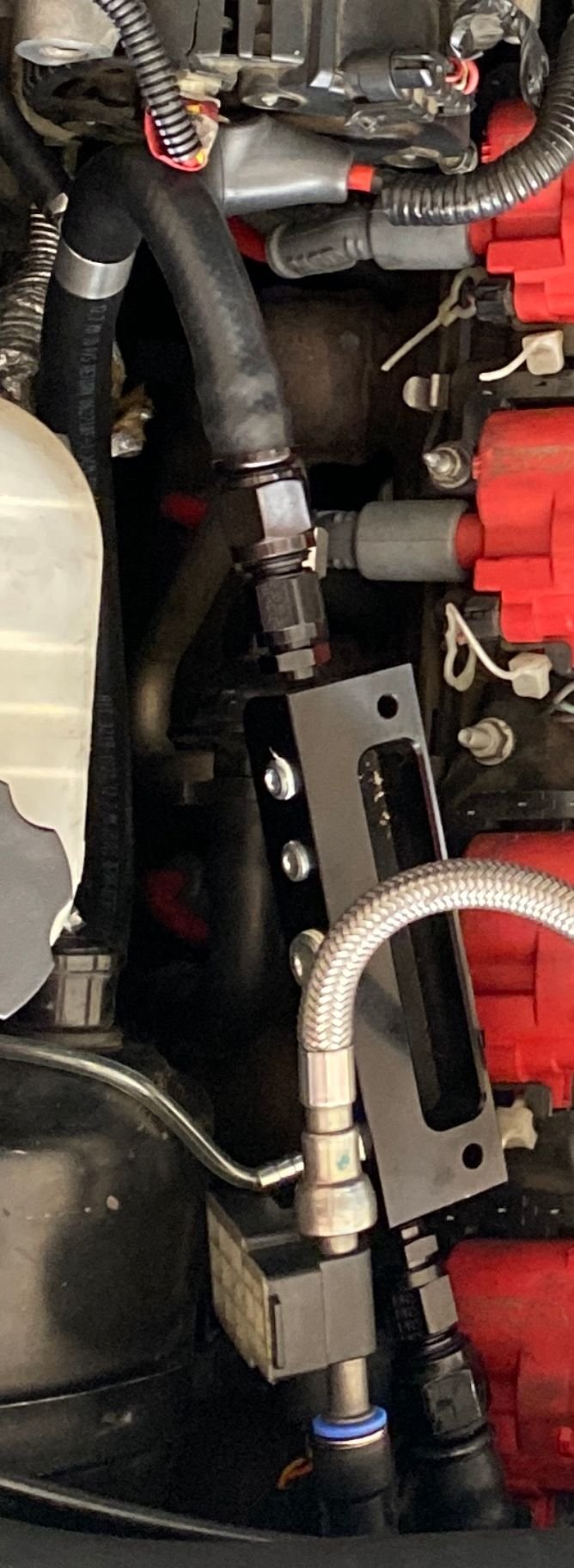

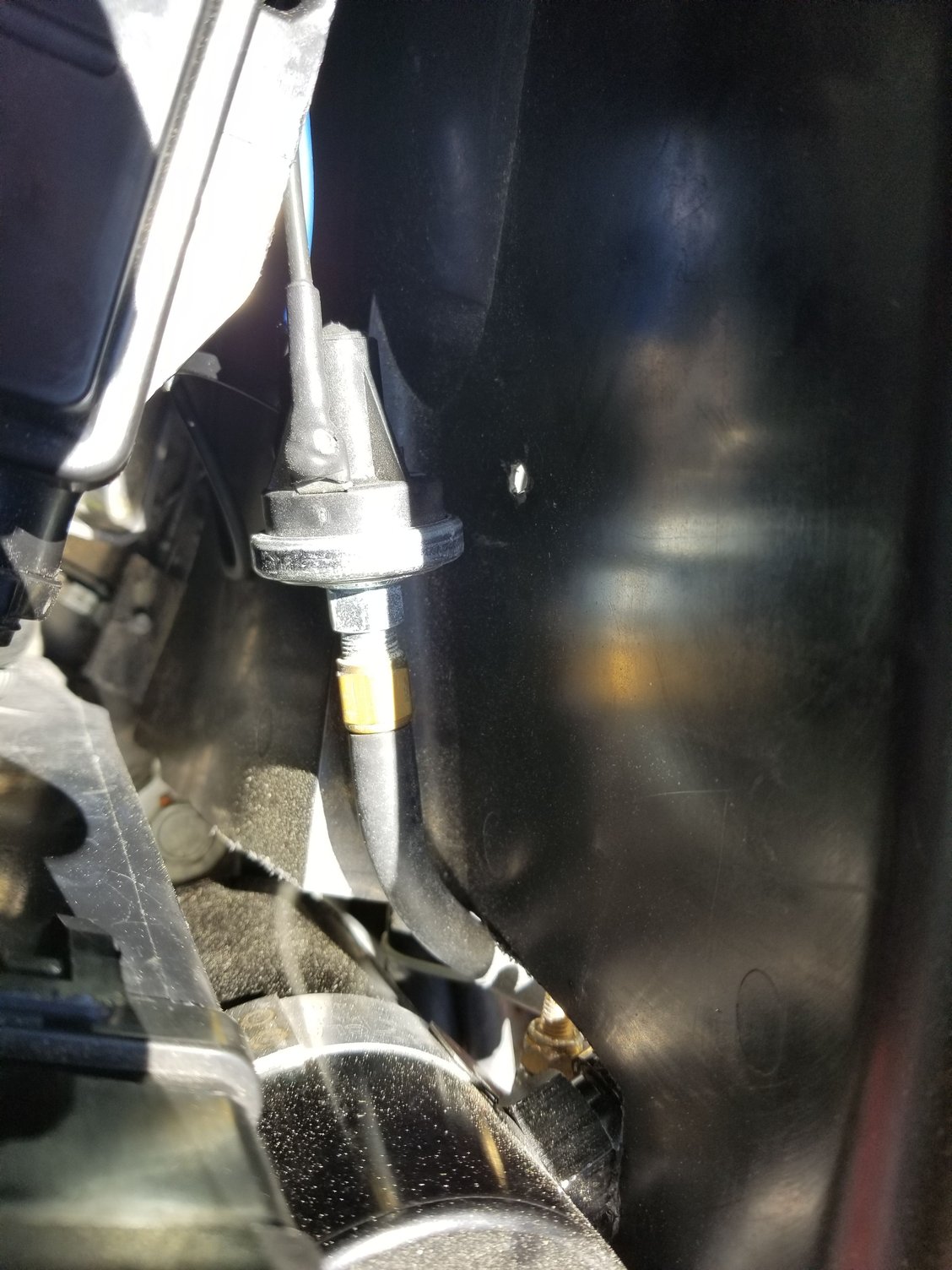

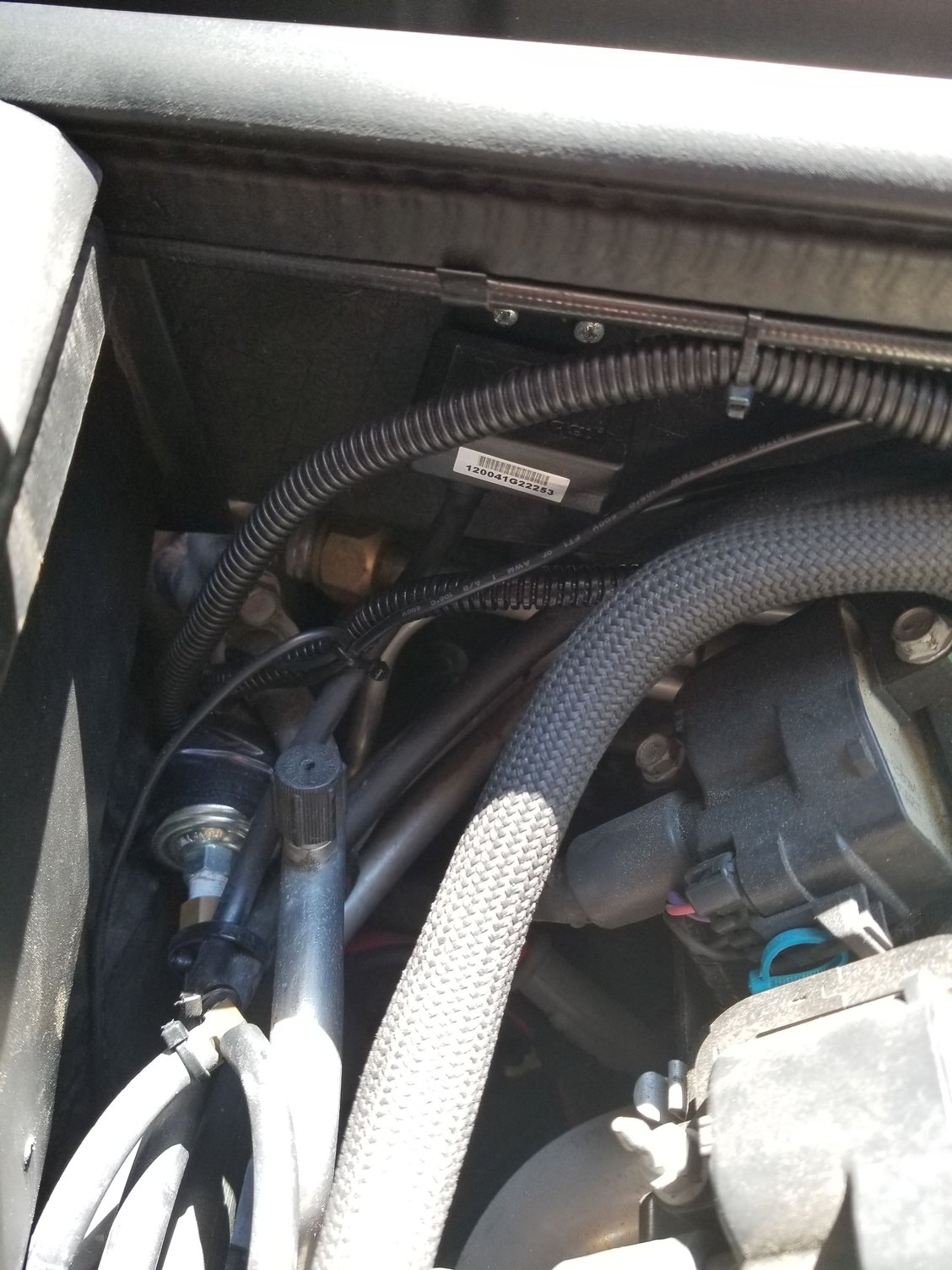

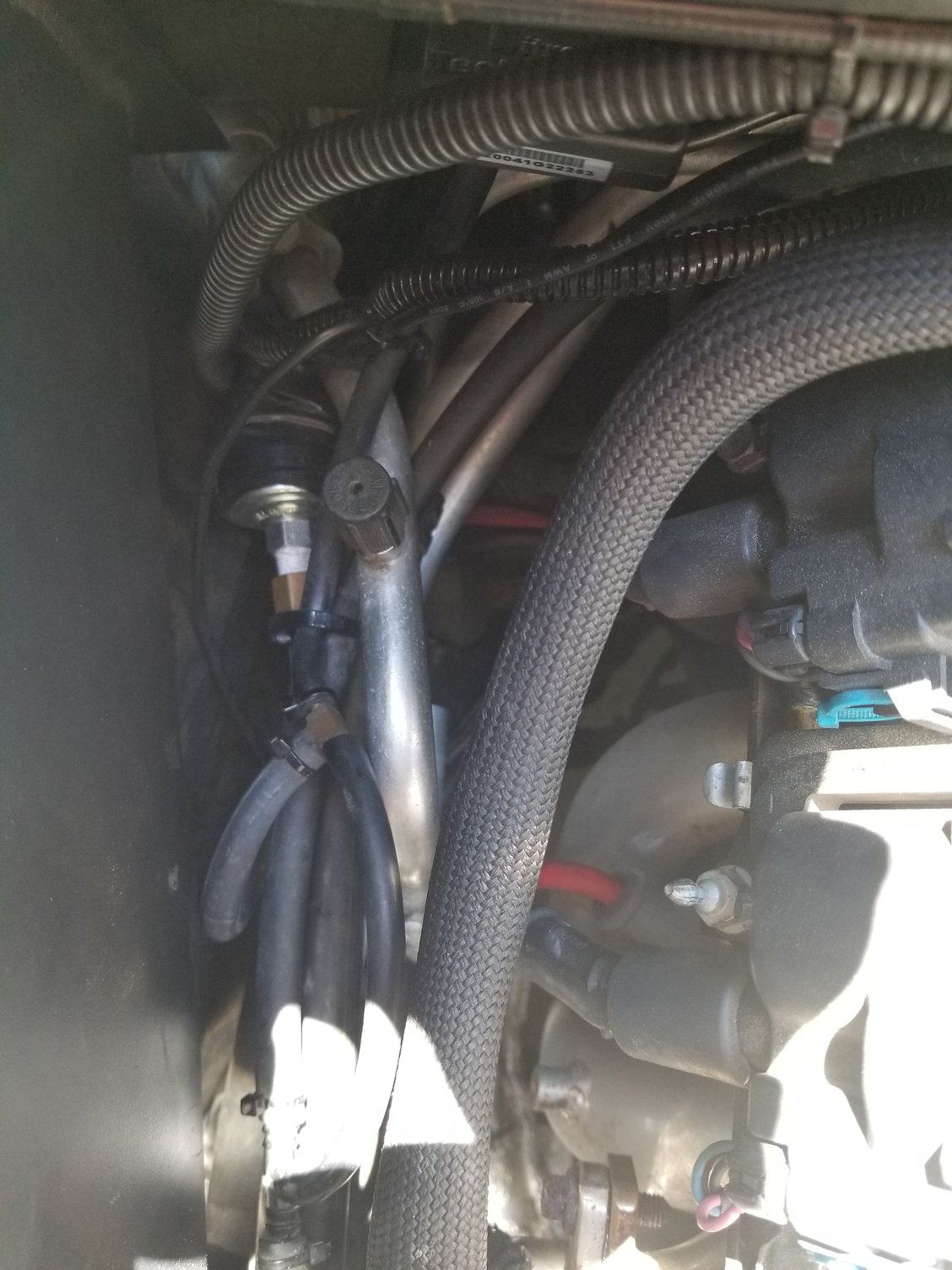

Kind of hard to see but basically. There is a main hose that is tee'd off the brake master. That is then tee'd off to the fuel pressure regulator and it goes across the cowl to the map sensor for the boost gauge and then is tee'd and y'd into what looks like a hobbs switch (the silver disk looking thing there are two of them) and then that big line heads down under the headlight on the passenger side to what I can only assume is down to the BOV.

it could be cleaned up that's for sure, a vacuum block would be a good idea that way the only tap is in the booster line and you can feed everything else on it's own dedicated vacuum line... check to make sure those zip ties aren't too tight and restricting flow and double check the wiring to make sure the connections are solid and make sure you have a good ground... if all that checks out maybe the gauge is bad

I can’t see from the pictures what tied into what . But Let me give ya some actual help.
